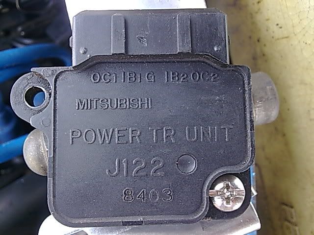

Cheack your POWER TR UNIT.....

Quoting 988:
Not likely.. it would drop down to 2 cylinders or just not run at all.
