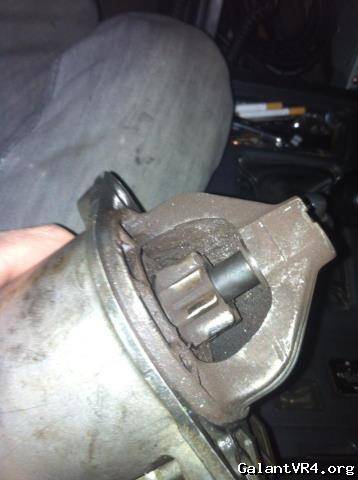

when i turn the key to start the motor dosent sound too good, i hear 2-3 hard clunking sounds coming from the starter it sounds like. i checked my starter bolts and their on there nice and tight, the starter dosent jiggle at all its on there pretty good, dose this sound like my starter is starting to go bad or could i possibly have a missing tooth on the starter??? any help would be great.
so i changed my starter and the teeth on the starter were worn and all shiny where the flywheel connects to the starers teeth. when i went to start my galant it starter a little smoother then befor but im still hearing this bad noise sounds like my flywheel or somthing..... i need help and opinions on what i should do...

here what my starter looked like i put in a new one and still makes the noise, i havent looked at the flywheel yet, but i just picked up a used OEM Flywheel, i dont have an inspection plate on my trans so im going to look at the flywheel aanother day, and the noise just came out of nowhere one day it was fine then one day i heard the noise and now it makes the same noise every time i start my car...
