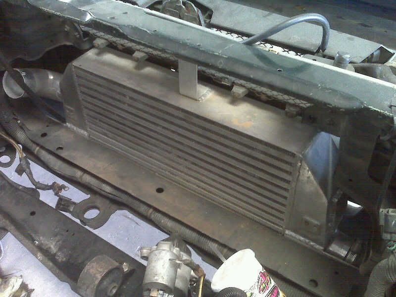

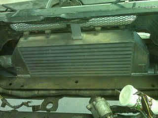

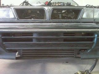

Ted
her are some pics of my ebay evo fmic.

yea i changed the inlets on the ic, no i dont have fog lights
so i dont know it if they can still be used.
Careful with the SSAutochrome stuff. One of the local Richmond guys blew the endtanks/welds apart several times at less than 20psi. Some people have luck with them, some don't. Once you pay a guy with a TIG welder to fix your IC a few times, it may not be such a bargain after all.
If you have doubts, Google SSAutochrome, and read the eleventy-billion references to shady advertising, lack of R&D, fitment issues, and general lack of reliability.
