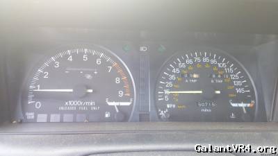

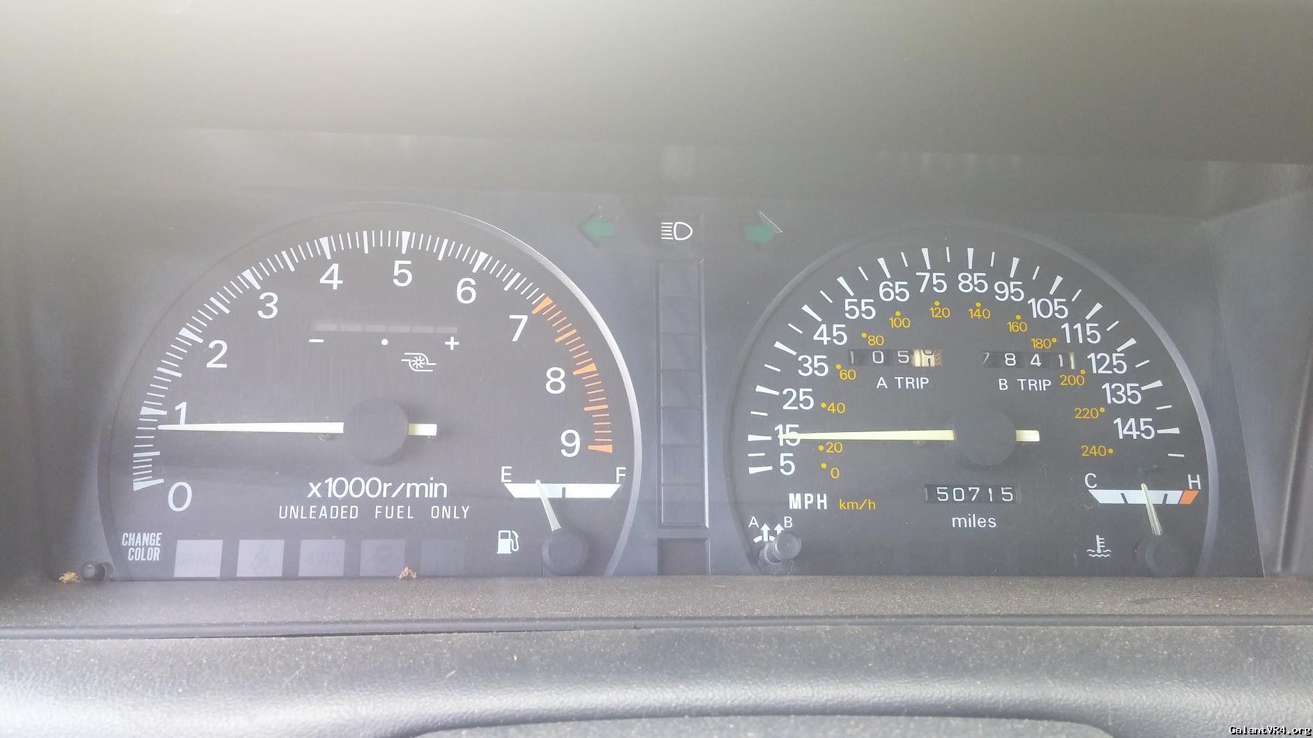

Just a followup to this topic. I finally got around to installing A gvr4 speedo gear that I got. When I took the current one out it had a 29tooth gear and the gvr4 one I had had a 30tooth gear. Swapped them out and now my speedo is off by +12 now so it made it worse. I guess I should have figured since the teeth went +1 it would spin slower.
Anyway I noticed my speedo needle settles on the 15mph mark. Is this normal? Maybe I should open it up and move the needle to the 5mph mark.
FlyingEagle
Mar 5, 2005
1,636
THE Ottawa
Never seen a speedo that doesn't sit at the needle when it should be at rest, unless something is amiss or someone had the gauge face/needle off for some reason and they goofed at reinstalling the needle. The needle should sit lower at rest as it only moves up when the reed switch is activated and the cable in the back of the cluster is actually spinning.
