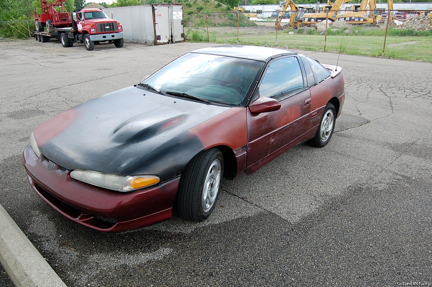

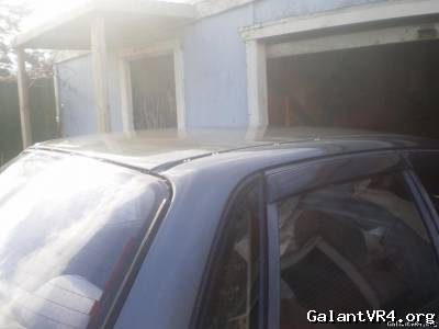

Has anyone tried this on a galant? My paint is to the point where anything would look better. My car has a lot of dings that need fixing, the roof has clearcoat pealing, one of my sideskirts is cracked, my trunklid looks like it was keyed at one point in time. I'm thinking I can't make it any worse. I'm thinking either gloss black or satin black.
click
Not sure what I would do about that chrome molding around the car.

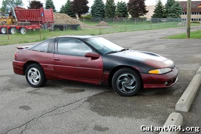

The car:

I think that link shows a guy that rolled it on.
I mean if you want to try it go for it, its your car.

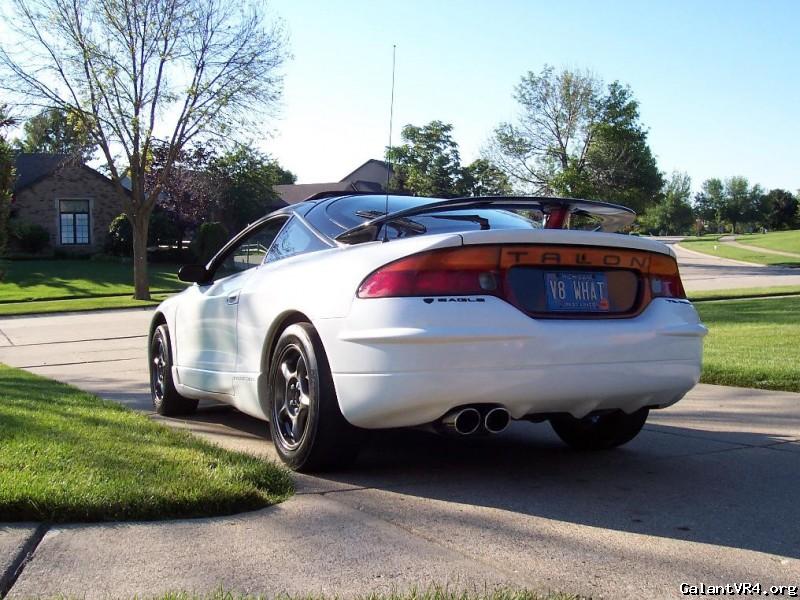

Well I know how to paint. I have all the tools to do it right. I just know it's a lot of work and seeing as this is just supposed to be a daily driver I don't want to spend $500ish on primer/sealer/paint/clearcoat and have a ton of hours into it. Here's the 3000gt I painted, more pics from start to finish here:
click

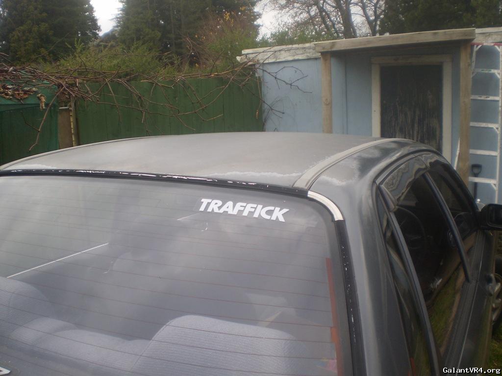

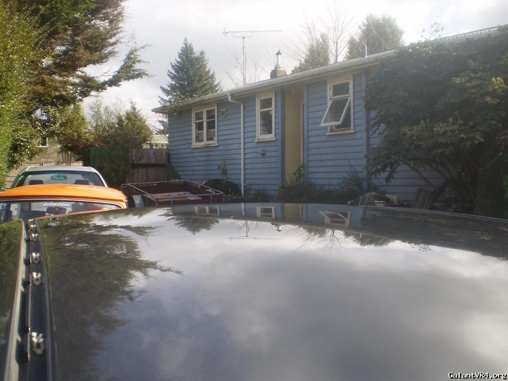

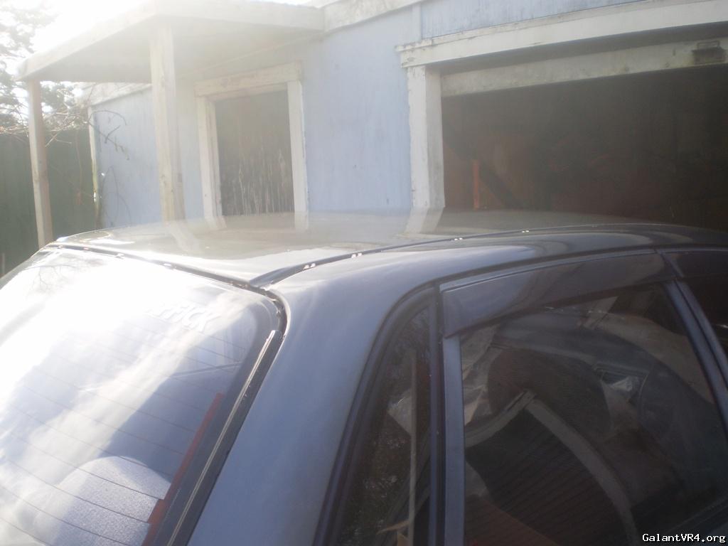

FastFalcon94, I'm sure if you fix the clear and polish the car it won't look so bad. Here is a car that I fixed realy bad clear coat peel on before and after pics.
The trick realy is just treat the aerosol the same as any regular cun, use the same spraying technique etc and just adjust your style for the narrow fan.

I can see that it is a bit rough in the photos, but you'd be supprised how much better it could be with a cuting polish, just mix the polish with water. Then you could take care of the peeling clear like I did. You could get a paint shop to mix you a little color matched to your car and just pencil touch the real bad bits like if you get your skirt plastic welded.

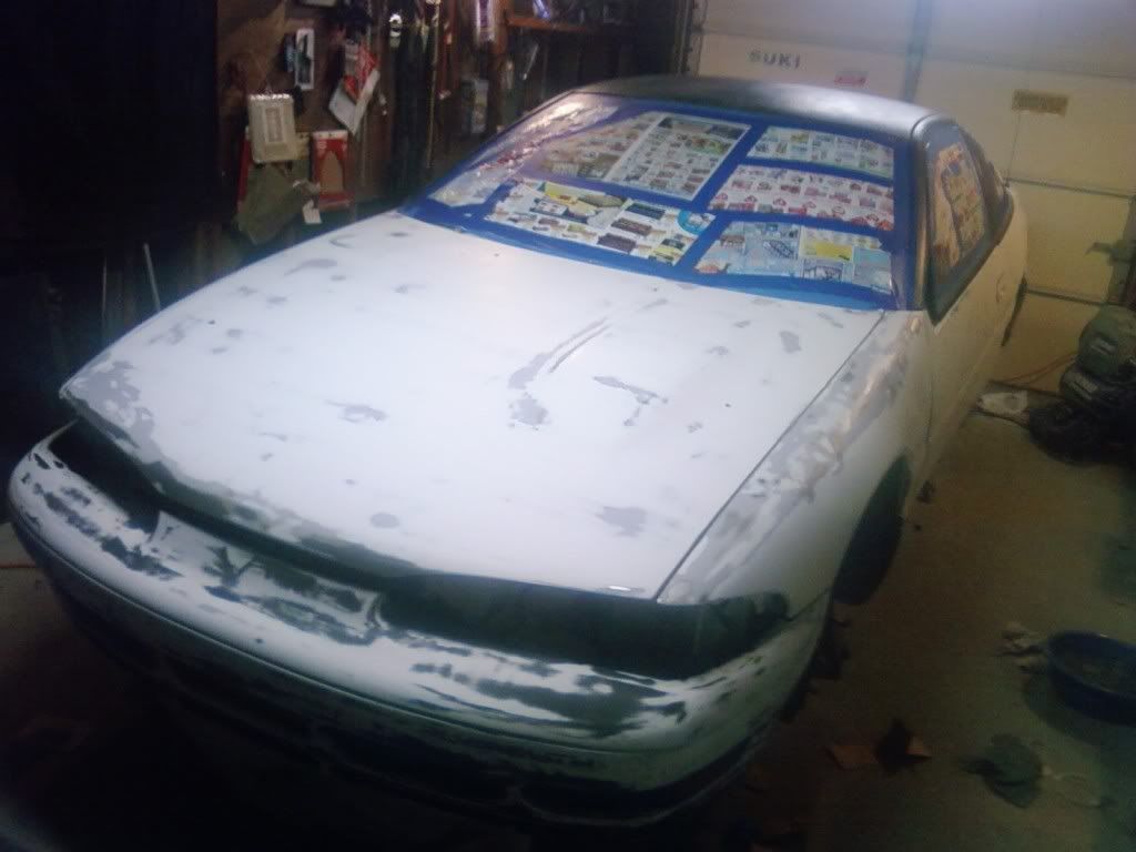

Well I sanded down most of the hood today, filled in a few dings it had too. The front under edge of it was rusty so I sandblasted that and cleaned it up. I think I'm going to try the roller method on just the hood first. A gallon of the rustoleum paint is $36 at Lowes. I pulled off the chrome trim piece on the front bumper too. I think I'm going to just fiberglass the gap and get rid of the trim piece completely. Does anyone know how to remove the trim pieces on the roof? I'd like to at least move those before painting. I'll paint everything with the door caps, spoiler, front/rear bumper off the car. I may even foam brush the door jams too.

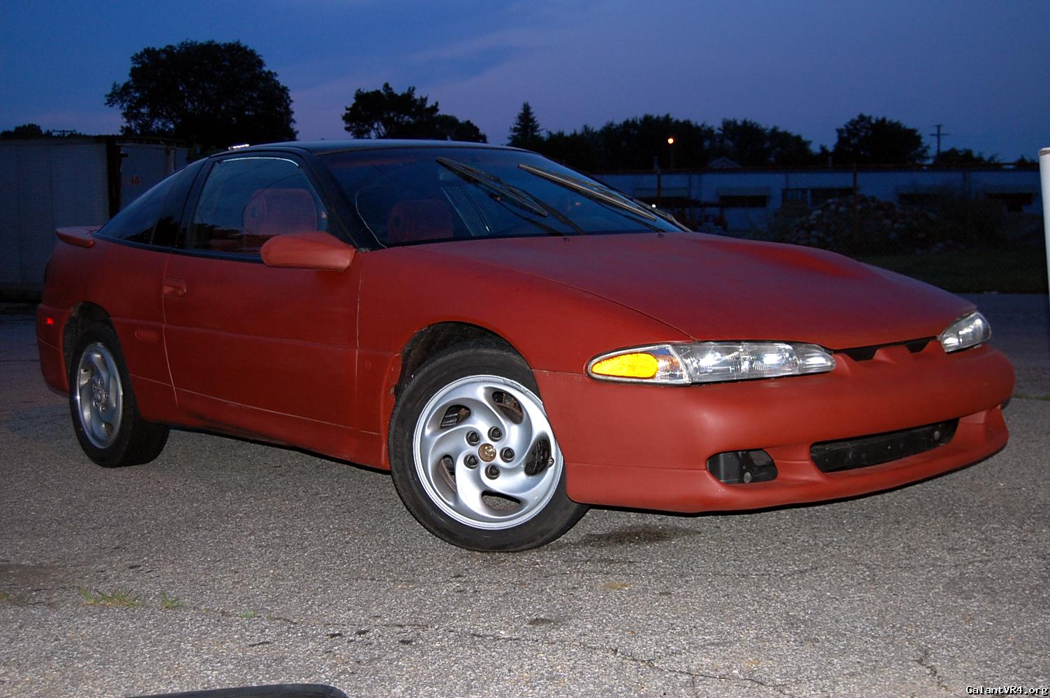

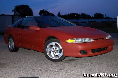

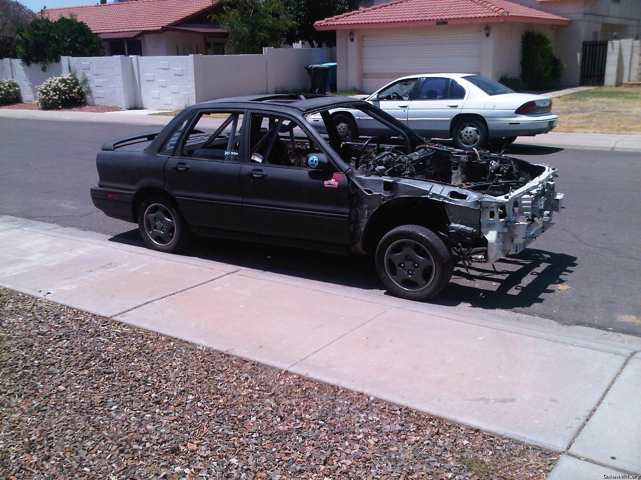

195/2000 has a Rustoleum rattle can job. Done back in 2008, the car hasn't seen much street time since (less than 200 miles, actually), but it's held up fairly decently. These pictures were taken in June of this year.
Rolled it out on the street so I could work on 464 in the garage.
There was a lot of bare metal exposed under the fenders, so I shot it with the same paint (from the same cans, even) from 2008. You can see how it compares to the doors, which have been painted for about three years.
Interior of the engine bay will be white, by the way. Easier to spot leaks.

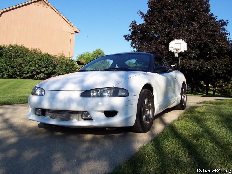

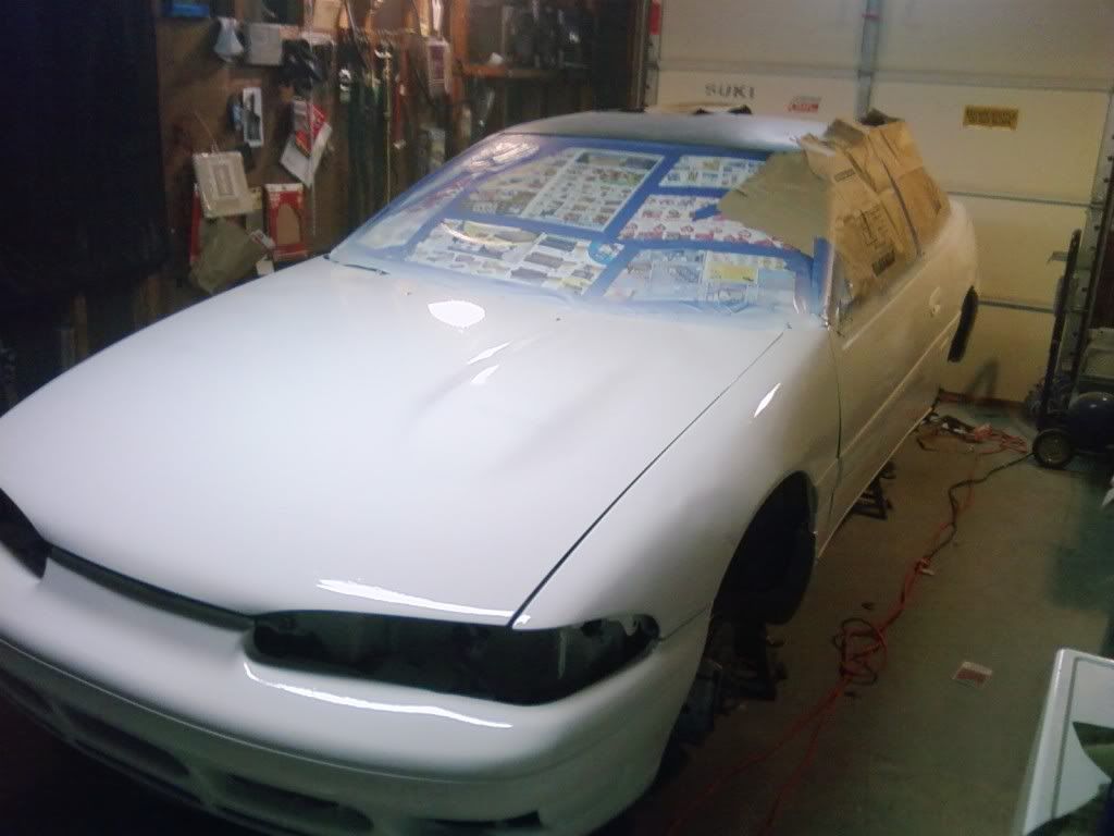

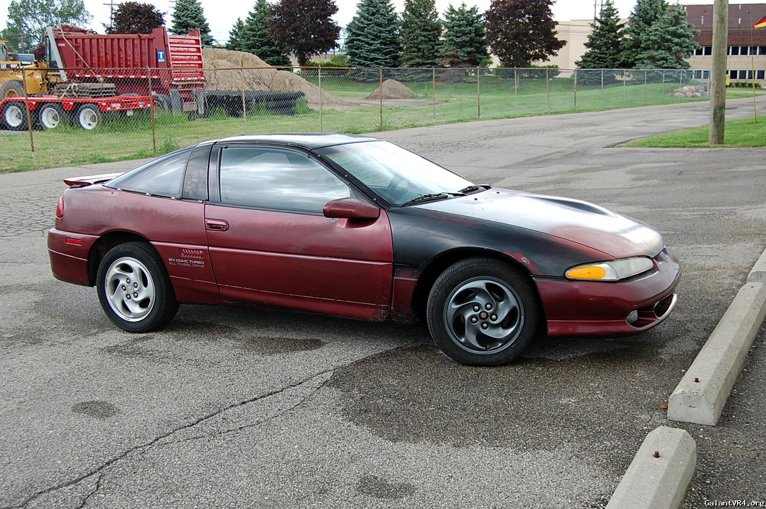

Here's MY $50 paint job. I'm pretty good with a spray can so I went that route. I think I used about 12 cans. Before it was embarrassing driving the car, now it atleast looks normal. The actual painting part is probably 5% of the job. The trick is getting the body as straight and smooth as possible, pop off all trim, lights, bumpers, etc etc. I would do 1 panel/section at a time, and wetsand it about 30 min after spraying. The problem with most spray paint jobs is the paint is uneven and blotchy. Wet sanding and using enough paint cures that.
I'll also add that if you do go the route of spray can, don't feel you have to go with the expensive stuff. I bought 5 cans of different brand white at my local store and test sprayed to find the closest match color for my 2g. Turns out the closest match was 1.09usd/can.
If you can't tell which panels are spray painted, I won't either. /ubbthreads/images/graemlins/wink.gif

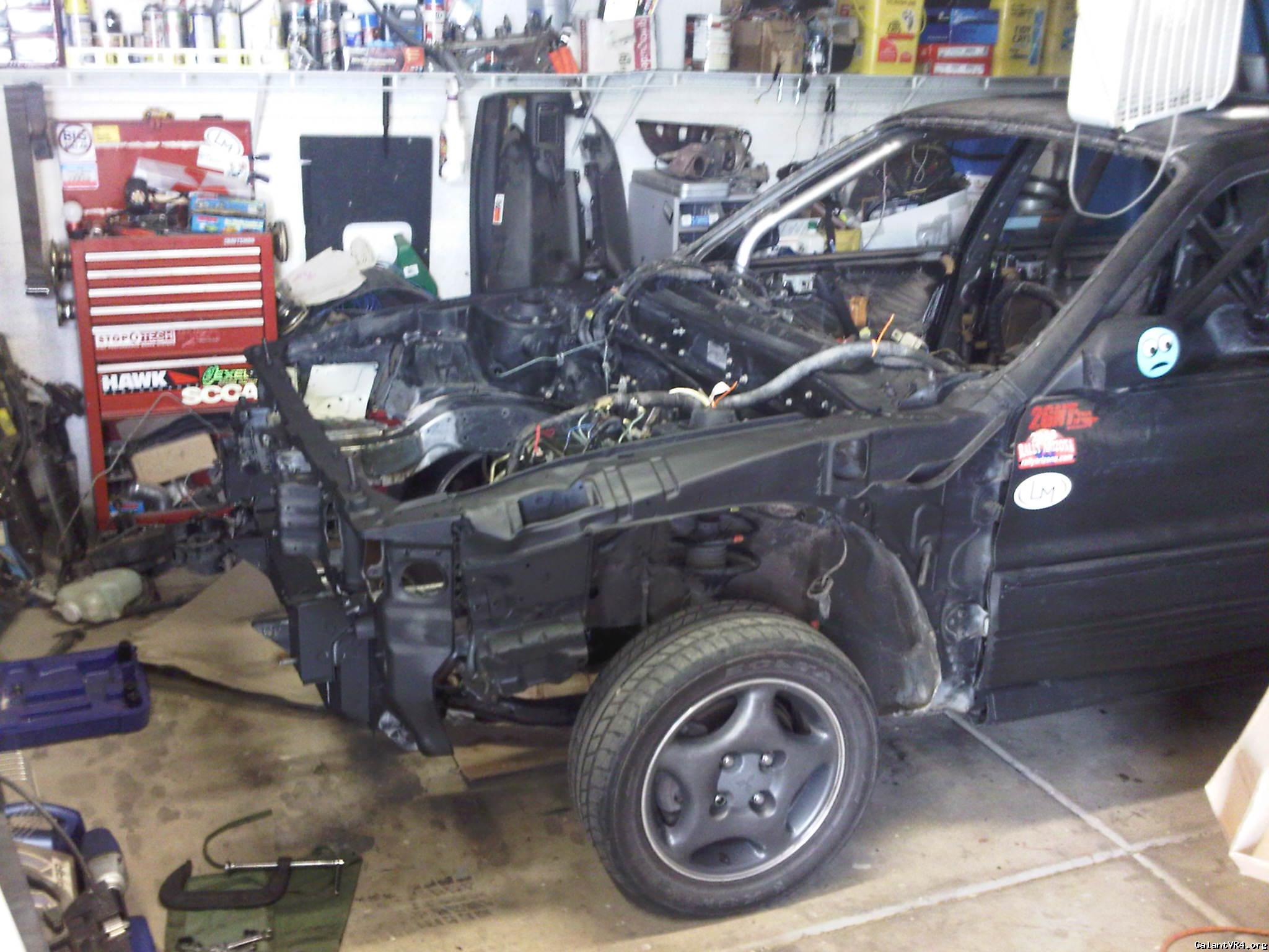

Yeah white is a pretty forgiving color. I had some time this morning to start working on it. Ended up pulling the bumpers, sideskirts, door panels, door trim, window trim, door handles, roof trim, fenders, tail lights, spoiler, hood etc.. I also sandblasted a few things. I had some rust starting to appear under the front of the hood.
All I can say is WOW at how heavy the rear bumper is. The thing must weight 70+ pounds. I'm going to have some fun with my plasma cutter. I'm going to prep it all for paint this week, possibly even tomorrow. Filling in where the chrome molding was is going to take some time. I may spray the rustoleum instead of rolling it but who knows. I'd rather roll it to keep the over spray down. I may try a panel first to see how it goes.

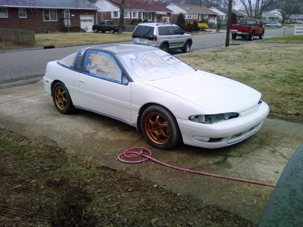

Boost4U
Jun 25, 2011
133
Hampton, VA
Before
After
But don't get too excited, as somebody else said, white is a forgive color and it looks a lot better in pictures than in person. I spray the car with Rustoleum oil based paint mixed with mineral spirits. If I were to do it again, I would have prepped it and taken it to Maaco.
