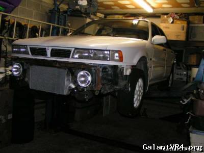

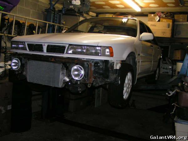

I have the evo 8/9 FMIC, but I have an evo III bumper. Here is a pic without the bumper, I built a new crash.

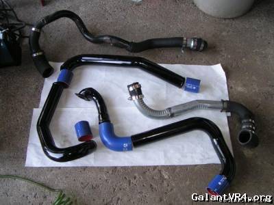

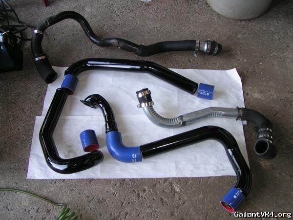

And here is the piping I made (The one with blue coupling, the other one was my temporary one)
