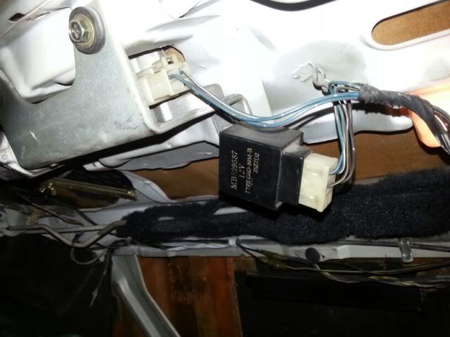

My rear wiper does not stop at the home after the off button, has caused a relay that is not working? can anyone tell me can I use any type of relay to replace the relay /ubbthreads/images/graemlins/dunno.gifThanks..

I would say it would be the self-park switch inside the wiper motor at fault, or the circuit from the wiper motor to the wiper relay. You could try replacing the relay first as I would imagine it would be easier/cheaper than replacing the rear wiper motor.

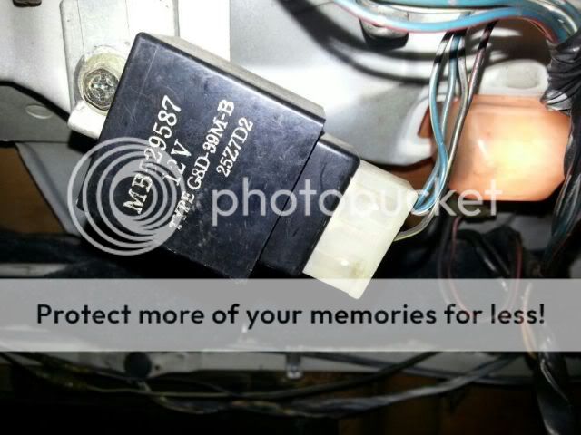

Ary.... must uses Vr4 relay... evo is different, will stop right side... please refer this pic

The best solution I have tried, where I can easily get the VR-4 relay? because some part VR-4 is quite difficult to realize.
