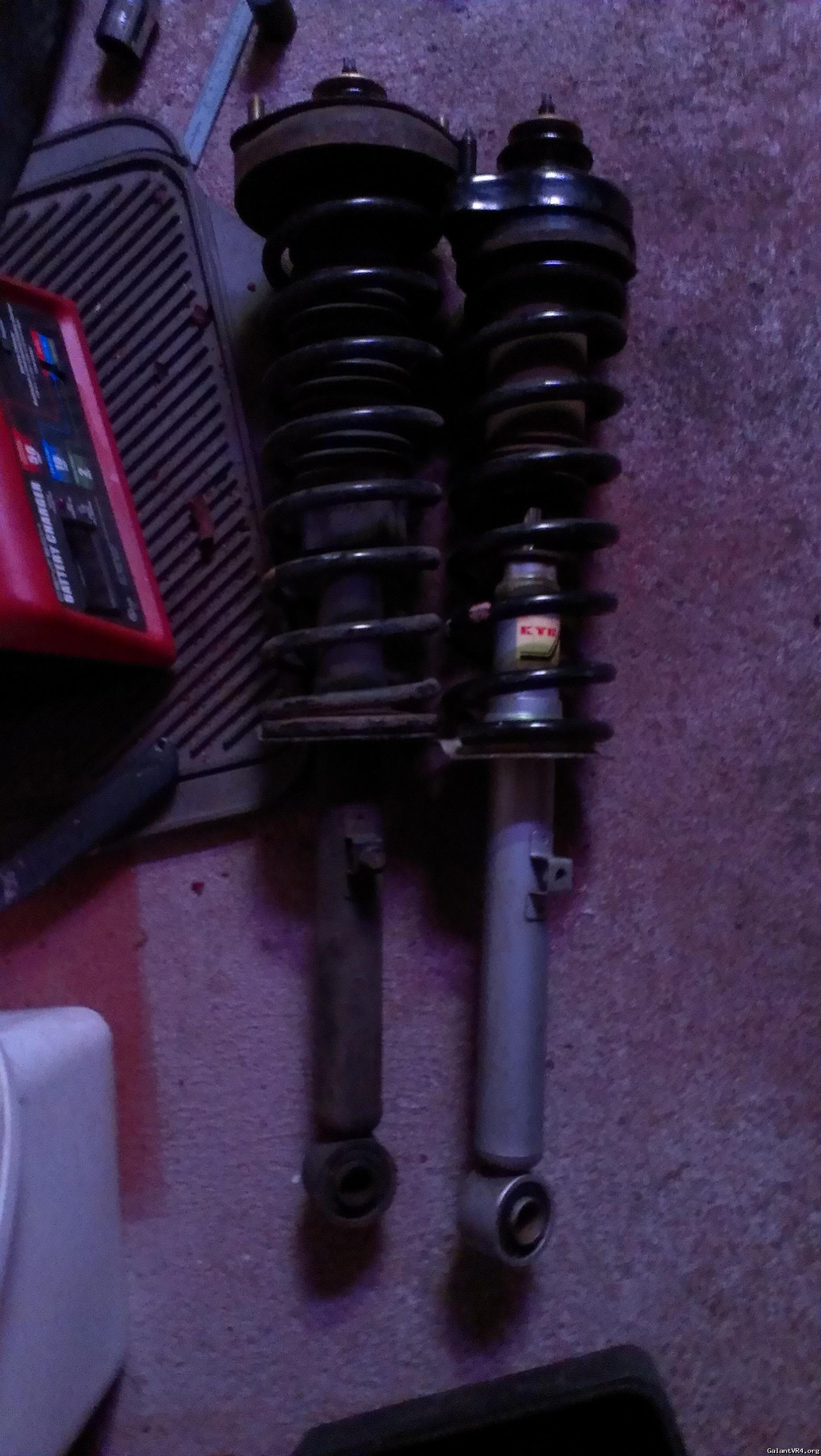

The piece all the way on the left.
getimage.php
This is the piece I'm wondering if it will be different or not. It fits inside the cup at the top.
Edit after looking at pics and part numbers it doesnt look like I can get away with just the rubber seat. The whole metal cup it sits in is much smaller on the evo.
