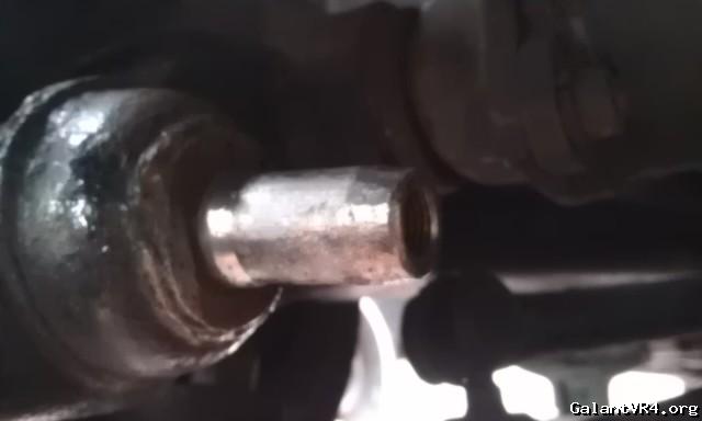

^ That'd be my guess as well. I had what seems to be the same problem when removing my AGX's to install some BC's. The rear lower mount's inner collar separated from the rubber bushing, and some nasty corrosion meant it wasn't coming off without a fight. Eventually i got it off.
Cleaned up the spindle.

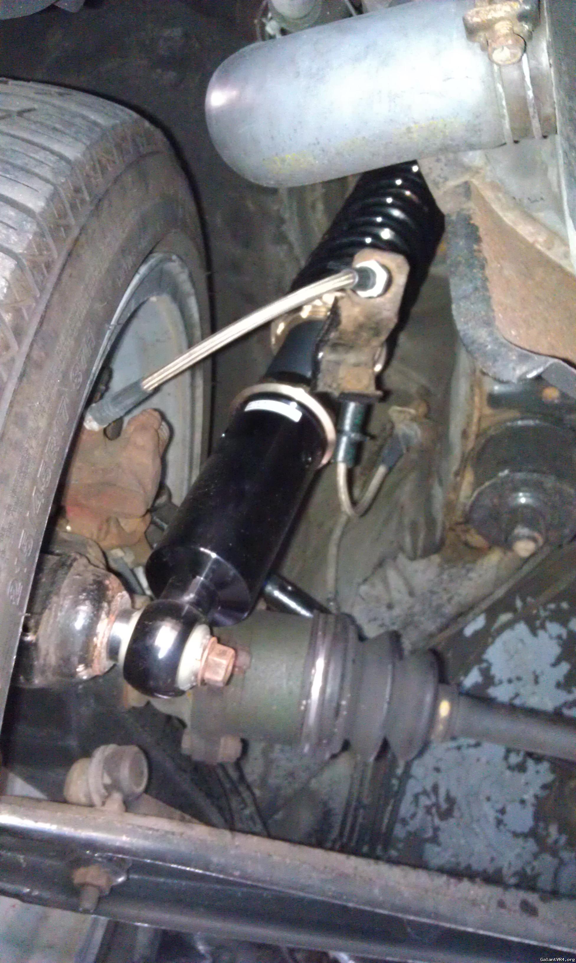

And installed the new rear shock.

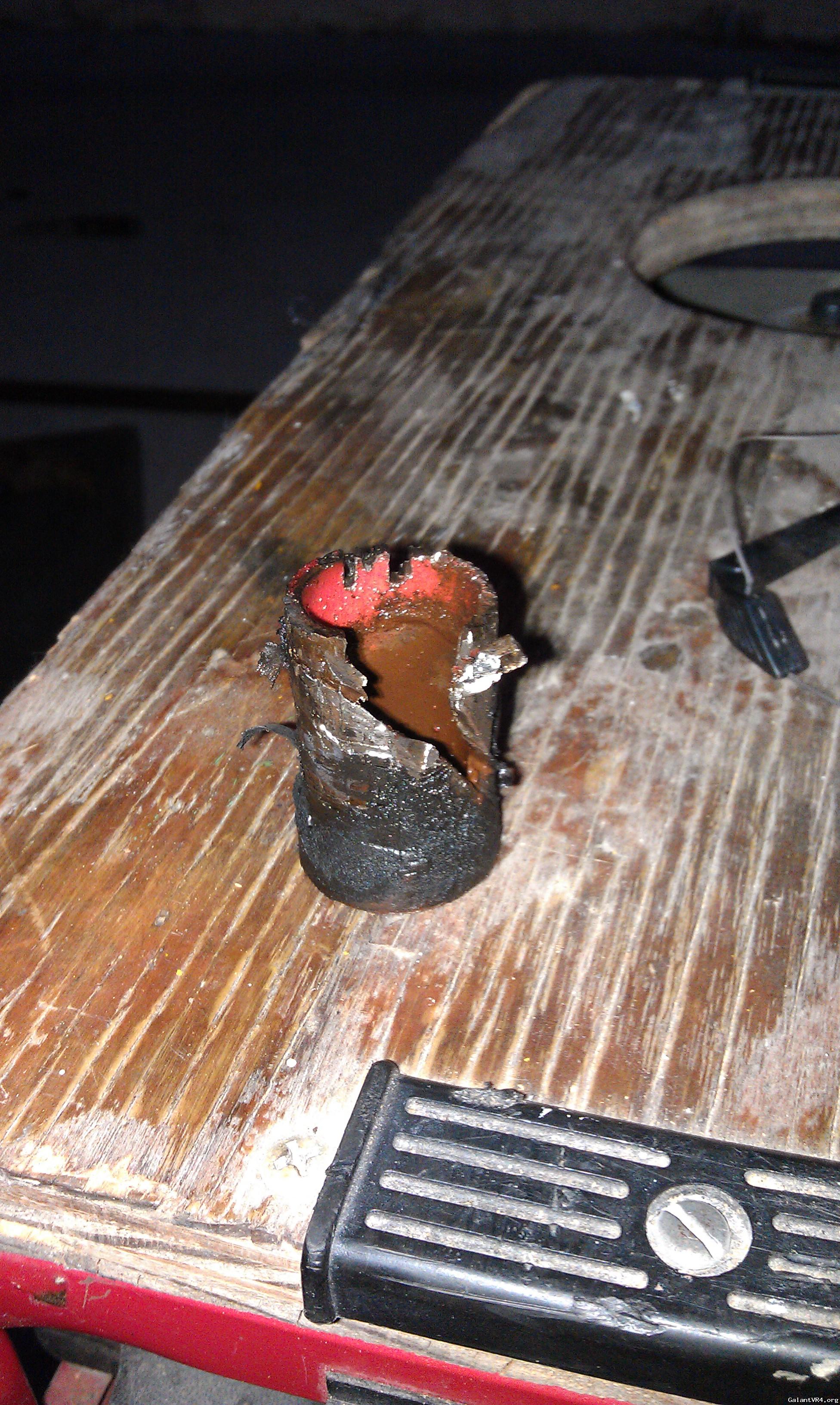

I went at it with MAP gas torch, SOB wouldn't budge. I ended up having to cut it and then pry it open like a clam shell, then was able to twist off.
