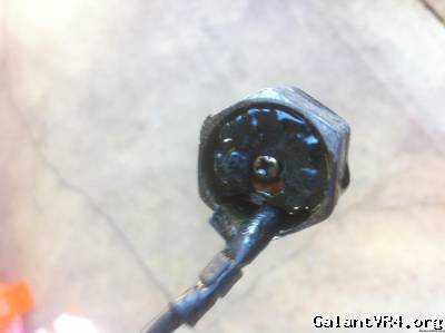

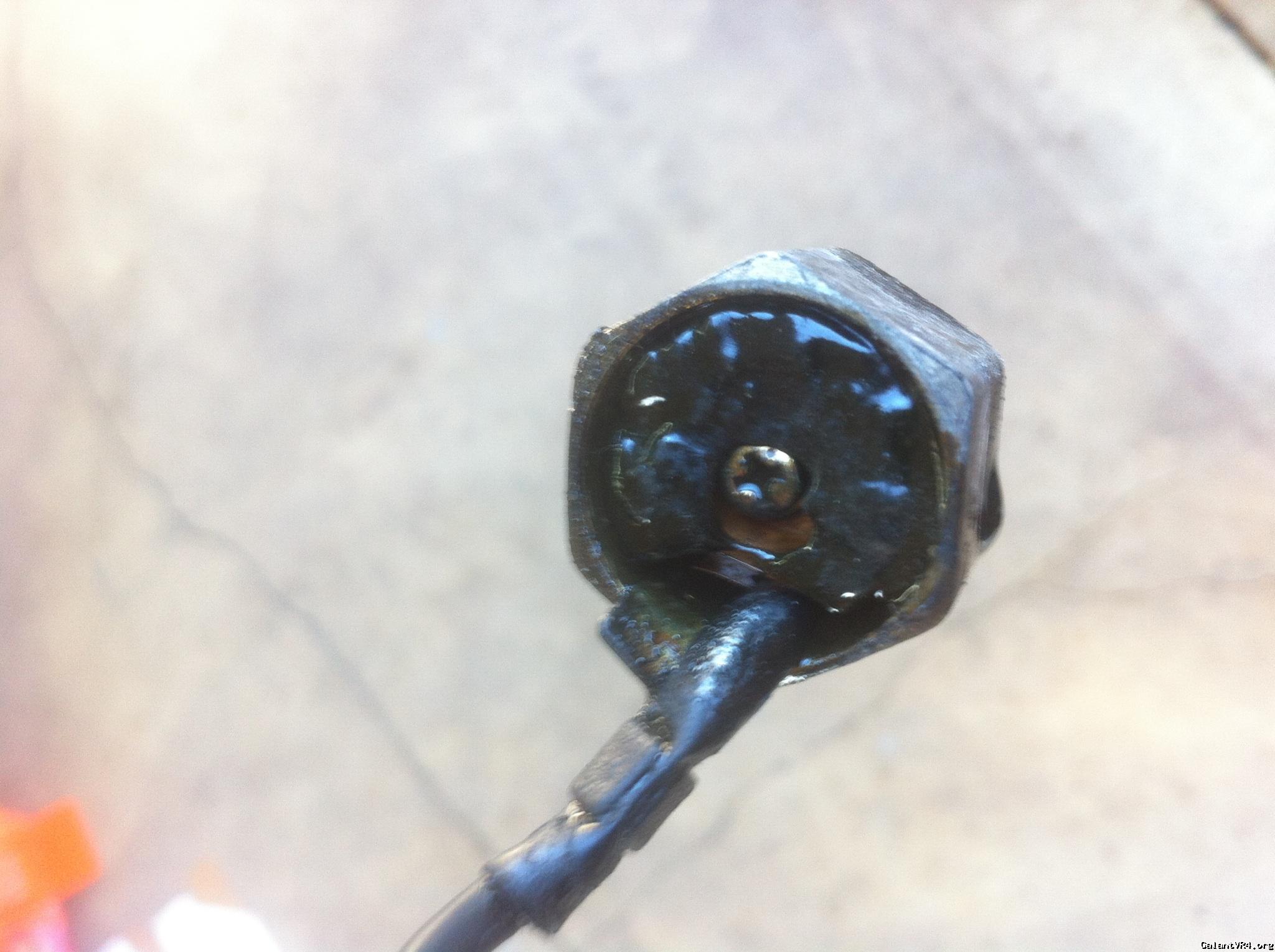

Here's the knock sensor that Evan pulled out of my car when we yanked the old motor out. Usually the goop runs, but on mine, it ran out sufficiently to expose the sensor itself.
no good!
Tricky to get to, but if you are going to pull the TB off the intake mani to check for leaks, then you should be able to get to it without too much knuckle-bashing.
