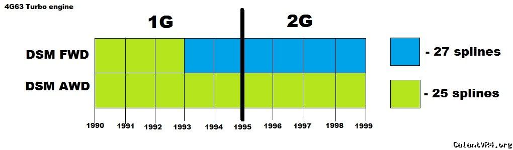

My Colts KM210 FWD transmission uses 25 spline passenger side (intermediate shaft) and 25 spline driver side axles, so I need to install a 25 spline Quaife to match my axles.
Quaife sells two models of Quaife for FWD Mitsu tranmissions:
The QDH8B has 25 teeth and QDH7B has 27.
So, a QDH8B fits a KM210 and Jack's says I need this Quaife to fit the trans code I gave them (KF5M33 2SPZV). I assume Jacks meant the QDH7B 27 spline. Read quote below:

Quaife Front Differential for 92-99 FWD DSM / 3S FWD ONLY
This Quaife is designed to work in the FWD Turbo DSM's and also the FWD NA 3000GT / Stealth
This one is designed for the 92+ DSM transmissions. You will need to upgrade the front axles in order to use this Quaife, but it is the only option available for your transmission.

Good news, this "92" transmission just had a set of Colt/Mirage turbo 25 spline axles plugged into it. So, the center welded diff is a 25 spline unit.
Final question will be if this Quaife,
Quote:
Mitsubishi Eclipse/Talon 4x4 90-99(front) QDH8B
will fit into this transmission case,
Quote:
F5M33-2-SPZV
in any way possible.

I had this Quaife diff installed into the above 5 speed F5M33 FWD transaxle and it is totally compatible with the stock 25 spline axles (Quaife AWD option with splines holes to accept 25 spline count axles).
A couple of ball and cage style bearings versus tapered, and a reputable shop to size up the shims on the bottom side of the diff before installing the lower case half bearing (important) to allow the diff gears to mate flush, and load the case per the torque/HP ratings and or useage it will see. The list for that is on the site because that is where I got it. Probably archived/Library.
So, if you have 25 spline axles on your Galant, this should work in your AWD Galant trans as well.
