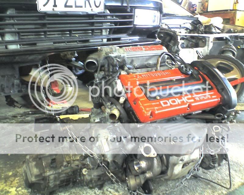

OUt the bottom. always, can do it on your lonesome, don't need to pull the bonnet off. Also was how MMC assembled the car! I'll find a pic or two of mine with the motor on the move.
