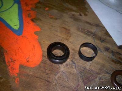

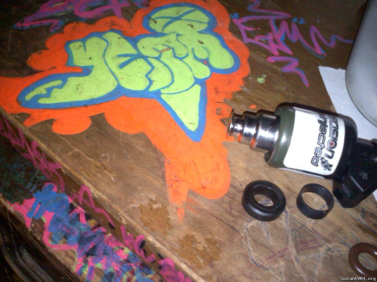

i installed my 1000cc pte's and i did a boost leak test and cannot even build 1 psi because all of the air is rushing out of my injector seals. i can literally see that being to small compared to the stock seals.
should i drill out the middle of the stock seals so they will fit on the 1000cc because right now the inside diameter is to small.???
here is some pics
the seals on the left is from the stock injectors the thin piece of plastic is from the 1000cc injectors...... any suggestions?

Probably have to have grind down since it worked for that guy.
Don't quote me though because if you mess up, its not my fault.

wouldent it be easier to grind the inside diameter of the stock seals to get it to fit around the pte's

thats what i did. just installed pte 880s on my car and had that same problem. Made the inside of the seal wider to make it fit.

just did that also, but i still need to grind the inside down more to fit it into the head. because it fits just not an air tight fit.
and i called pte and sent them pics. he said those are honda injectors

just incase anybody ever wondered,
precision was going to grind the flared end on my injectors for 15$ a piece, i did this today and seals fit perfectly with a 1mm spacer(or a strip of electrical tape) and stock seals fit perfectly..
these are on 1000cc pte. "honda style" injectors

"Yeah I called PTE today and got a lot of help. Mine have the little flair on tip of the injector which won't fit our 13mm insulator. They come from PTE with a 14mm insulator. So what they do to there injectors for a Mitsu style fit is they grind down the little lip that is at the tip of the injector. In doing this you can now put on the plastic sleeve on the injector and then put the OEM size insulator and have no issues. I looked at another set of PTE's I have laying around and to my surprise the lip was grind down and the sleeves were on them. I never thought to look at the other set I had. But I got the issue cleared up, and now will be getting rid of the lip. Thanks PTE!!!"
