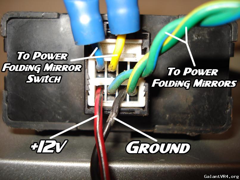

So i picked up a power folding mirror kit. and i am going over the wiring diagrams generously provided by misterfixit. i understand the mirrors and the switch. but i was sitting here for an hour scratching my head like "wtf is this crap!". so i pulled up a picture from tunersnation.com... oh well thats just not right. the relay they sent me is "MB852142" marked with X6T34171, 2X15. the wiring is:
1234
5678
1 = BrL
2 = BrW
3 = blank
4 = blank
5 = L
6 = Br
7 = B
8 = BrB
so... did the guy send me the wrong relay? or is this a older unit? the plug doesnt even match. mine is square with 8 and misterfixit diagram is a rectangle with 13. /ubbthreads/images/graemlins/dunno.gif

progress...
part number: MB852142
Pin out:
1234
5678
1 = BrL to control switch
2 = BrW to control switch
3 = blank
4 = blank
5 = L +12v
6 = Br to mirror
7 = B ground
8 = BrB to mirror
still trying to figure out the Mirror side - Left: Lg, LgB and Right: LgY, LgR. they go into the diagrams relay below and come out as BrL and BrW.
