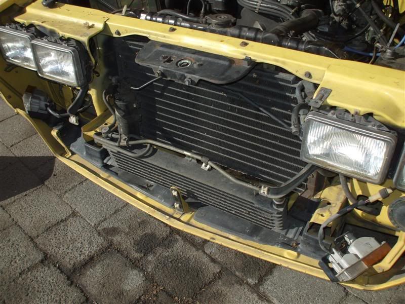

I would say it doesn't matter where the fittings are - it's under pressure somewhat so oil is going to flow in the path of least resistance whichever way it's situated. The lines to the OE oil cooler on my 4G Galant are on the top.

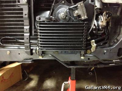

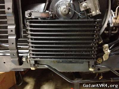

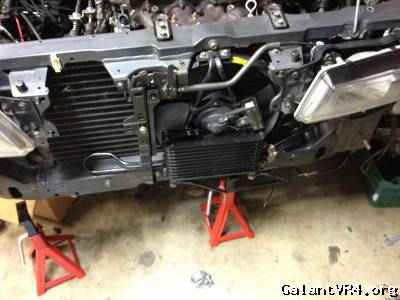

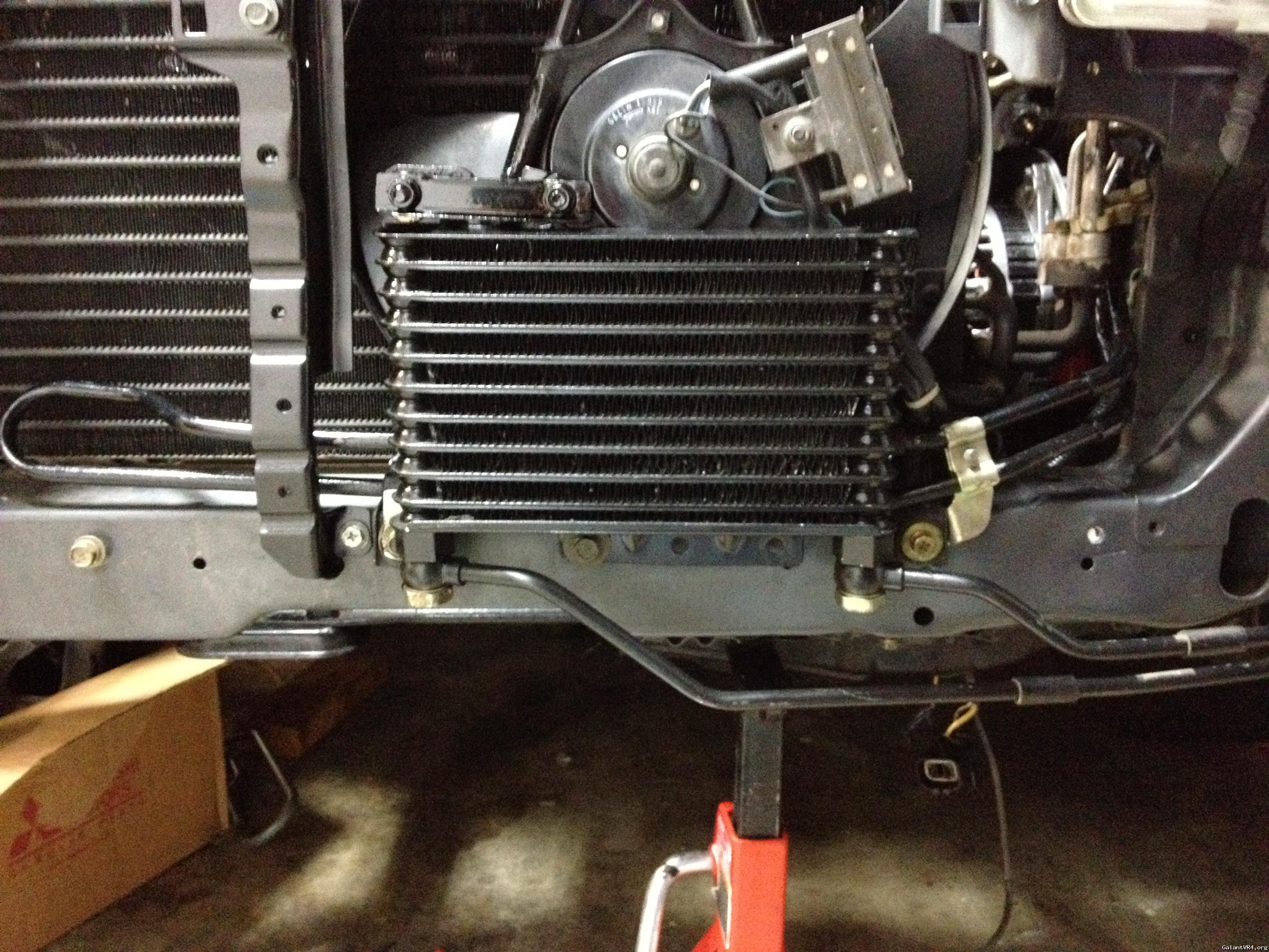

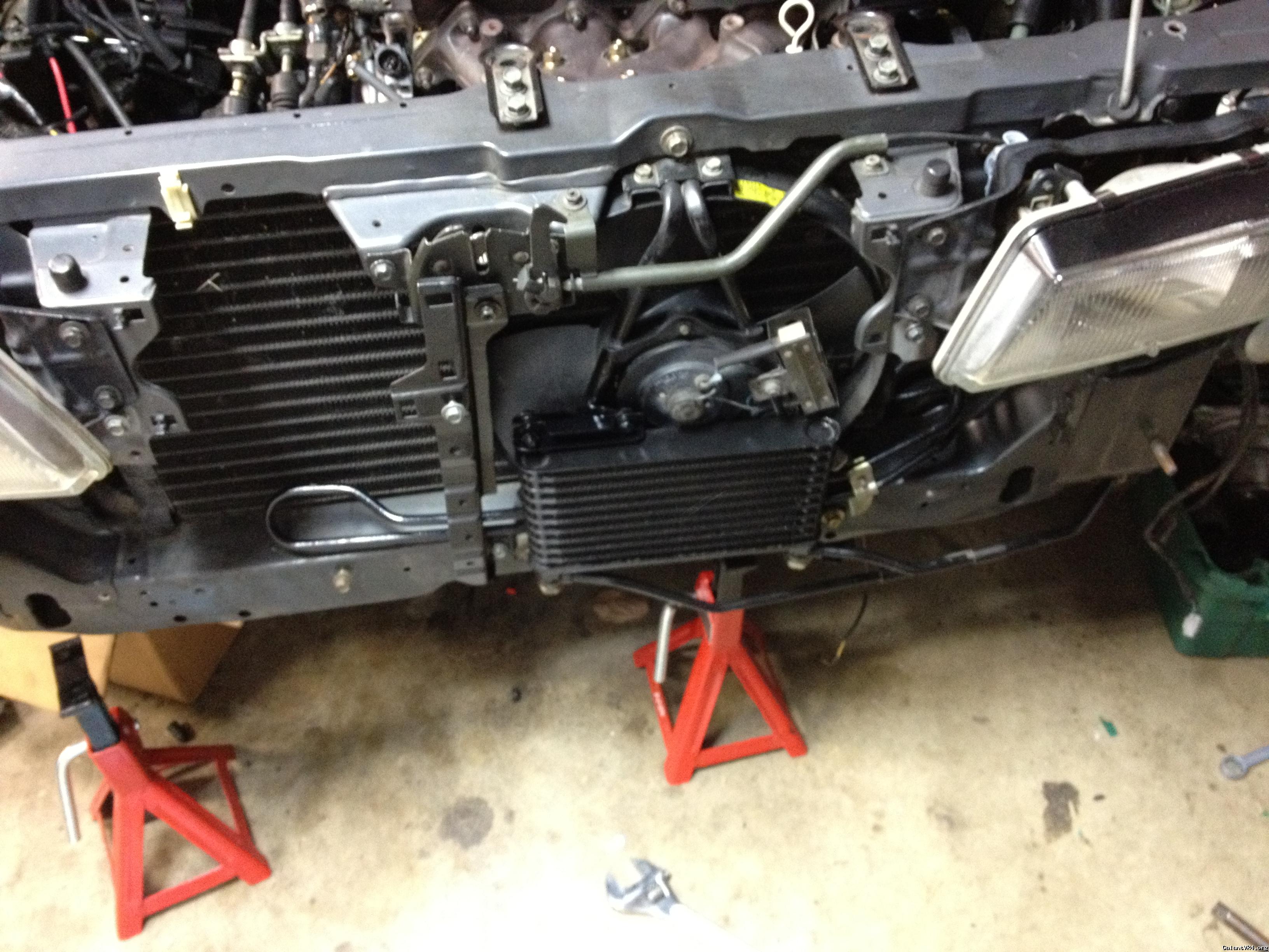

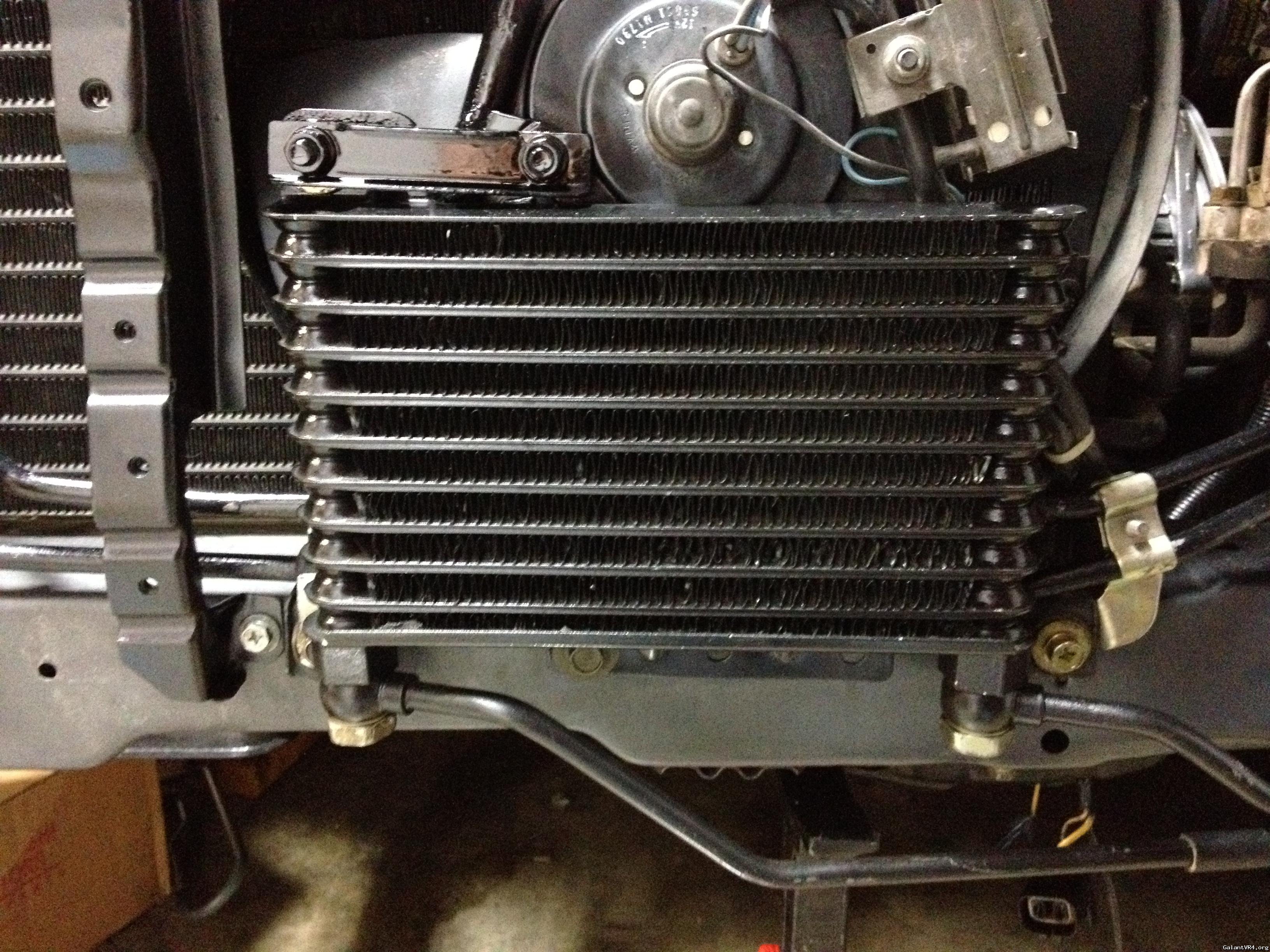

Here's mine. It took some work to space everything to fit just right, but I was able to mount a stock '90 DSM oil cooler with the factory lines. The oil cooler itself was no problem, but I also fit a stock Evo 8 IC with unmodded inlet and outlet. I welded a tab on the stock A/C fan to mount the top of the cooler, with the bottom bolting it a factory threaded hole. I used a 1G dsm power steering cooler, and notched the back of the core support to fit it back as far as possible.
