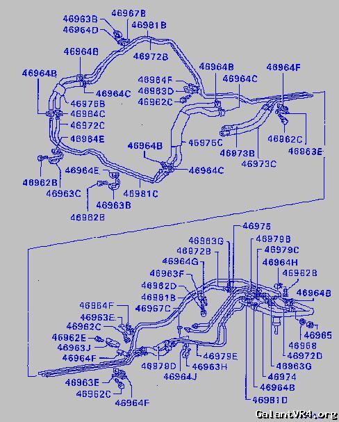

im need a pic of the bottom of a 1991 vr4 or atleast the front end as i need t see if the power steering lines for the rear steering is the same on the US model and the european as i damaged one of the short lines from the rack down to the hose on.

YES they are. but you need LHD to LHD. uk and JDM won't work at the front under the floorpan as the rack is mirrored.
Rich
Thanks thats what i thought
now i just need the parts numbers for the 2 pipes

here's the picture from caps.
Which is the pnc number you need and i'll look up the p/n? This is Euro caps, so if you need to be sure pm me your vin and i'll pull the p/n using your vin.
