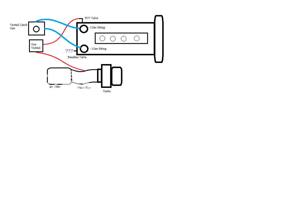

So what would be the ideal route that would still keep the pcv valve and be able to vent enough crankcase pressure? Something like this?
Muskrat
Jun 13, 2004
2,107
Lexington, KY
Ideal:
Keep the stock hose routing, just put a catch can in the middle of each.
So you'd have:
PCV valve > CC > IM
and
Crankcase Vent > CC > Intake Pipe (pre-turbo)
There are catch can's designed to accommodate this. I have one of these: click

This is the ideal setup, spot on.

That makes sense. Someone was selling a valve cover like in the diagram I drew, and to me it made no sense how I'd route that.

Don't forget the check valve between the pcv and catch can to keep boost pressure from entering your crankcase from the IM. The article posted above is great and it re-enforced most of what I already knew, but I guess I hadn't really thought about it hard enough to realize that fresh air needs to come in through the air filter and back into the VC. I had heard that you want a check valve to make sure that air only flows from the VC to the intake, but apparently this is wrong. The last diagram in that article shows a better alternative if you don't want air flowing in through your catch can.
And, for the valve cover with the two outlets on the side, one of the diagrams in the article shows that you can just run two hoses to a catch can with two inlets in an otherwise stock configuration. I would think that this would only be effective if you have two outlets going to 2 ports on your intake pipe.
Since all of this happens after the MAS, will running the stock-style setup cause problems when running speed density, since all of this occurs before the sensors?

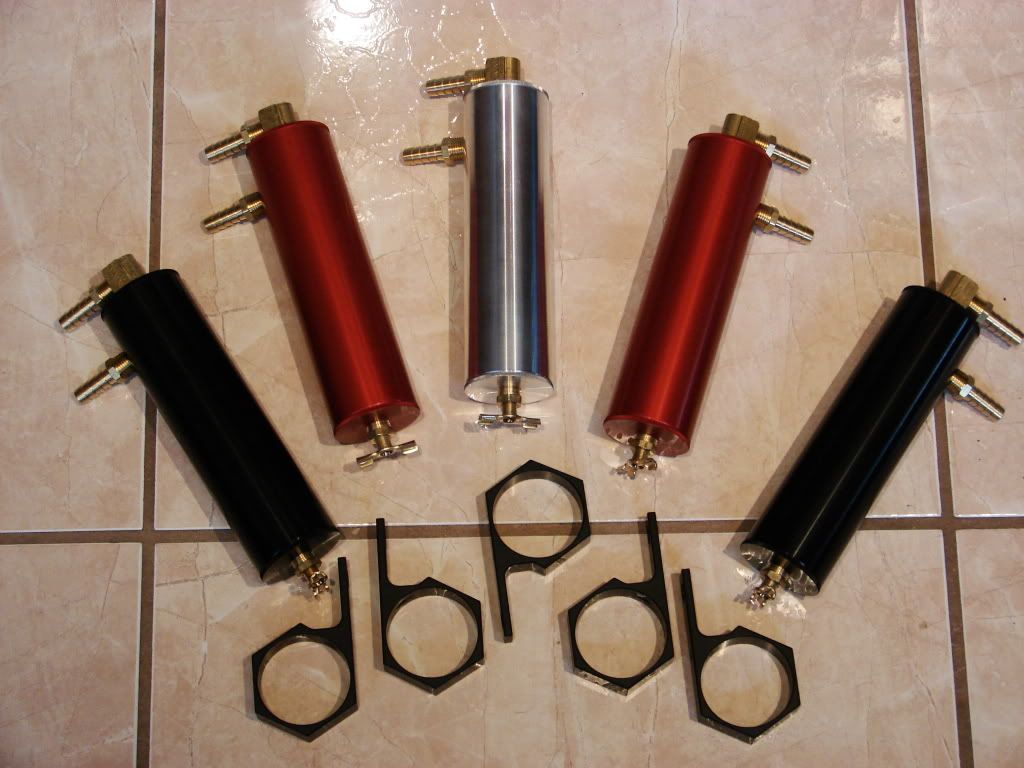

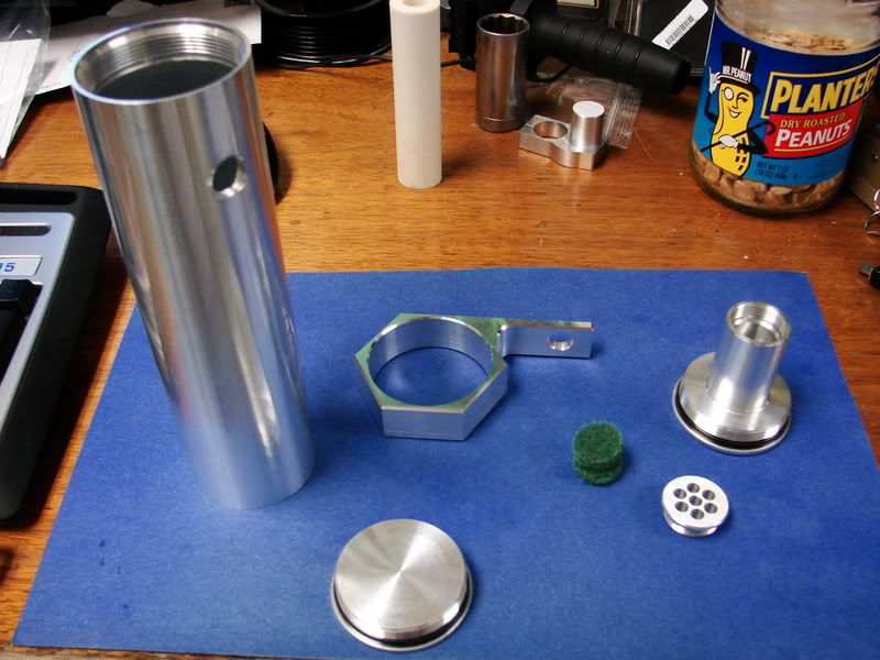

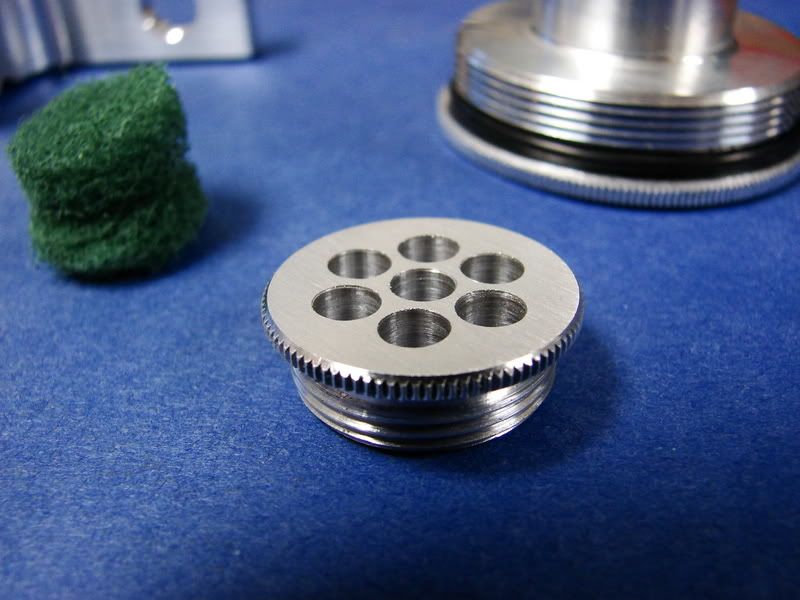

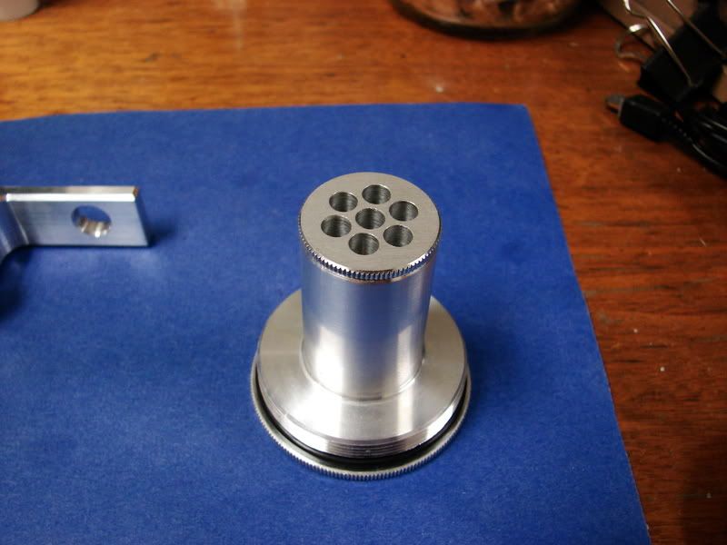

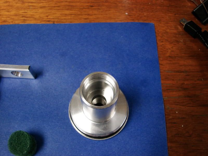

Since I didn't hear from Saikou Michi I did some more searching and finally came upon a well filtered catch can. It's the TTC Performance Billet cans. They seems to have a solid filter setup and offer a few different colors. They are on sale right now as well. I got a chance to talk to the owner and he even extend another small discount since I expained to him I needed 2 of them TTC Catch Can *not my pics*
