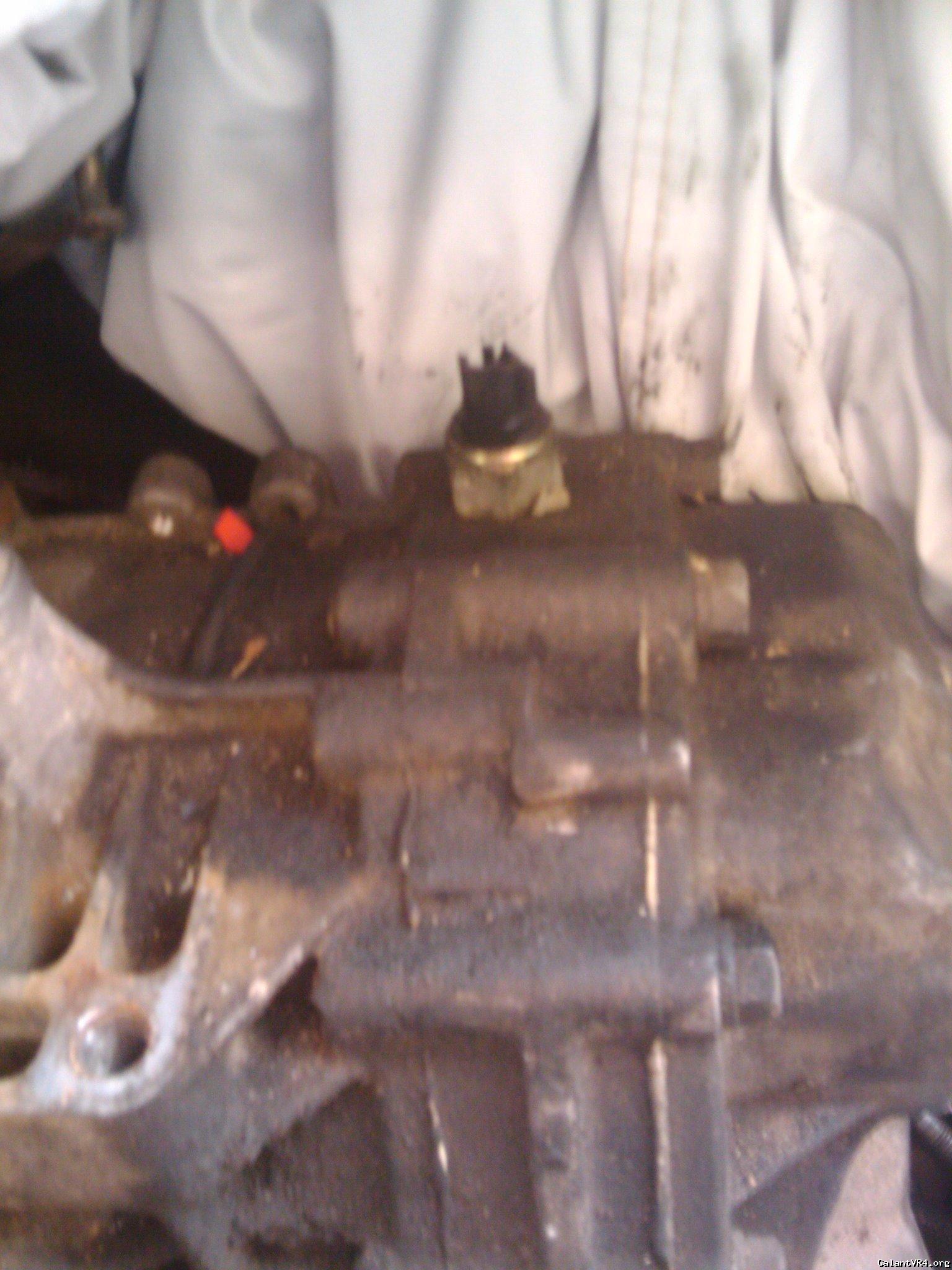

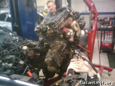

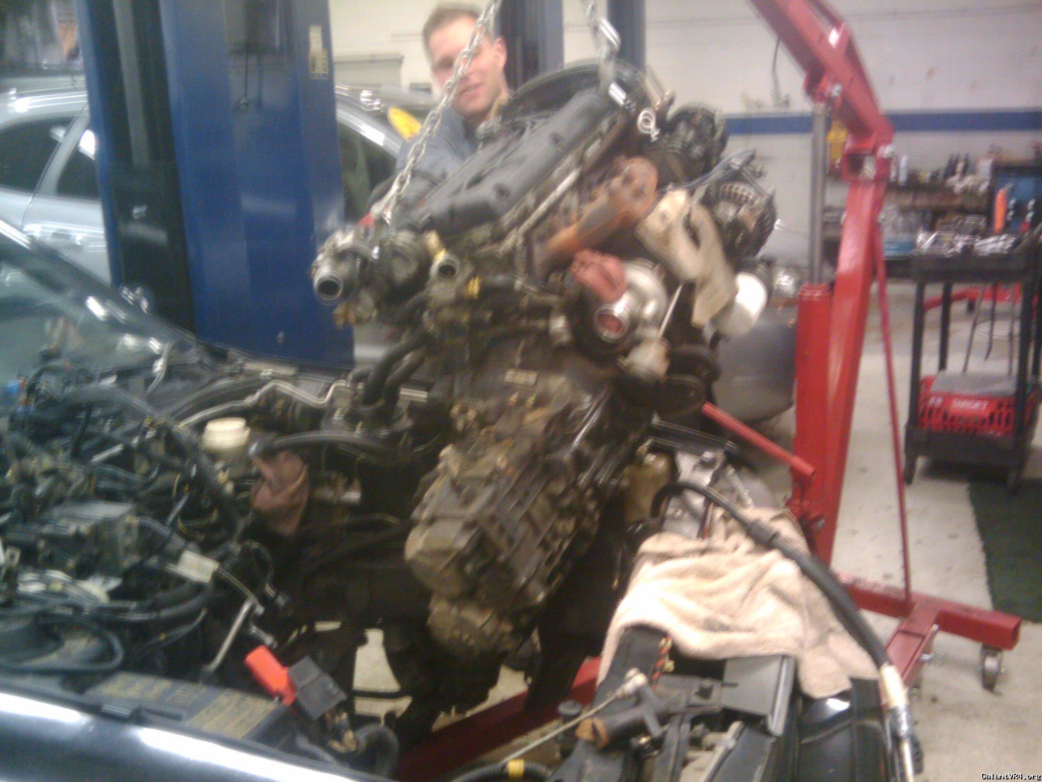

pulled the engine and trans. for no apparent reason.
found that this sensor is is need of replacement.
been looking through mitsu caps program with no luck.
any help would be greatly appreciated
Struc
Nov 24, 2008
764
Oconomowoc, WI
Yeah, not easy to find.
MD730979
It's in 22-130, M/T Gearshift Control
$17.15 at JNZ
