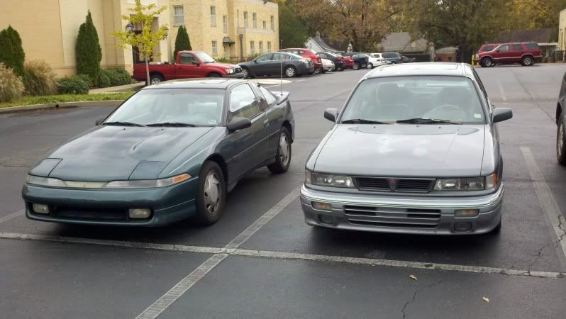

Both my 91 GSX and my 92 VR-4 need paint and body work. The Galant is especially rough with complete clearcoat failure on the hood, roof, and spoiler. It also has numerous dents and dings. I plan to get both cars repaired and repainted soon, but I don't know a lot about body work. Even the good body shops in my area are hit or miss when it comes to quality from what I have seen.
I don't want the dents filled with body filler if possible. Are there alternatives to body filler or is it going to have to be used? Some dents are around the fender wells where there are natural creases and lines in the sheet metal, so I know those are going to be a bit tougher to repair.
Is there any prep work that I can do that will help save on costs or help ensure that everything gets done right?

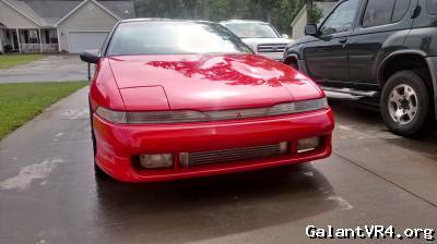

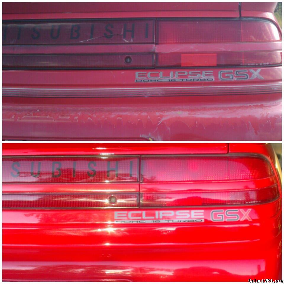

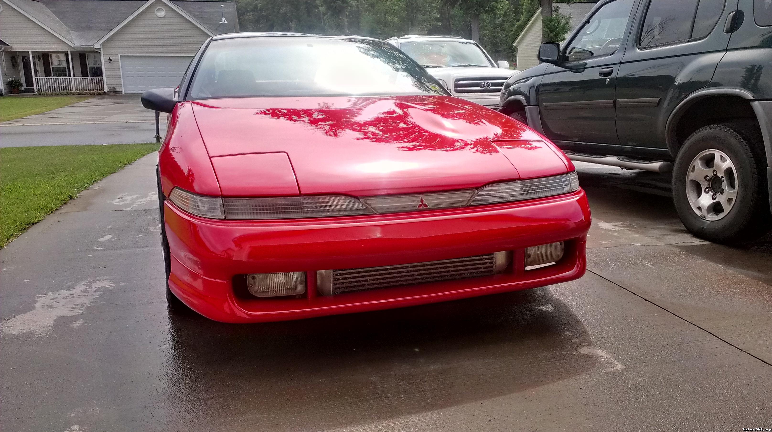

I prepped/painted my car myself this past year, it was the only way I could/would do it affordably. I probably spent around 1500 bucks in paint, supplys and tools. I used DuPont primers, base and clear.
A before and after
And after the cut and polish
The prep work isn't hard, just tedious and long. That's the hardest part. Spraying is pretty easy, however running into a problem and correcting it is where a knowledgable person can help. It's possible to do a decent DIY job.
