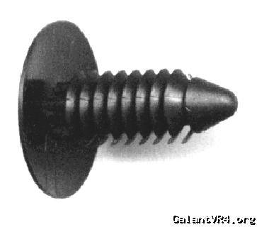

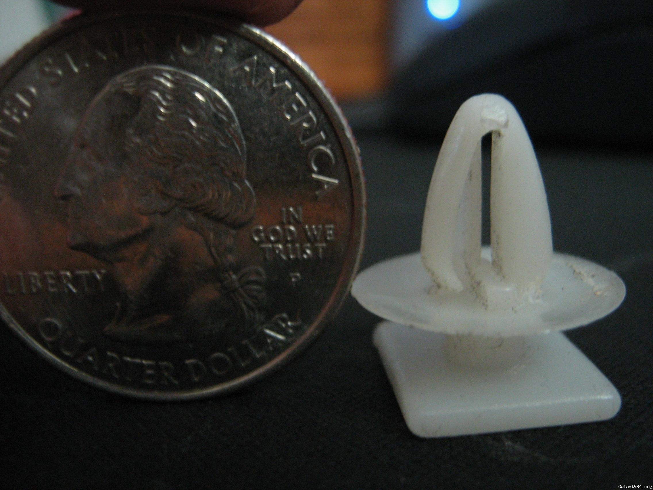

Go to your local hardware store first, they might have a lot more automotive hardware then you think. I ordered some from DORMAN through my local auto parts value, only to find then cheaper and in stock at the hardware store... Here is what I bought that works like a charm. Hope this helps! Let me know if you need more assistence. /ubbthreads/images/graemlins/smile.gif

Part Numbers/sku's would be great!
But I will go look at home depot / Lowes.
Thank you so much....satan wants ~$2.50 each /ubbthreads/images/graemlins/shocked.gif

I would check your local hardware store too. I have been disappointed by lowes/hd hardware selection. working on a p/n...

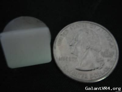

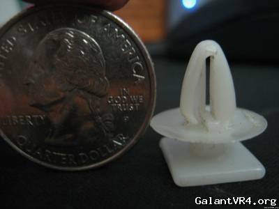

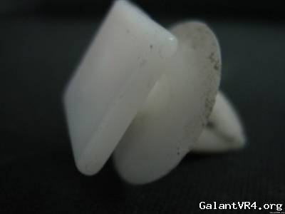

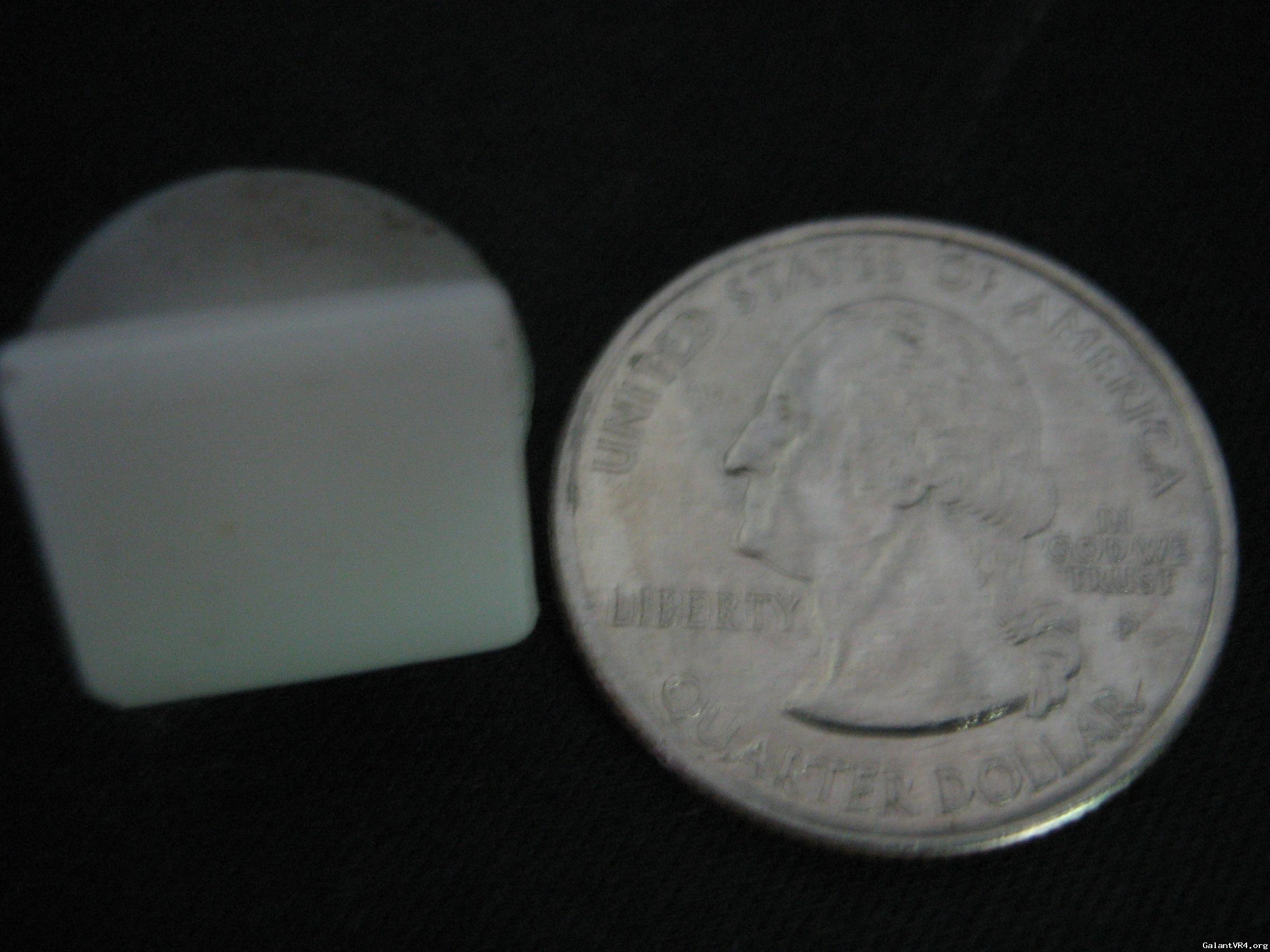

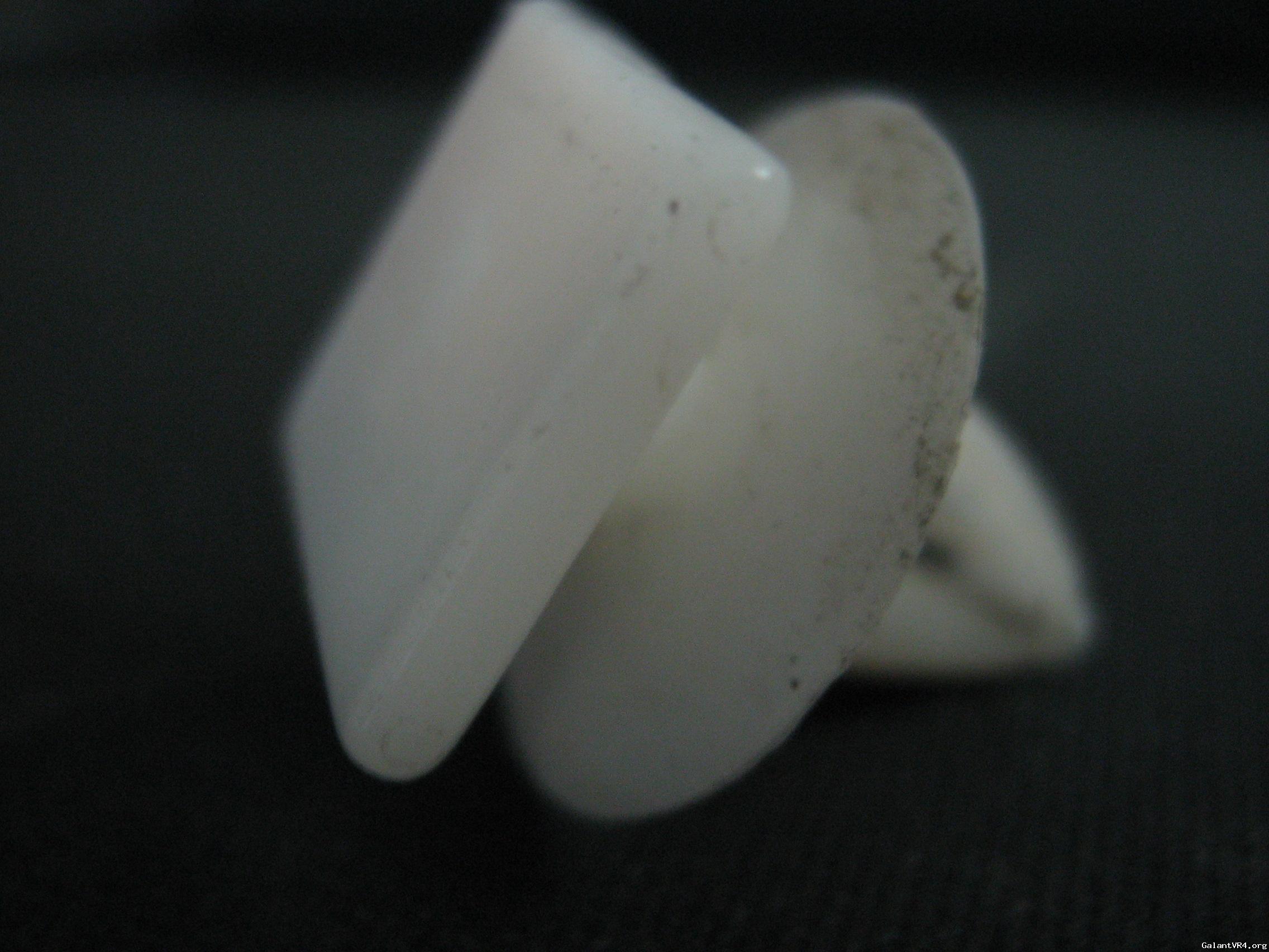

I went to lowes, home depot, and small hardware stores and I could not find these clips. Can you tell methe Dorman part # for these clips?

Still cannot find these....
Need help, anyone know the dorman part numbers? Or maybe another place I can get them?

Id buy the mits ones, Id tryed to use one's from autozone in the help brand packages, and the moulding fell off the door when my kids shut it. luckly it didnt come off on the freeway!I had just found the part at the junkyard and had it painted! I ordered the mits one's and it fit nice and tight. there are two different clips on the top and bottom of the door cladding about 5-6 of each per door
pn# MB567798 for lower doors and rockers and MB319754 for the upper door.

A few years ago when I painted my Colt I couldn't find these either. I ended up getting the Christmas tree looking ones from Napa with the large round head and trimming them with sidecutters to make them square. Worked like a charm.
