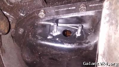

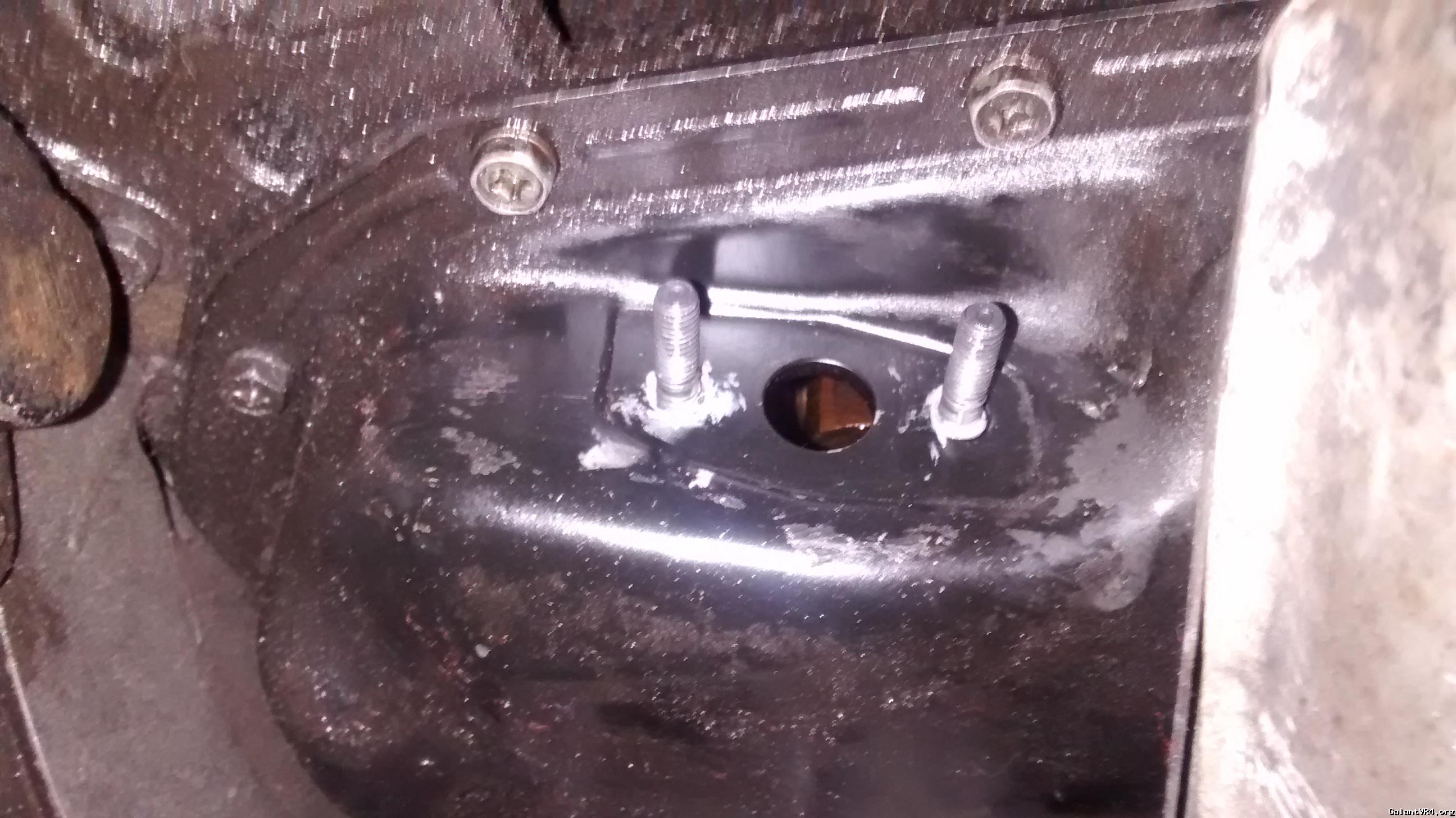

So after some work on my new talon I noticed the bolt holes were almost completely stripped out for the oil return line. I sat down and thought it out. I went and got 2 6mm exhaust studs, mixed up some jb weld and put it together. I think having a washer and nut instead of a bolt will make the oil leakage non-existant from the pan. Also the studs being jb welded in will keep the threads from leaking.

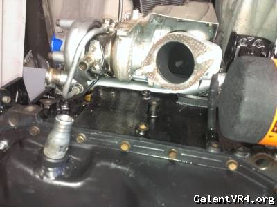

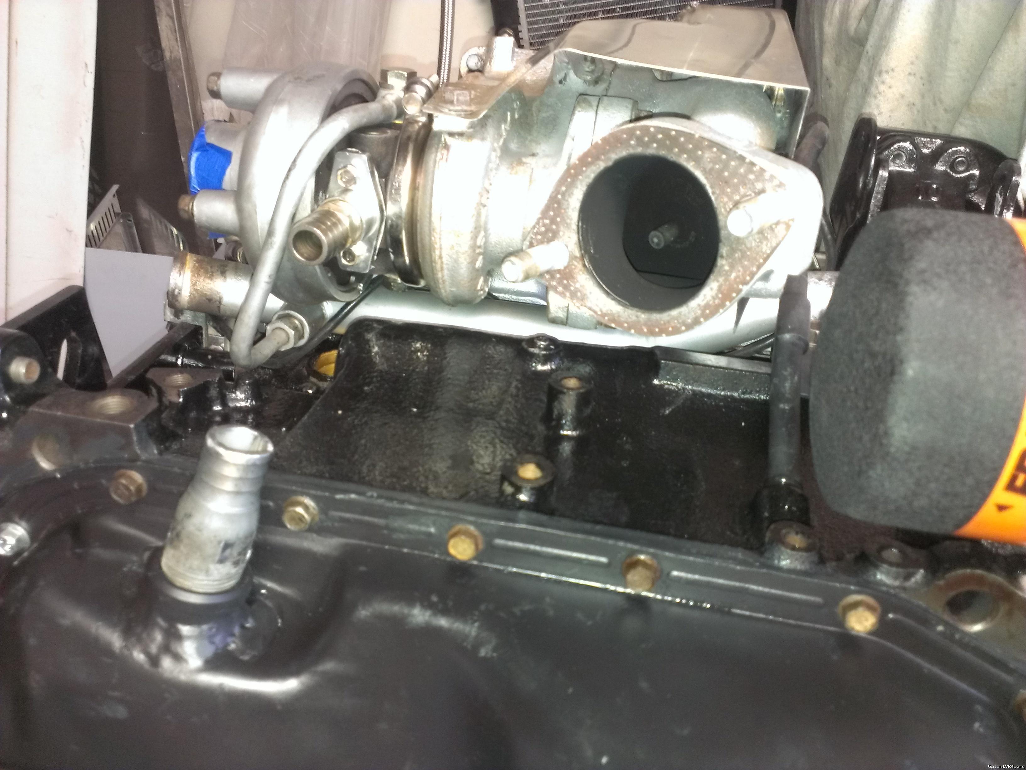

I got it put together and ran the car and no more leaking. Really happy and it was so super easy. Only part that was tricky was getting the gasket from the turbo to the return tube to line up, but only took a few extra minutes to get it all lined up so the bolts would go in. Well worth doing now that it's done and I have checked it and its leak free, IMHO.

I didn't buy another pan because i need it to not leak for the next few weeks while it sits till i get money together to pull and rebuild the motor, but i need to be able to turn it on and move it around every once and a while and not piss oil all over the place. when i rebuild the motor ill probably weld in studs or weld in an AN fitting. the threads weren't totally stripped in the pan, the one hole still had a full turn of thread in them and the other had almost all of the threads left when i did this.
ive just never liked the design on the pan and its always an issue getting it to not leak and seal and tightening the bolts in and if the threads weren't stripped i think the studs with some RTV on them would be great and i personally like my solution and idea and thought i would share.
