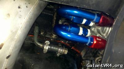

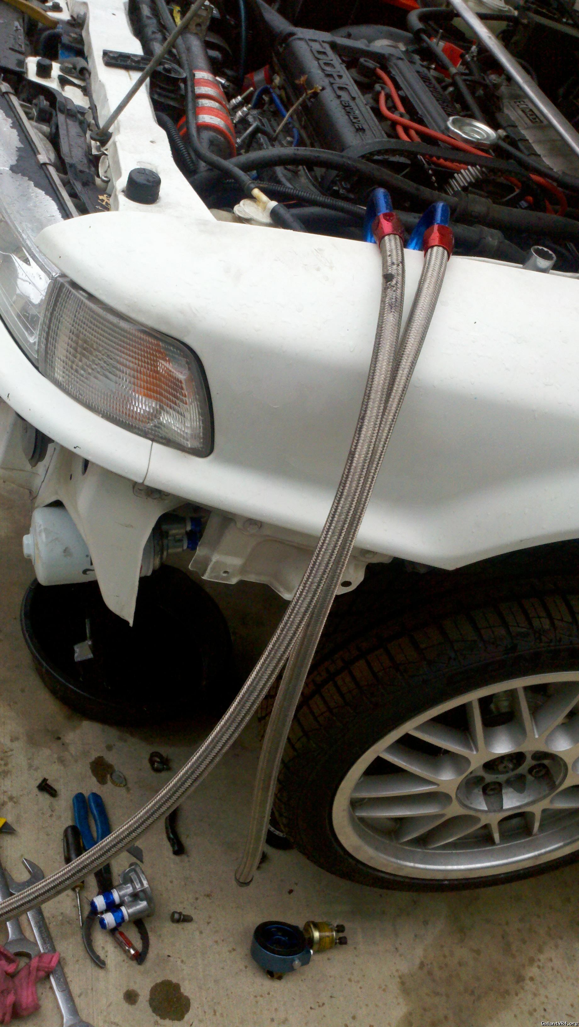

here's mine, but I can't clear my downpipe with the n/t housing, so I'm running forward facing. /ubbthreads/images/graemlins/dunno.gif

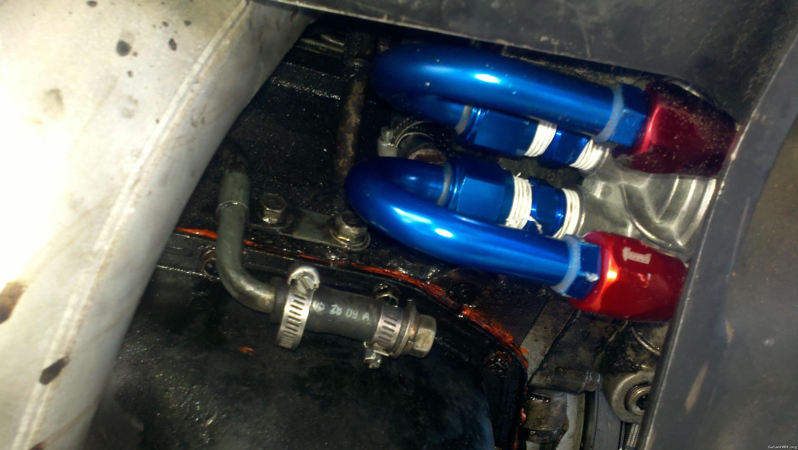

I believe I have figured out a solution to my problem. The oil relocation kit I ordered has the part that fits the bill. I simply installed it on my oil housing and ordered another fitting from the manufactures replacement parts catalog/section.

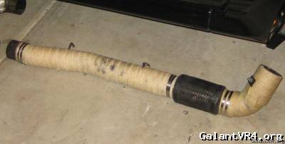

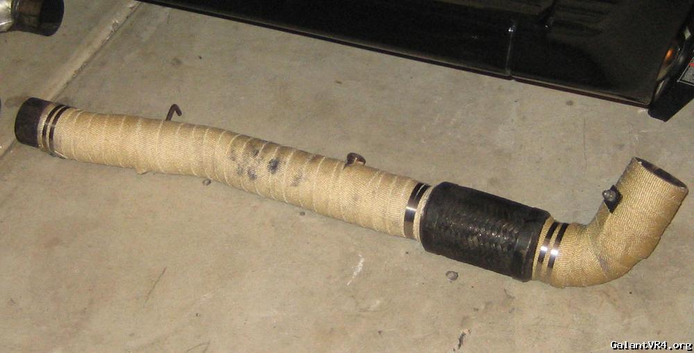

My goal here was, maximum flow pipe 90º bends (not hard angle bends) and reduced heat from the down pipe. <b>Do you guys think I will run into any heat issues from the DP or should I fabricate a heat shield for good measure?</b>

Fabed up shot

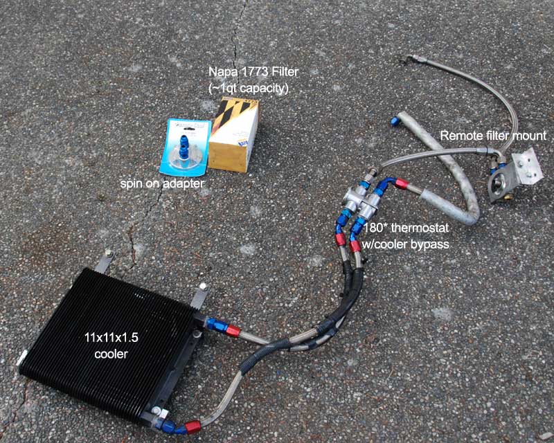

It is a valve that routes the oil right back to the engine until it reaches 180*. Then the valve opens and allows the oil to go to the cooler. Cold oil is bad.
The 90 style oil filter housing has a built in valve also if you are using that.

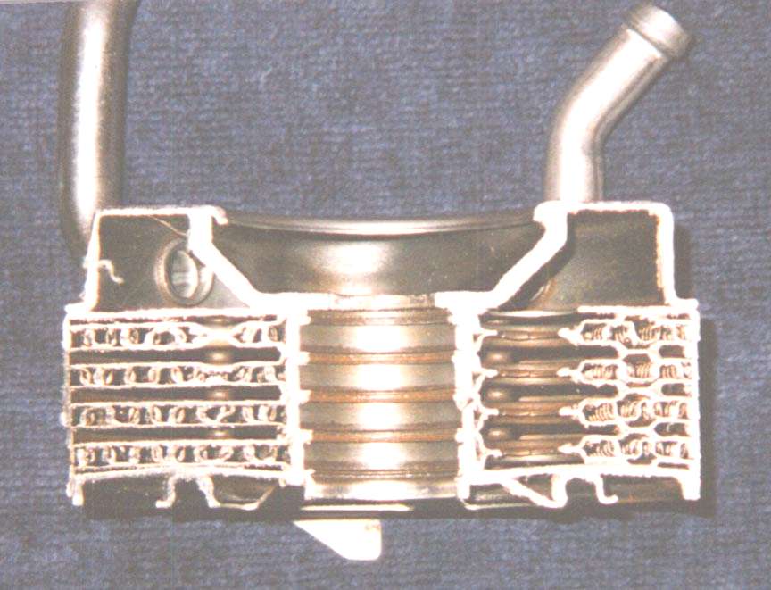

Should have gotten a 90 OFH /ubbthreads/images/graemlins/rofl.gif
Nah just kidding. But anyone want to go into more detail about this forward facing housing?
Valve built into the coolant type? Where?
Ill post more picture in a few days.

When people say "90style oil cooler" they mean the OEM air/oil cooler that came on 1990 DSM's, not the sammich style water/oil cooler you posted a picture of.

It's built into both the 90 and 91+ housings. It's either the brass plug or the other one. One is temp regulated and the other is pressure regulated I believe.
Wrap the exhaust pipe/dp with ThermoTec heat wrap.
Cool that answered all my questions. The valve statement scared me there for a second. I think I have some wrap laying around somewhere.
