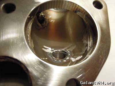

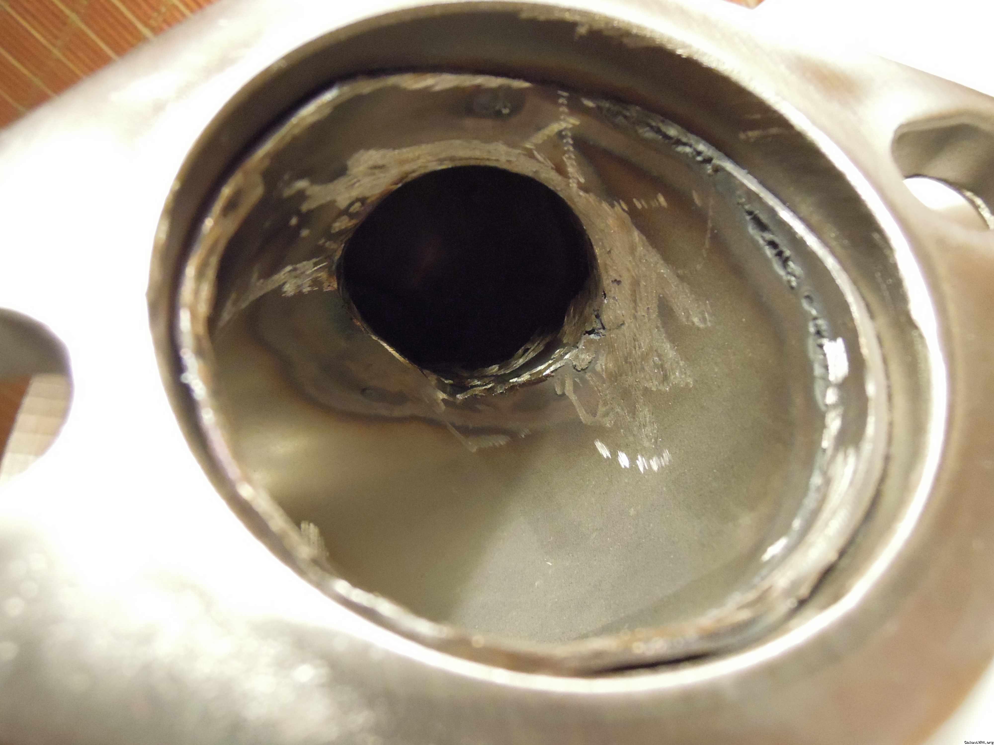

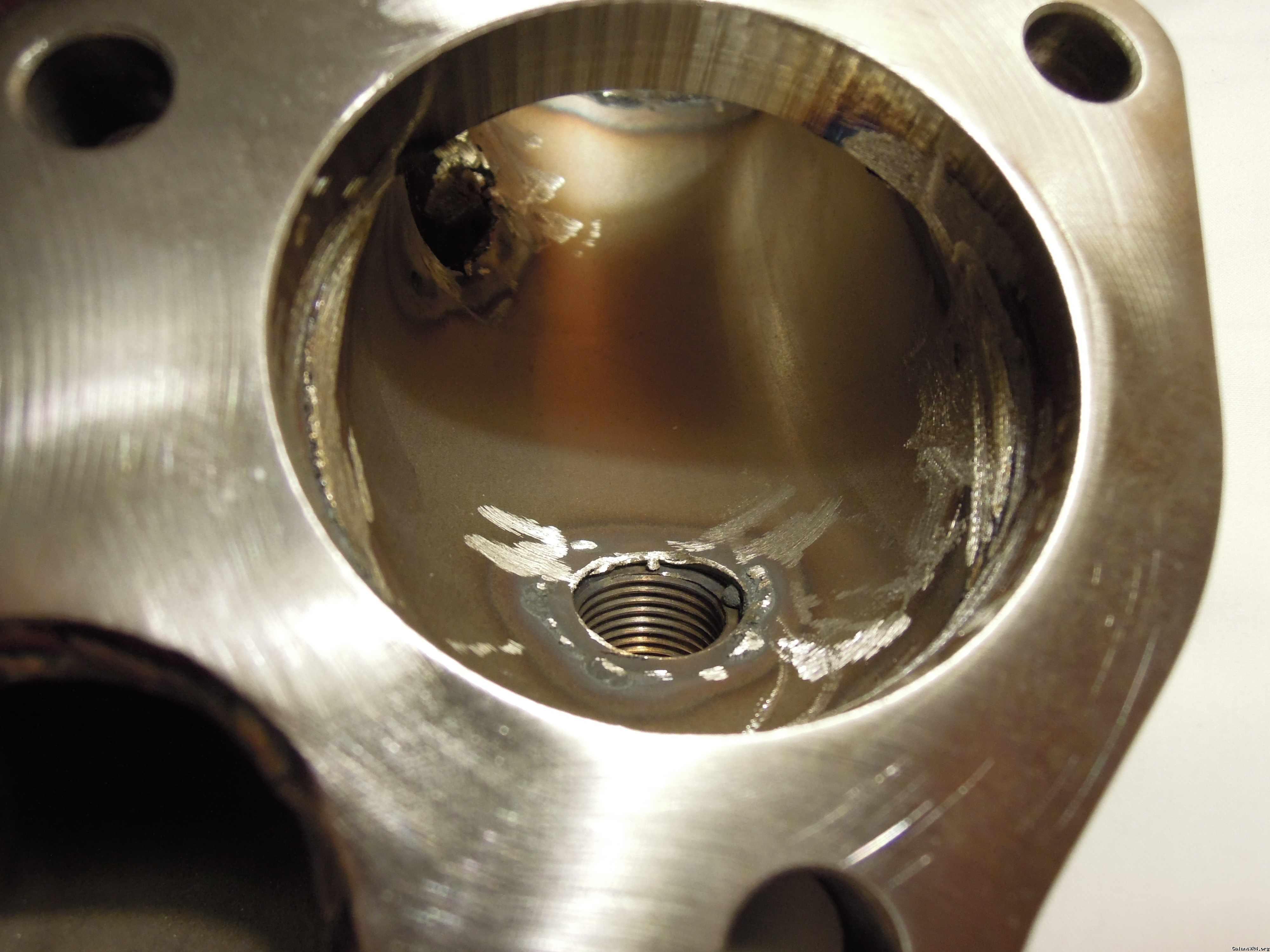

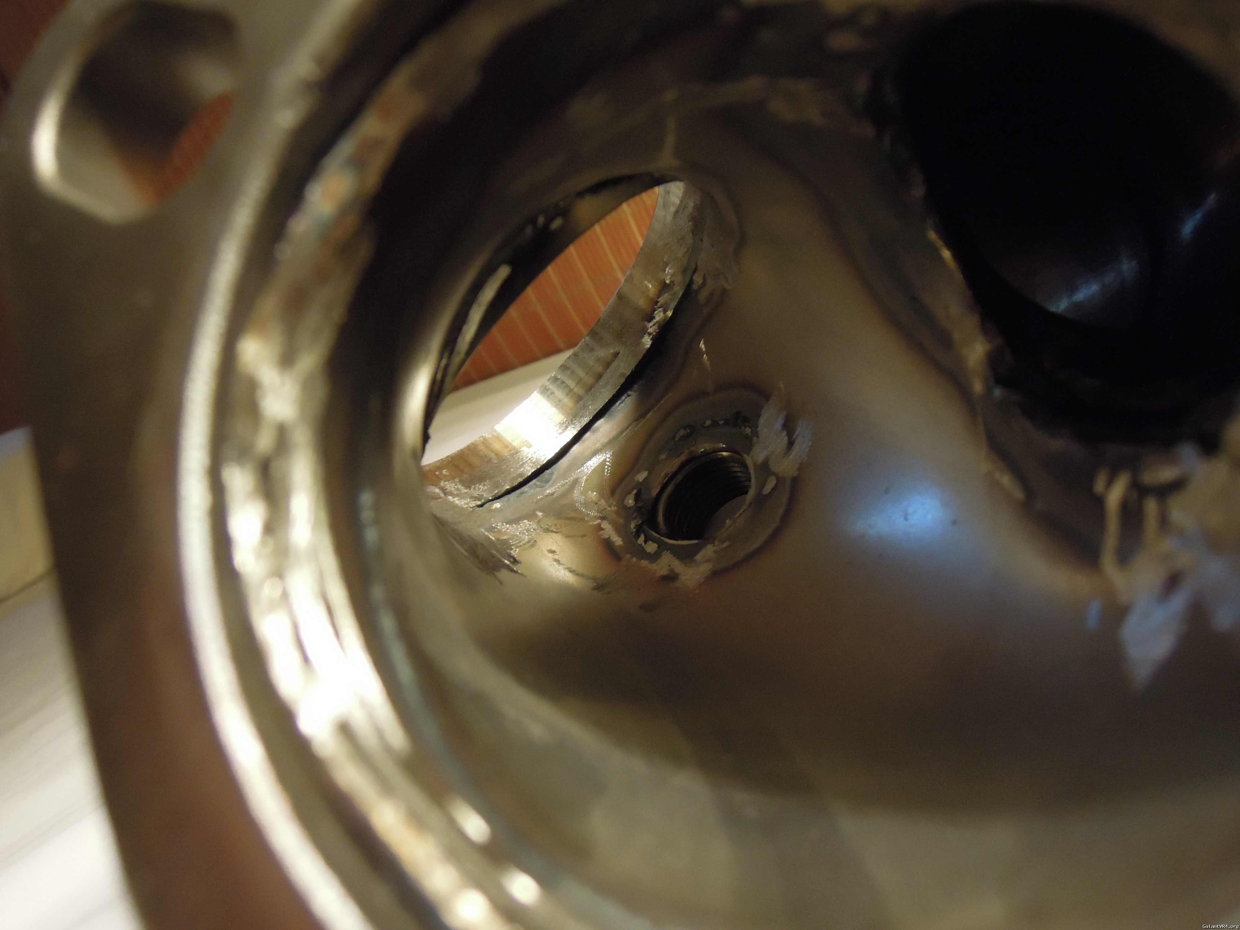

I had the recirculation tube welded but the guys said the stainless was too hard to be able to tidy up anymore. Well I didn't really believe that and so I bought myself a Dremel 4000 and spent about another $40 on tool/carbon steel tips for it. I spent about 15 minutes on it today just to prove to myself that it can be tidied up. I forgot to get myself some goggles so I packed up before I got some shavings in my eye. I think I can tidy this up quite well and I may well pull the turbo and port/gasket match it as well.
Anyway the question is this,
This area is easy to clean up, just grind back and blend because you can do it without affecting the flange thickness.
However because the pipe here comes in at an angle if I grind back to blend the flange into the pipe and remove the 'lip' it will significantly reduce the thickness of the flange at the edge. Should I avoid doing that and leave the lip in order to preserve the flange thickness?

You can take the corner off the flange in the bottom picture. I've done it on a few O2 housings and never had the flange warp/crack there.
