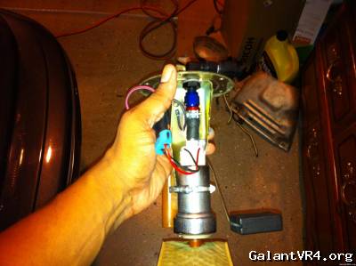

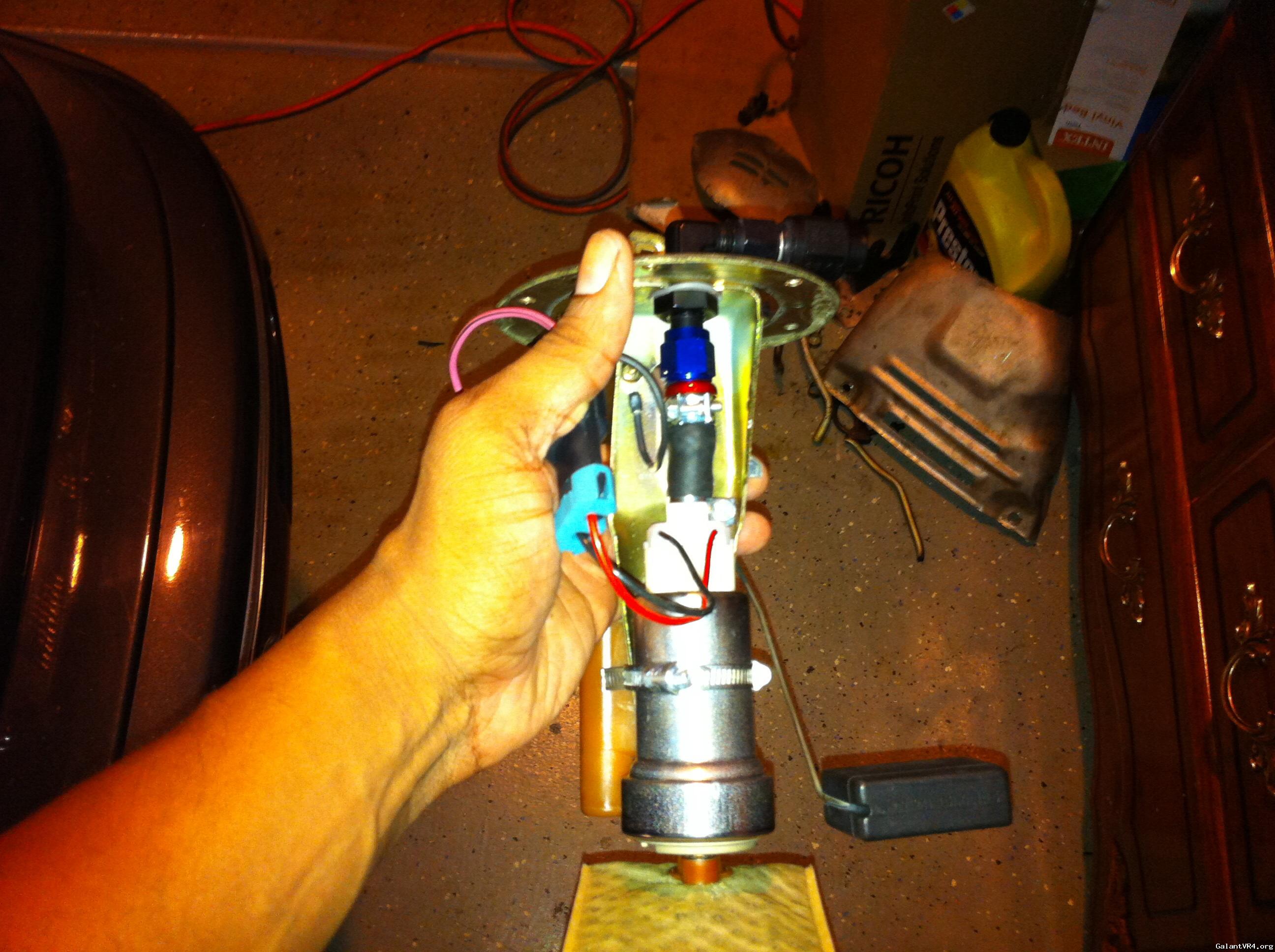

Good point I forgot about the bottom being bigger. To the OP are you trying to just drop it in real fast or do you have some time to work with it. If you have a little time and money go AN fittings and be done with it. You will have to take the bottom of the sending unit out I forgot about that part.
Do something like this.
Then your good to go.

No problem but make sure you do like donniekak and get a proper hose for the fuel tank I believe you can find it a NAPA. You need submersible and E-85 safe hose.
