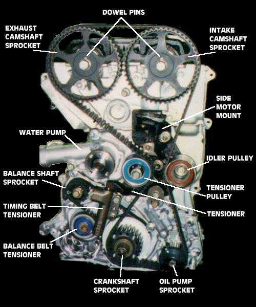

Your no start is probably not as complicated as everyone is making it. If you only did the t-belts and thats it, only things you took off and replaced then I bet your cams are 180 off. It's the only thing your changed. Start there. Stock cams have two sets of marks. It's easy to do. You'll also show good fuel, spark, compression tests too. Just my two cents anyway.

The cam gears are aligned to the cams using dowel pins. If the timing marks are correct, you'll see a mark at 9:00 on the intake cam gear, and 3:00 on the exhaust cam gear. The dowel pins should be at 12:00.

Yes, I actually printed it out when I was changing the timing belt. I have everything lined up, even the dowel pins.
