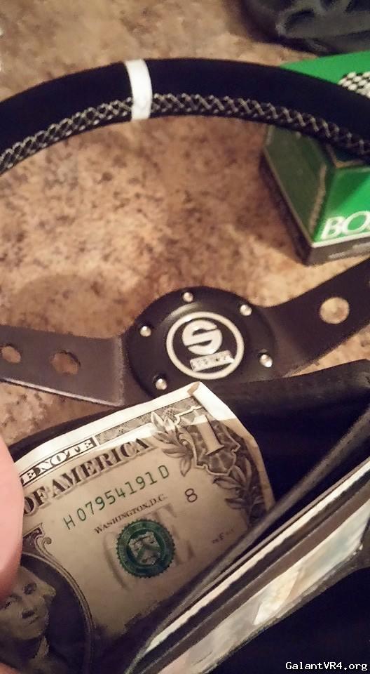

Ok, found a pic of the wheel I put in. not a real sparco wheel, just a sparco horn for the center. I liked the look/feel of it better than some of the oddly shaped sparco wheels out there.
So, I guess for now my only issues are waiting on the parts for the seat install, and finding wheels that will work out for my goals. I've looked into the 5lug swap and i'd like to avoid it if at all possible. I'm eventually going to turn this car into a monster one way or another, just trying to sort out the little mechanical hiccups first, so I'd like to fit at least 235/245s on my gaylant so it'll hook up. I'd prefer 15x8 or 16x8 if anyone has any suggestions.

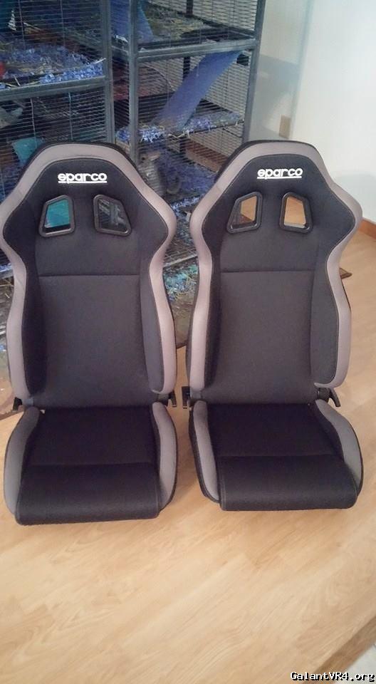

the sparco 600 series seat base and rails, with all of the mounting hardware. unfortunately they said the passenger side might take a few weeks to get in :/

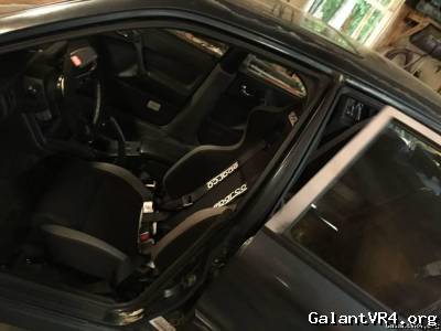

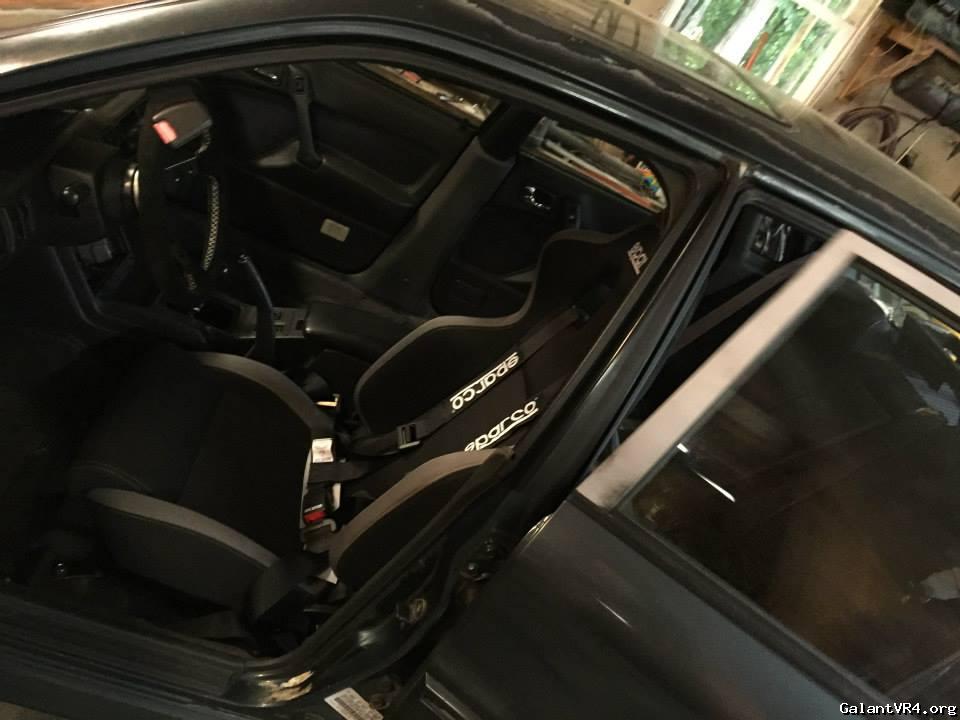

Few updates, spent most of the year fighting with a j32 swapped civic hatch. Anyway, i have both of the sparco seats in now, here's a pic with just one in (didn't think to take a pic after the second one was in):
Gathering parts for her for next year, made some friends locally in the dsm community and i'm going to end up swapping in the front and rear subframes out of a 1g dsm, and it'll end up being 5 lug (my subframe looks like it scraped and there's a rust hole in the rear subframe and the front control arm on the passenger side). Just ordered bushings for the control arms, end links, and the subframe bushings from extremepsi. Also have to take care of the valve cover gasket (leaking) and i picked up the active toe elimination kit. Hope i can get to modding it finally next year once it's all tidied up =D
