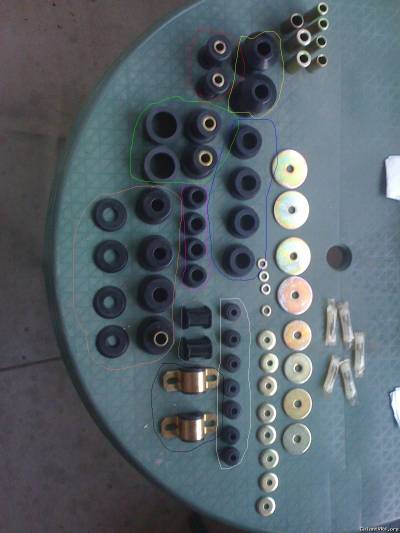

Here is the part numbers from left to right, from top to bottom. Top being the washers.
Row 1- (2) 7057 (4) 2126 (8) unnumbered, believe to be sway bar endlinks
Row 2- (2) 3111 (2) 3174 (4) 2148 (2) Sway bars (2) sway bars
Row 3- (2) 2175 (2) 1008 (2) 1009
Row 4- (2) 1020 (2) 1019
Any help is more than appreciated! I despirately need to know which is which! Again, these are all ENERGY SUSPENSION bushings.

I can't see the part numbers in the picture but I have done so many of those I know where they go just by looking at them. In the picture from top to bottom the 2 on the left (red) go on the front lower control arm in the front. The 2 on the right (yellow) go on the rear of the front control arm. Going down the 4 on the left (green) go to the rear upper control arm. Moving to the right the 4 in a row down (blue) go to the front of the rear trailing arm. The 4 smaller bushing to the right of those (pink) go to the rear lower control arm. The eight bushings left of those (orange) go to the front subframe. The eight small ones on the bottom (white) go to the swaybar link where it mounts to the front and rear lower control arms. The first set of swaybar bushings (grey) go in the front and the next ones down (black) go in the rear.
