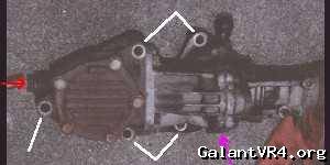

ok i strip the nut in the oil pan were the oil return line bolt too and tryin to get the oil pan out but having problem i took out 5 17mm bolt off the transfer case but the transfer case wont move a bit i loook every were but cant find any other screw that hold that t-case plz help thnx

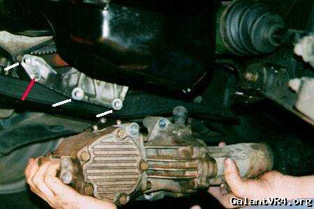

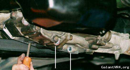

Pics in the VFAQ: click
Goto Drivetrain, Transfer Case, TC Leak Fix.

Once you get all the bolts out of the t-case, use a pry bar carefully, to slide the t-case off. Be careful to not let it drop cause once its free it will slide off quickly. Don't forget that after you get the t-case off you will want to use some wire to hold the driveshaft up so you don't stress the joint by letting it hang down.

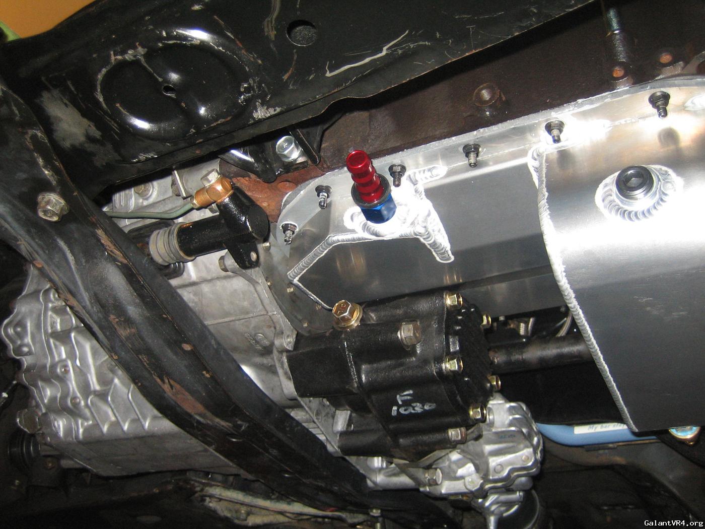

The topic of stripped oil return line to pan bolts has been discussed a thousand times. You can either clean up the threads with a tap or you can have someone weld on a -8 fitting so that you never have to worry about stripped oil pan return line bolts again. The trick to no leak there is using a new clean gasket. ....or an AN fitting.
