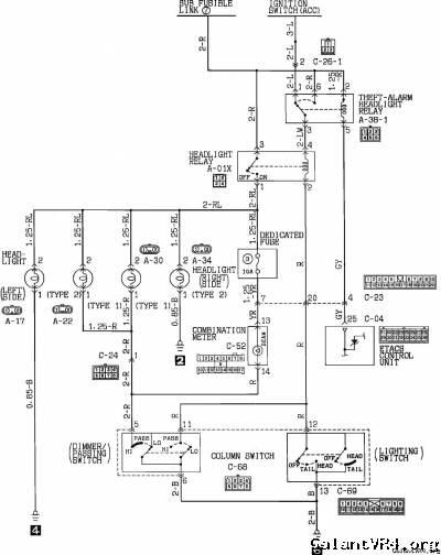

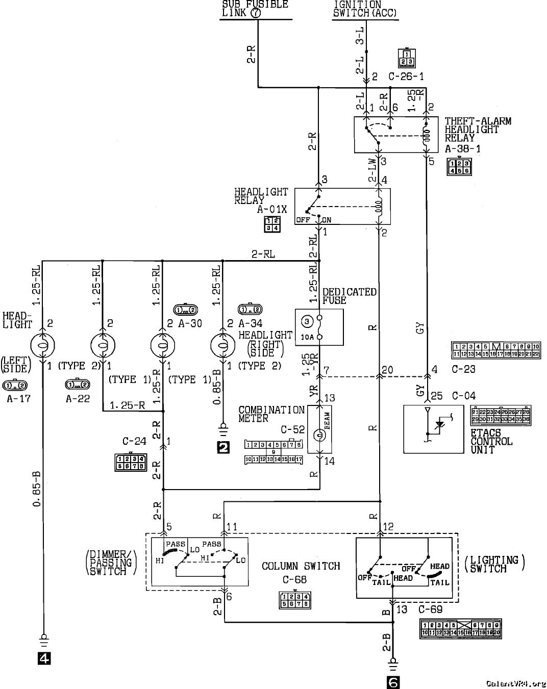

other than a shorted wire I don't see anything in the diagram outside of the dimmer switch that would cause your issue. could be someone miswired the headlamp or posibly you lost a ground & it's backfeeding the high beam circuit. /ubbthreads/images/graemlins/dunno.gif
