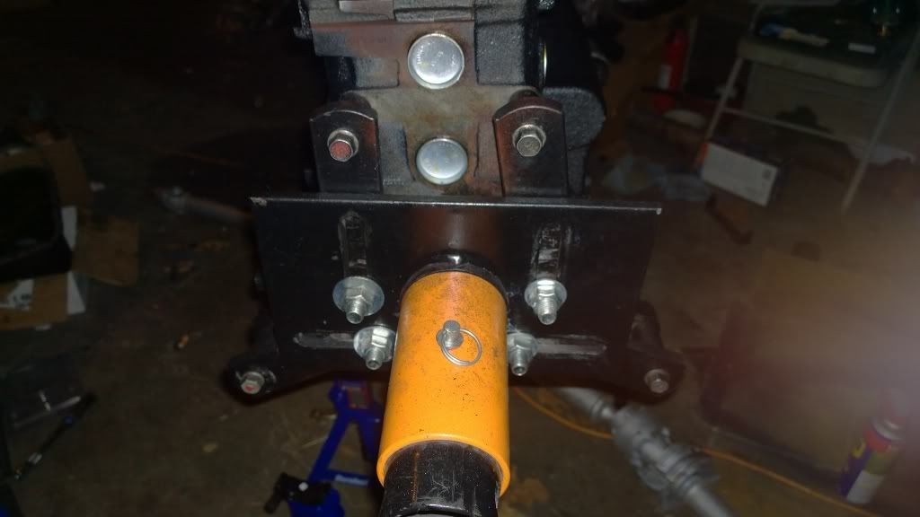

That's how I have mine mounted. the bottom bolts are just transmission bolts, and for the top two, I can't remember what I used, but they were bolts for the motor it's self also haha! I hope this helps

I do not know what brand of engine stand you have. But I do not have any issues swapping from a SBC or SBF to a 4g block.
I have 14 engine stands.
The 4g Main bolts are the perfect length to mount a 4g block to the stand. On some stands the trans alignment dowels need to be pulled out, If the engine stand's arms will not slip over them.
Ill get you some pics of blocks on stands in a bit.

The smaller harbor freight engine stand is what i used this last time. Works fine. Although a circlip for one of the wheels fell off once and i had to fix that... that's what you deal with when you buy sh*t from shipwreck freight.
I too use the main cap bolts to hold the engine to the stand. I've also used the front and rear motor mount bracket bolts with a lugnut as a spacer between the head of the bolt and the stand.

If you get in a bind i have two stands here that are set up for a 4g63 you can use. The bellhousing bolts are 10mmx1.25 thread pitch. I am local to you if you get into trouble.

I just use old manifold to turbo bolts. But I guess it depends on the stand you get as most may need different length of bolts /ubbthreads/images/graemlins/dunno.gif
