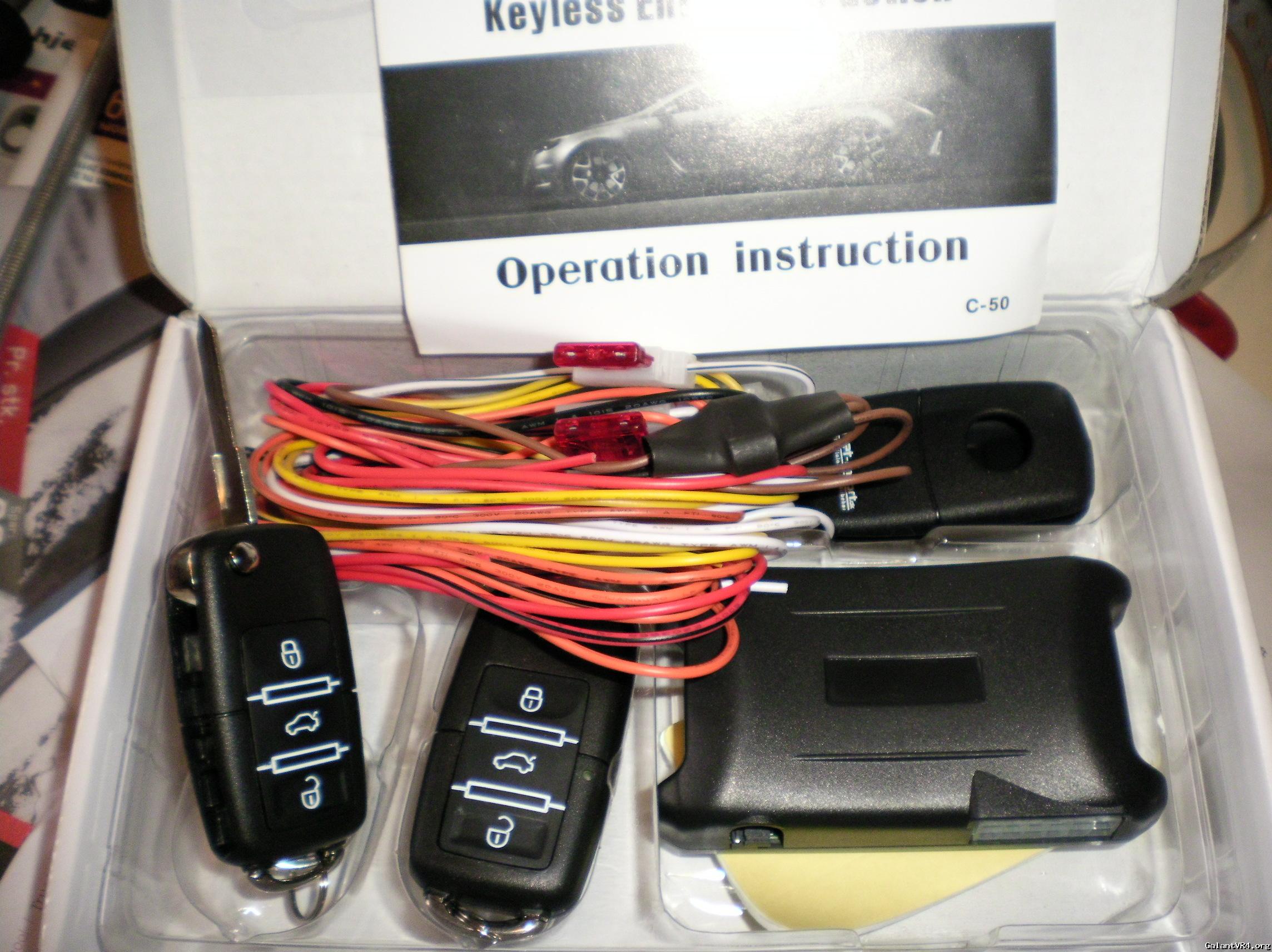

Last weekend I put a keyless entry on the 92 GVR4. I feel so up to date! /ubbthreads/images/graemlins/wink.gif
Also helped solve my problem of the alarm activating every time I unlocked the car from the driver key cylinder.
I bought a Commando one for $39.95, and didn't install any of the fancy stuff, just the straight up keyless. Hardest part was accessing the ETACS (way up in the left corner of the instrument panel, above the fuse block/junction block).
Nice small fob, and really is nice. Bought this
That is all.

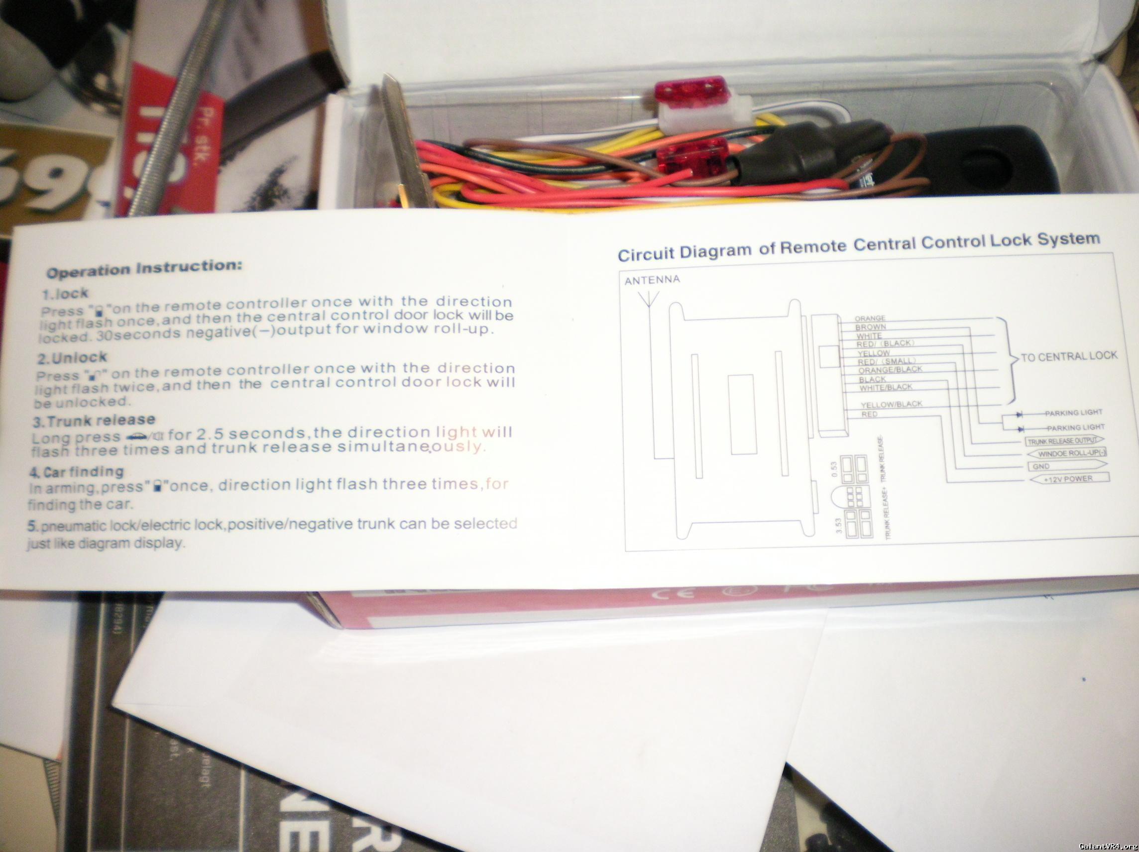

As mentioned, no need to add anything since they are power locks with actuators already. All you are doing is triggering the actuators.
I installed the new transmitter box, connect up two wires (one for lock, one for unlock) to the ETACS, and three power circuit wires: One 12V battery source (acquired at ignition sw), one 12V switched source (also from ignition sw), and a ground wire. Because I didn't want any of the parking light flash, horn sound, dome light feature, or alarm, I used very little of the supplied wiring.
You can get the wiring diagram colors for your specific year (if you don't have a service manual) here:
galant diagrams
