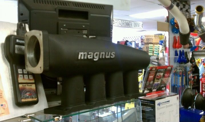

Apparently it is based off his new record-breaking evo cast intake manifold. I may be a little confused but it seems like Magnus is advertising faster spool than a stock manifold as well as more power everywhere, especially top end. Am I reading this right??

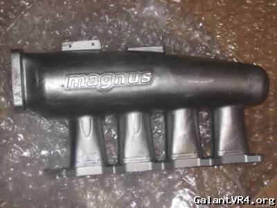

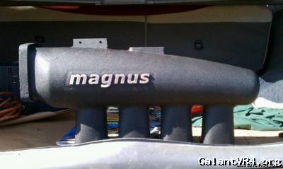

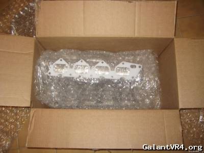

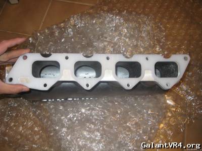

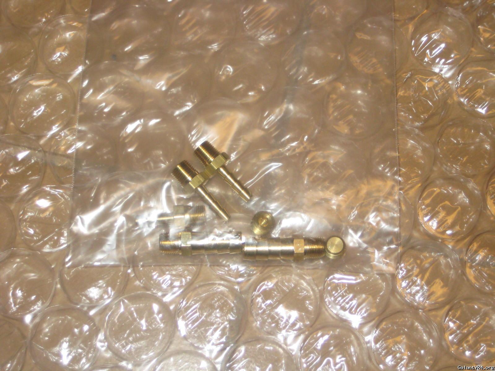

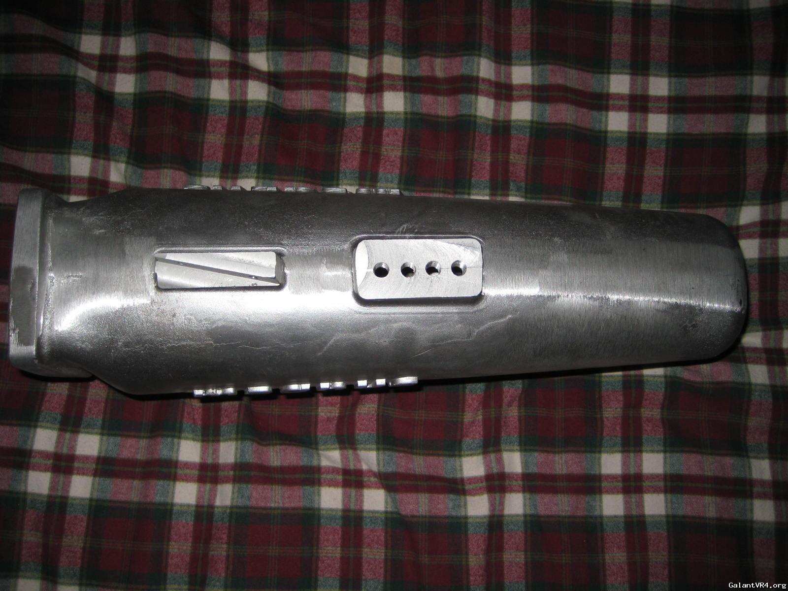

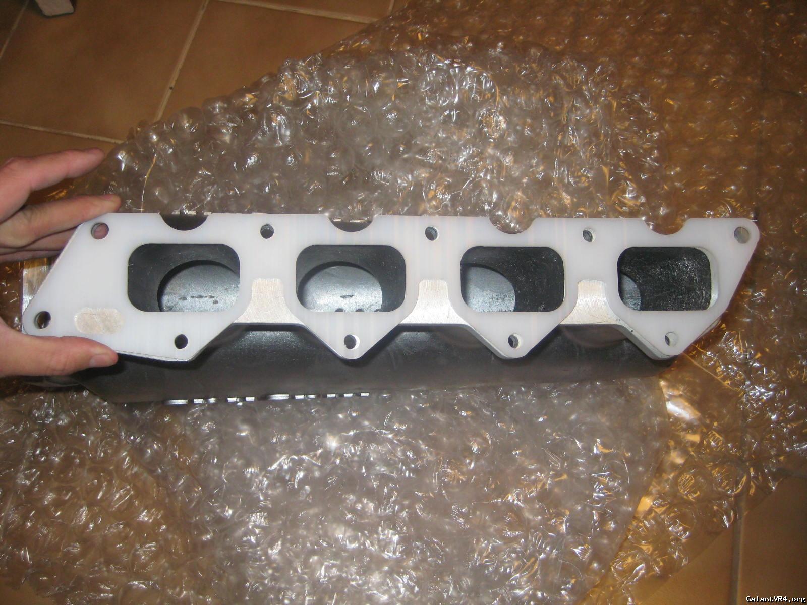

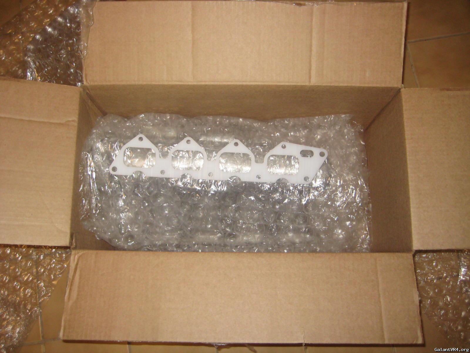

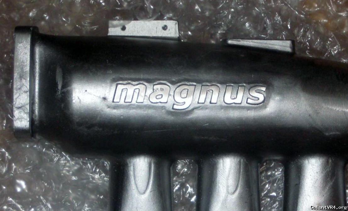

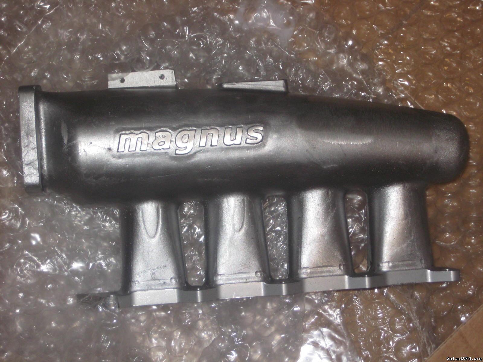

here is some pic of the manifold, this manifold is a prototype and the finished product will look like what you see on the MAGNUS website...
before pics
bigblock4g63
Feb 10, 2009
308
new jersey

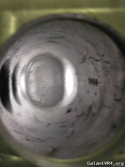

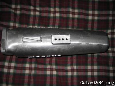

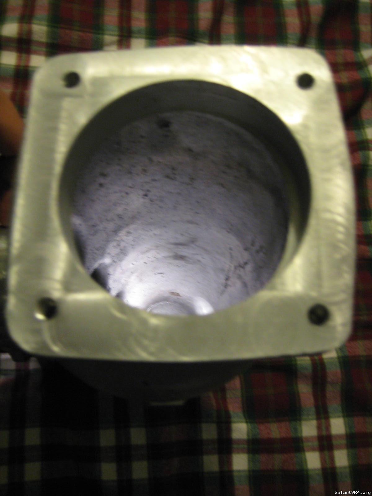

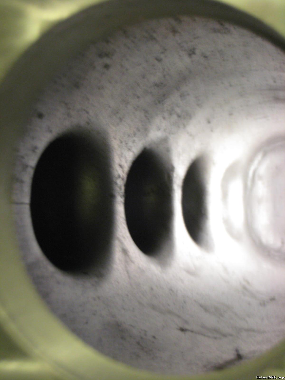

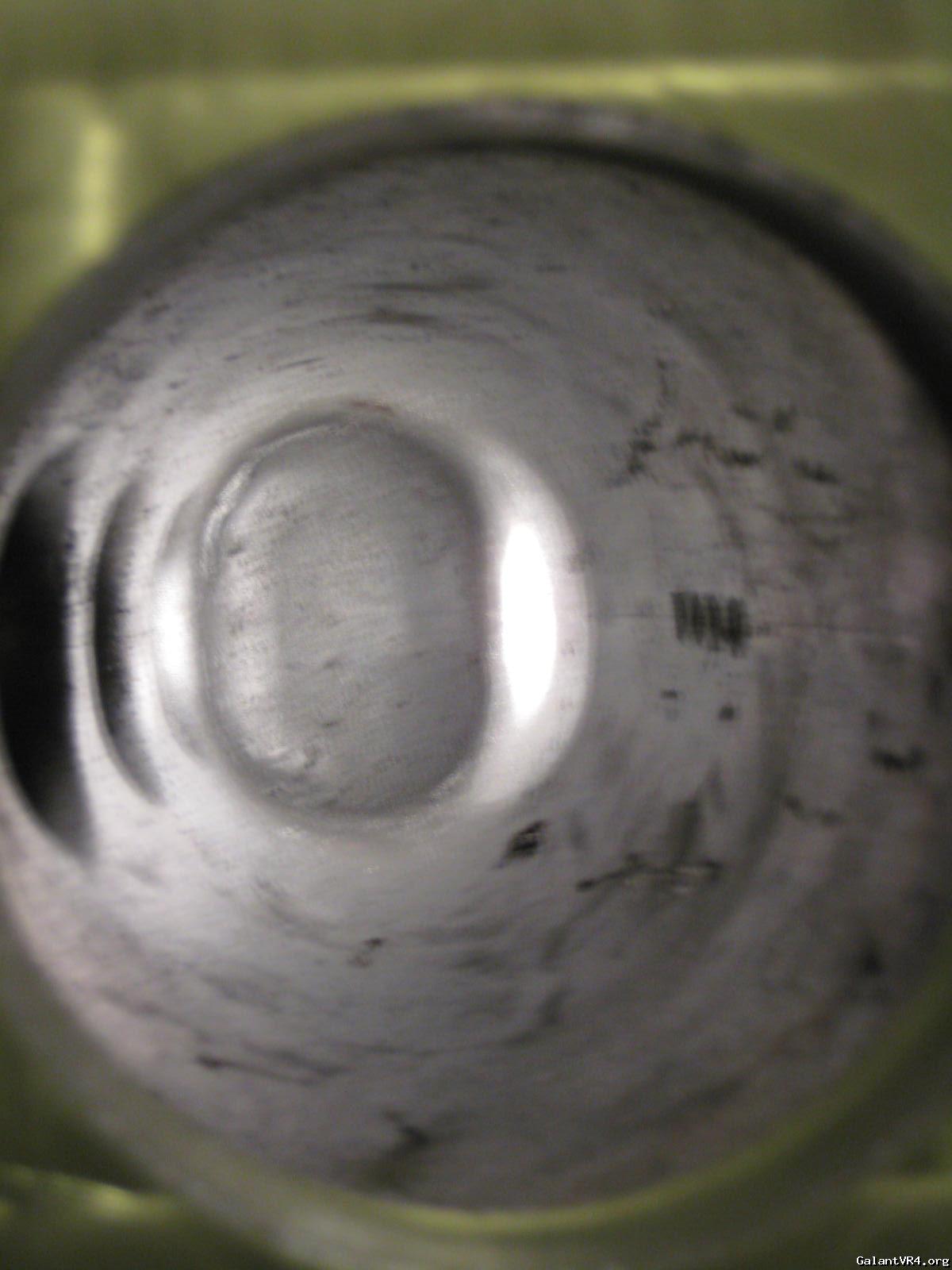

notice the "a" had some bad casting...i later removed the casting in between see the atfer pics.
....REMEMBER THIS WAS A INTAKE THAT MAGNUS USED TO TEST AND I BUGGED HIM TO SELL IT TO ME. I AM VERY HAPPY WITH THE PERFORMANCE FROM THE INTAKE...THE FINISHED PRODUCT LOOKS BETTER

Looks like a pretty bad a** manifold. I'd like to see some other independent testing to tell whether or not it's will perform like Magnus says. They've built some great manifolds in the past, so I'd expect to see this continue that line.

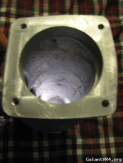

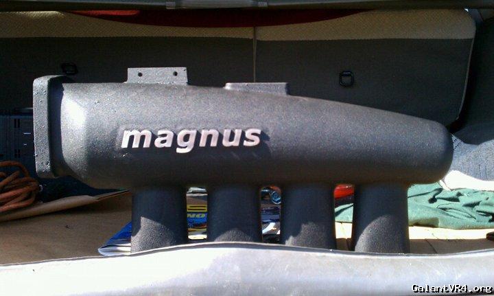

waiting on the hogans "newer design" to get here so i can test it.... "but there is catch" after the first set of testing i ported the inlet and cleaned up the runners to remove the casting marks and bumps. i also machined the magnus adapter out to match morales racing 70mm gasket and had the intake powder coated black

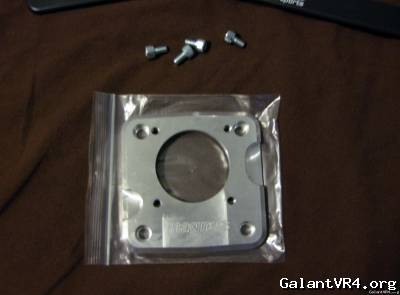

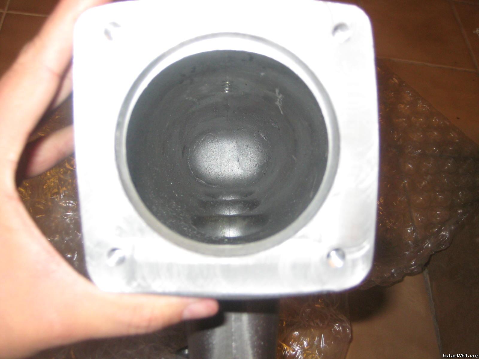

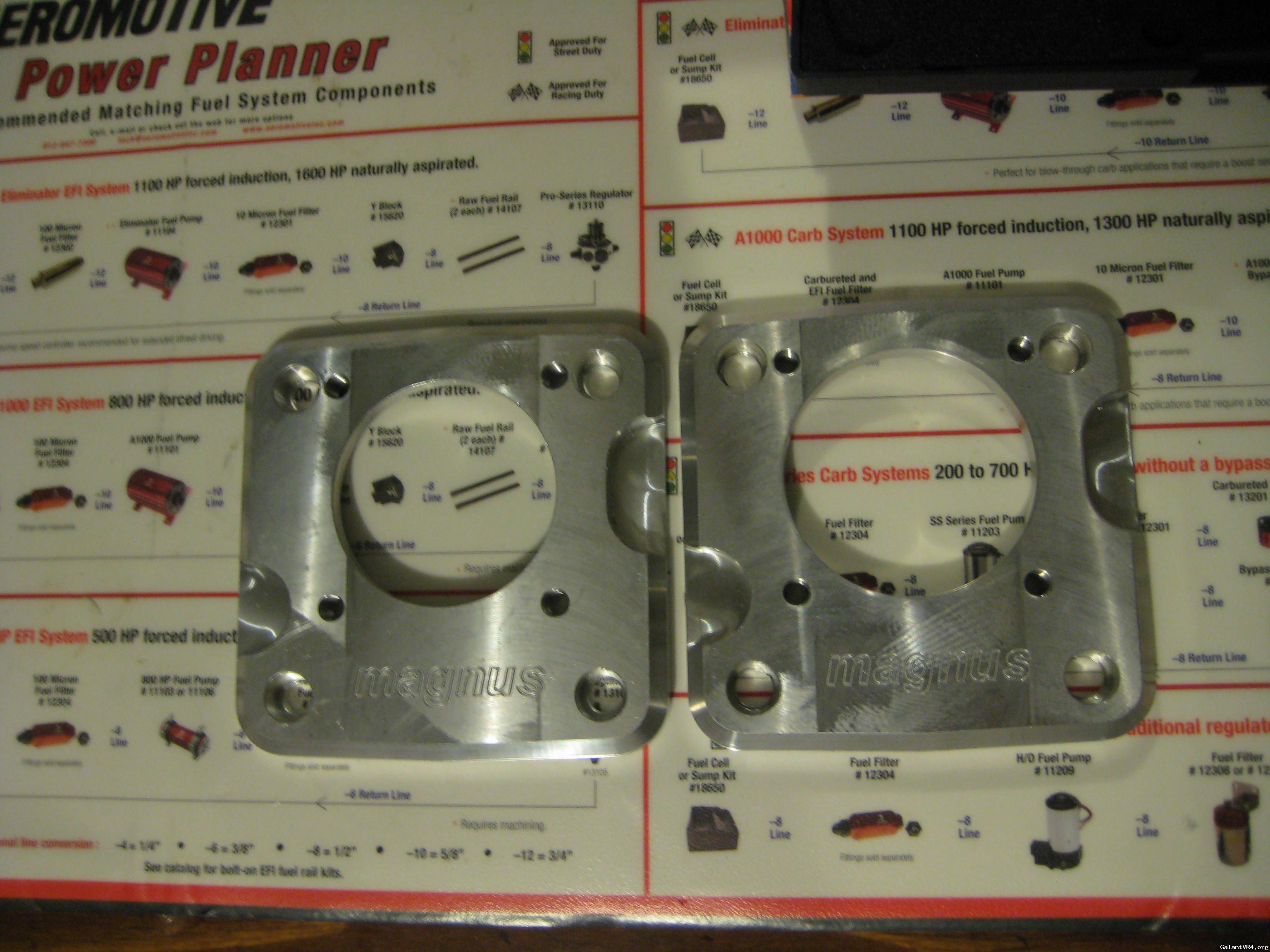

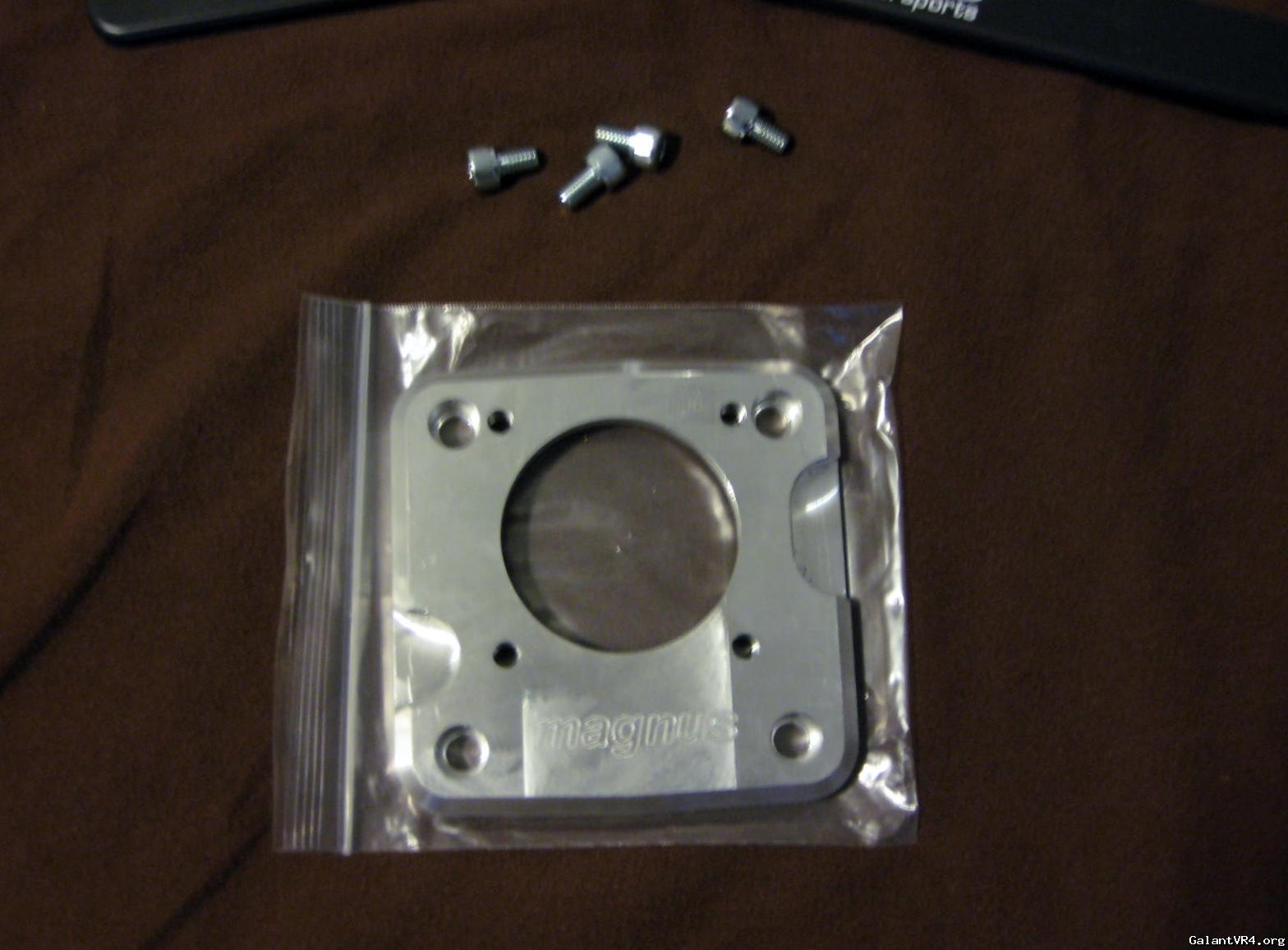

on the left is the stock magnus adapter and on the right is the magnus adapter i machined out

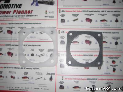

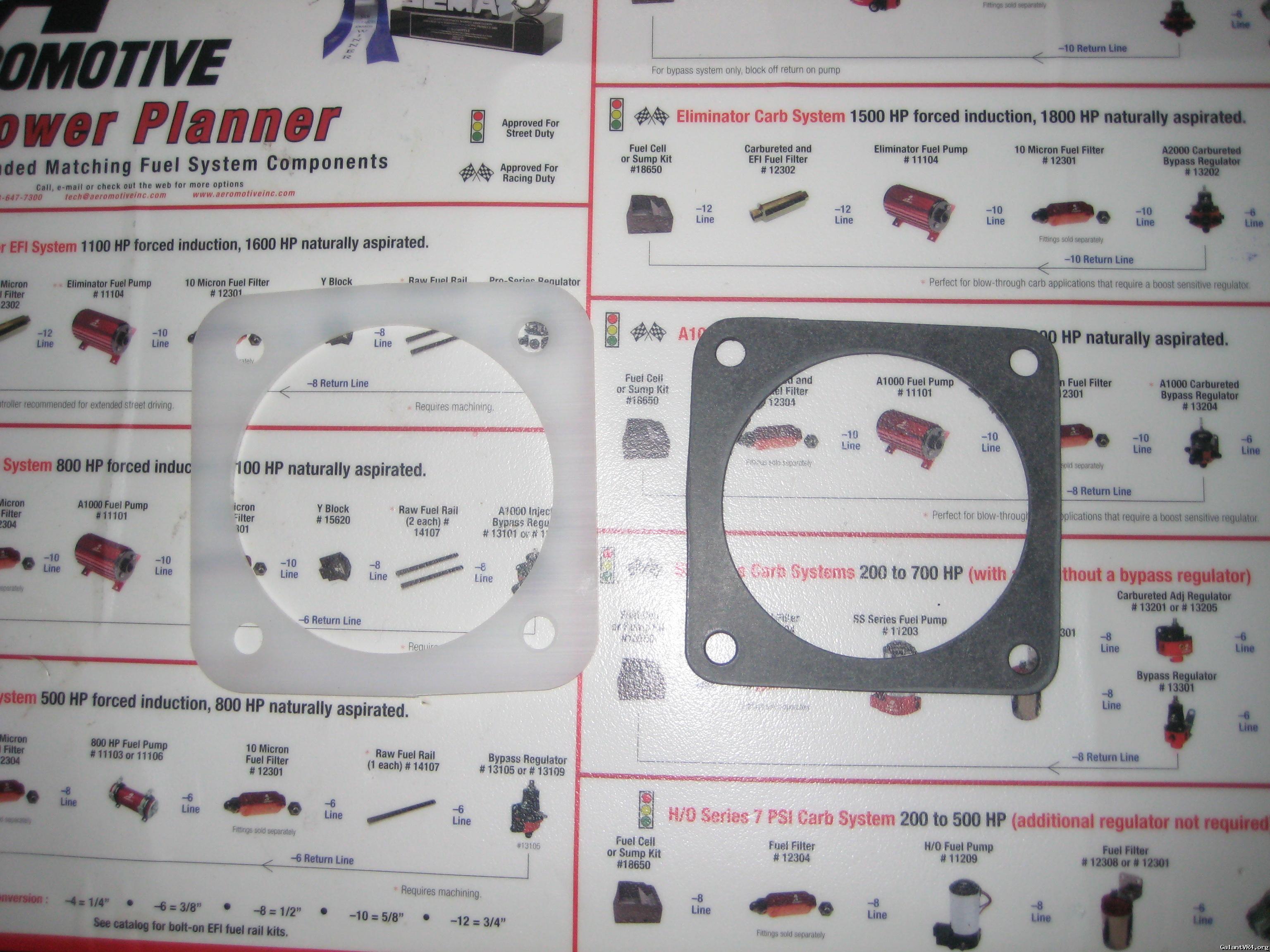

left is the magnus adapter gasket and right is the morales racing gasket.
at the time i didnt have the magnus gasket so i used the morales racing gasket

Seeing as how that one you have is the prototype is it safe to assume that the inside of the finished consumer product will be cleaner? It looks pretty rough from the casting. Not that extrude honing it wouldn't smooth it out.

yes i will....i have ask marco about it. also rememeber even other company intake manifolds have some bad casting marks

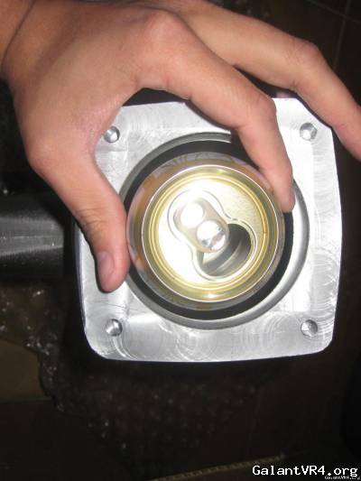

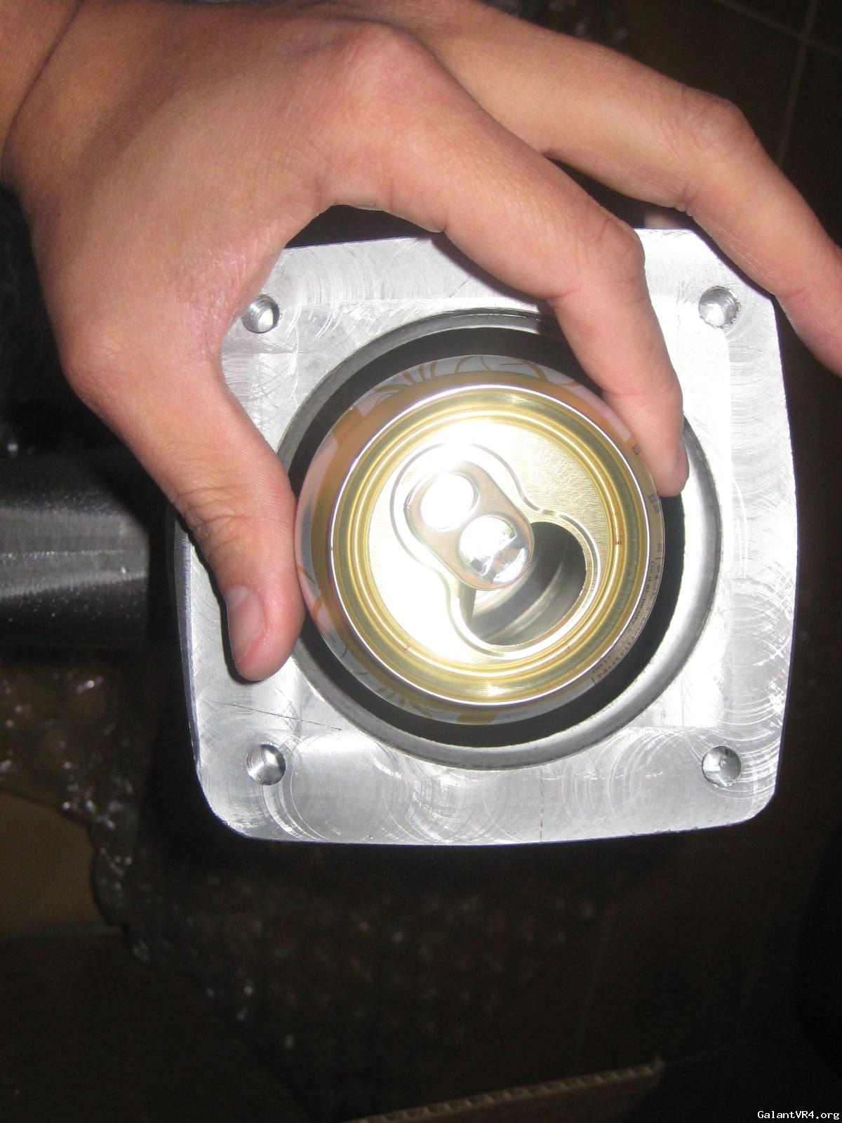

Their $41 t-shirt is a bit rich for my blood so the mani isn't going to happen, but yea it's a damn sexy cupholder.
