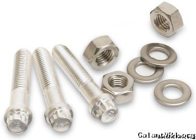

How about just using a long extension and/or flex extension with a conventional hex head, or is there not enough room between the extreme end of the hex and exhaust tube, for socket clearance? (maybe that's what you were talking about initially).

Aaah, OK well perhaps the socket screw is your best bet...they do make hex head screws with a slightly smaller head, but not really common...they use them a lot for headers, but those are usually 3/8-16 or 10 mm thread, iirc.

Look online for the 12-point screws I linked above also, as they have a smaller head and take a smaller OD socket and can endure lots of torque; need a 12 point socket of course, but those are common.
