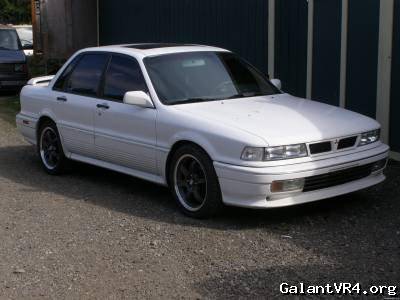

I had a set of B&G springs on 1813. They looked pretty good IMO: click

Quoting galantrevolution:
Does anybody have a picture of their car with the springs with out cutting them ?
I no longer have any before pics but this is with 1.5 coils cut out of rear.
