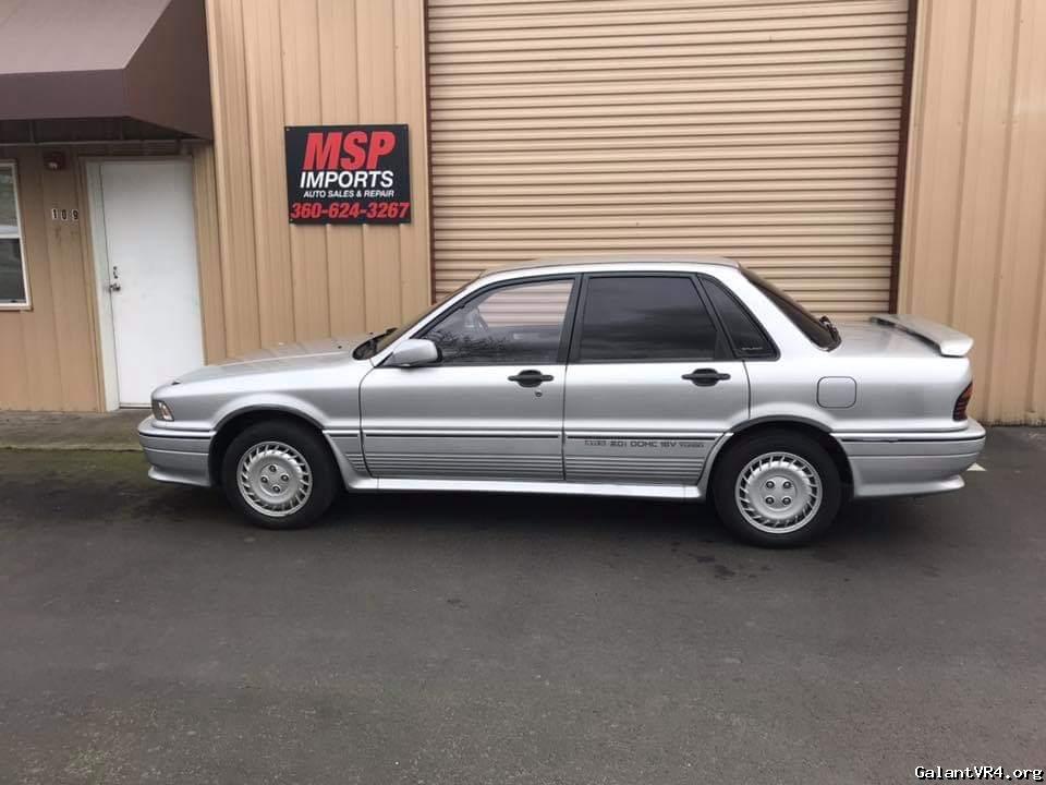

Just bought my first vr4!
Jdmgalantvr4
New member
May 27, 2019
1
Wayand, iowa
Hi just wanted to introduce myself. This is my first 89 galant vr4. I had it imorted from japan. Whats the best place for jdm parts for my car? Are most us and jdm parts for these cars interchangeable? Also does anyone know how to tell the production date? Thanks everyone! Hope i didnt overload you with questions on my first post haha

^^ you're thinking of the post mid-1990 Evolution spec facelift which actually came with a big 16G along with the 510cc injectors, larger intercooler, 3.909 4-bolt rear and close ratio transmission.
The one pictured above is the pre-facelift (early '89) which has the same 450cc blue top injectors, 14b turbo, 3.545 3-bolt rear end as the USDM G, but has the cyclone dual stage inlet manifold and comes with smaller single piston brakes.
