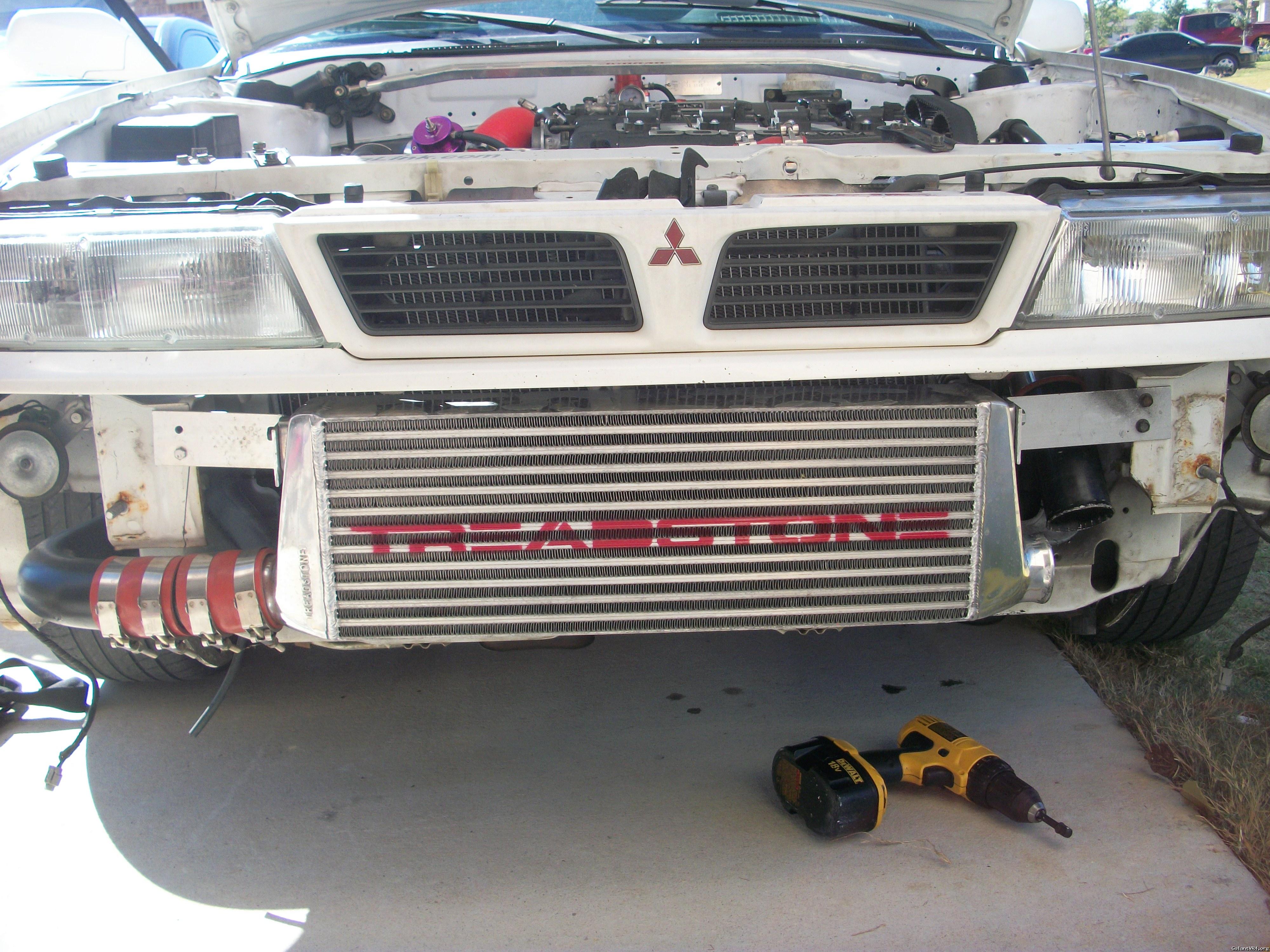

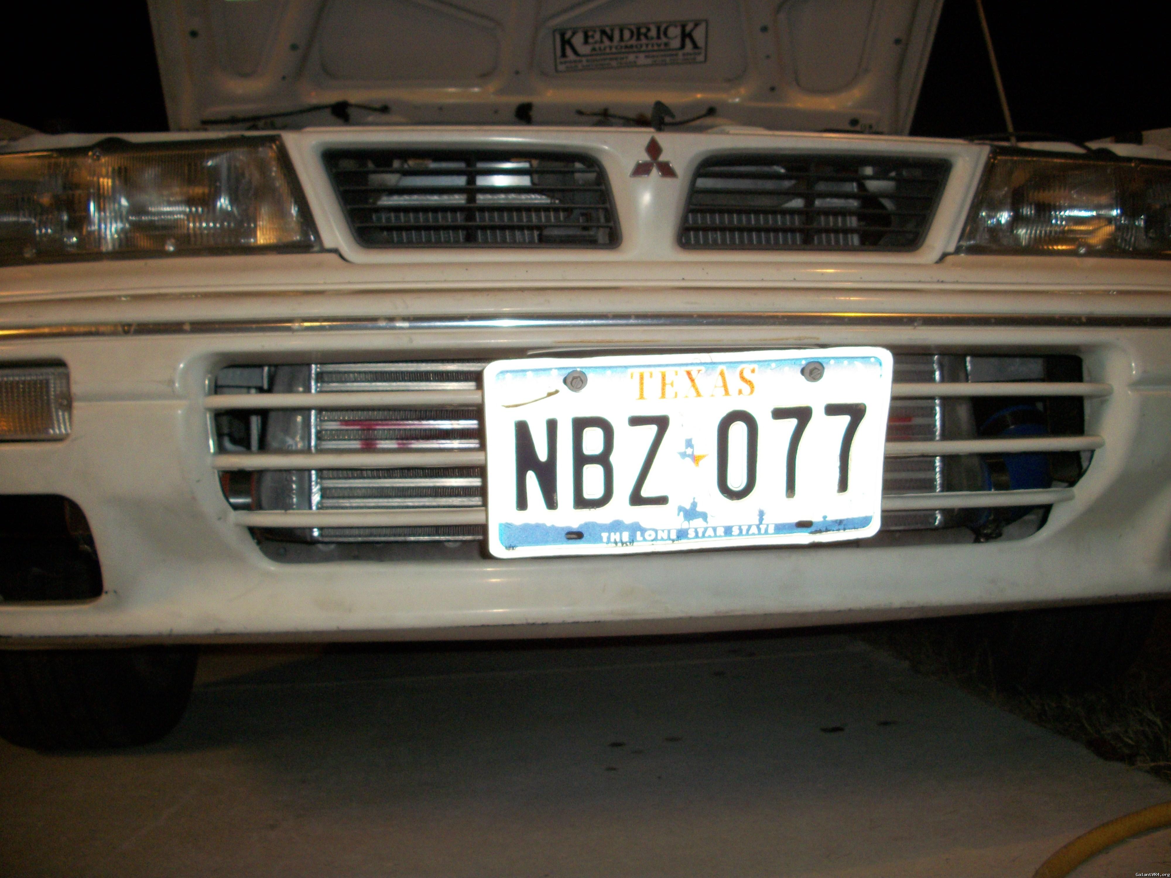

Broxma has an awesome one for sale, custom Bell Intercooler made for the Galant. I run a treadstone intercooler with custom pipes. It's a nice core, cast end tanks and the fin density is great.

Quoting vr4junkie:
Hey by any chance do you have the link or size of the tread stone intercooler they seem perrty nice and priced reasonable

Vr4junkie
Jun 25, 2011
596
Some wack town in CA
@ 524of1000 do you have any pics of your treadstone intercooler and which model did you get.....@ broxma I finally.checked out checked out you r intercooler that thing is awesome but a little off my budget
