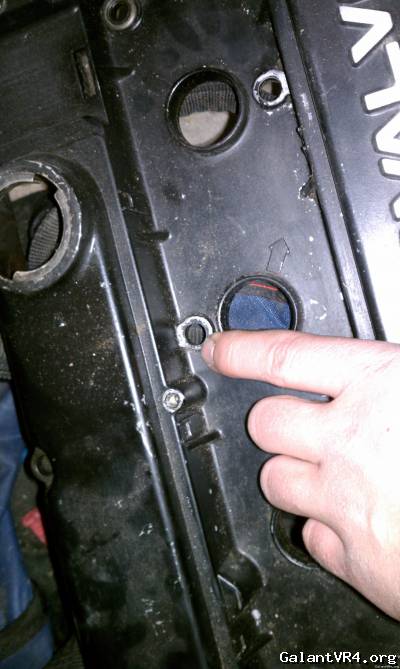

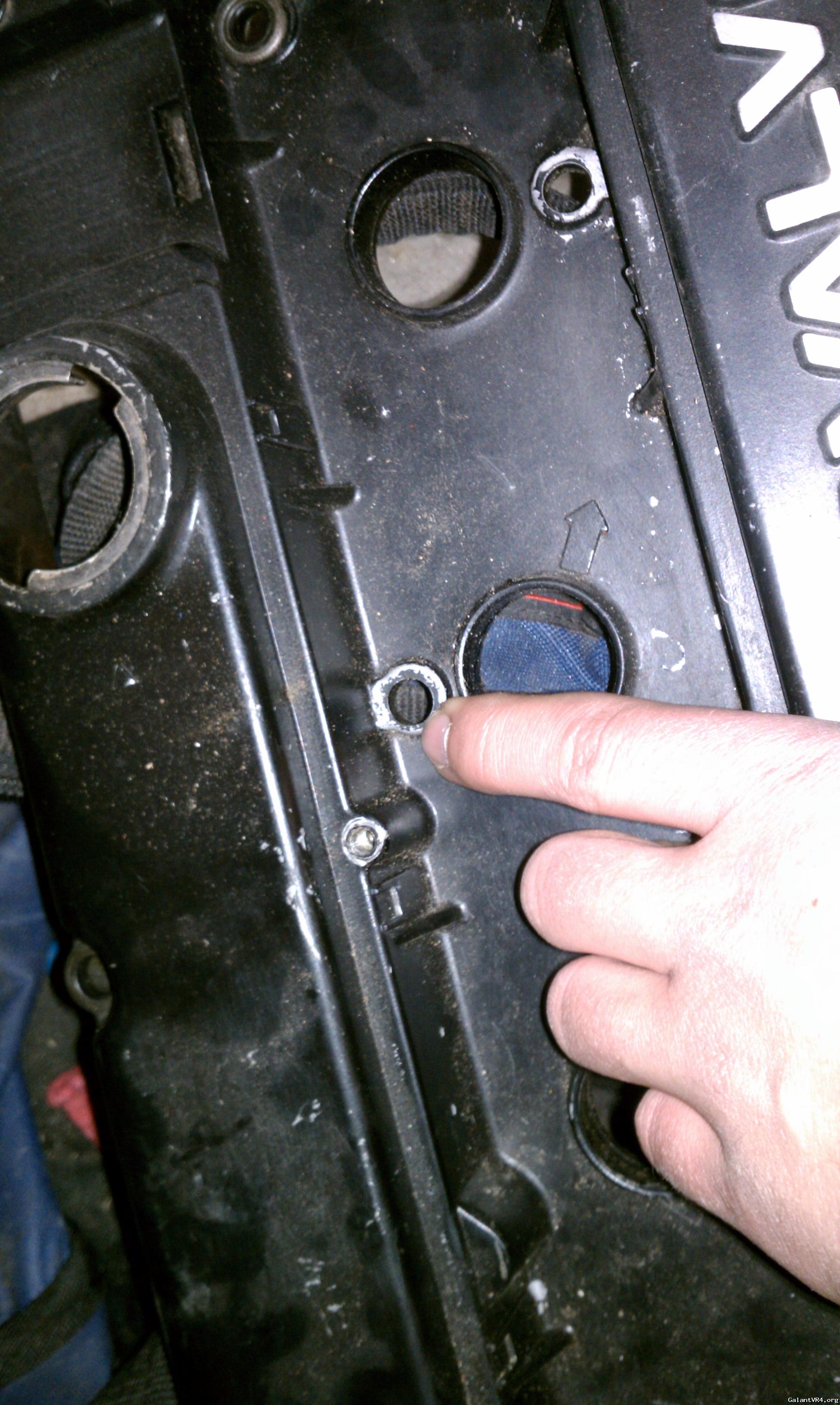

I just picked up a hyundai valve cover. I don't plan to use studs, nor do I think they're required? There are washers on the cover:
Do I need to have some washers on these bolts:
What size bolts should I use? What should I torque them to?

RTV should not be needed.
Hyundai used both a stud hardware kit & a bolt hardware kit.
The bolts are actually shouldered to fit in the oversized hole.
For a gasket you are to use the Hyundai one.
I would personally use either the studs or the bolts Hyundai uses. /ubbthreads/images/graemlins/dunno.gif

You will also need to clearance the v/c for the cas, I had access to a mill, but others here have done it with a sanding disc.
Edit: those are sealing washers to allow for the OE shouldered bolts to pass through the v/c. Leaks a plenty if you don't use those. If you get your new gasket from dealer, it will def come with those. If you need a Hyundai VIN, I have one, since dealership parts guys can't seem to do ANYTHING without one.....

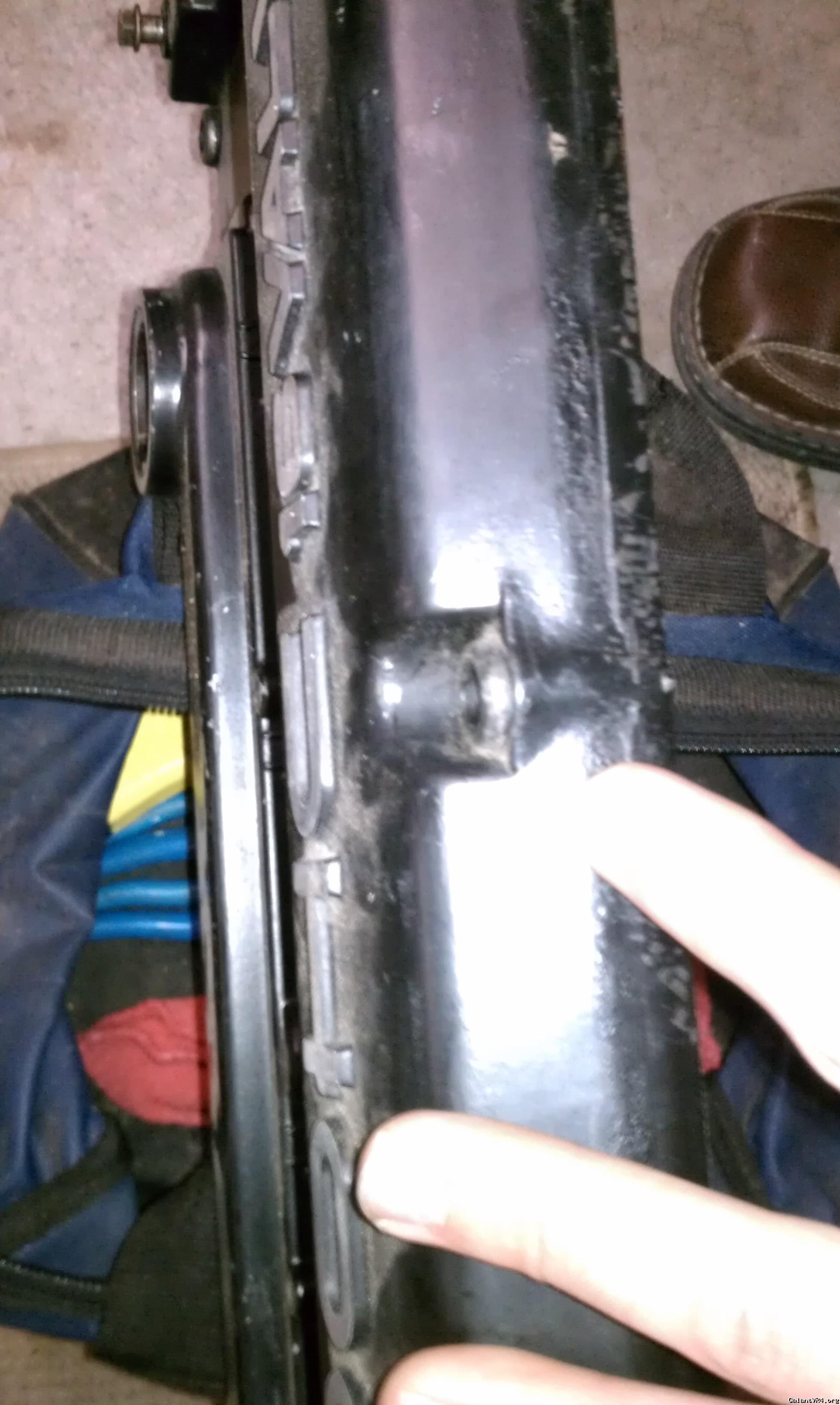

Just a touch, didn't even get into the gasket retaining groove. The clearance is needed up top as the valve cover is bulbous and the stocker is relatively flat.
And from my understanding they are less prone to cracking.
