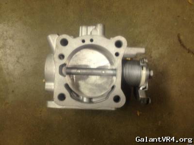

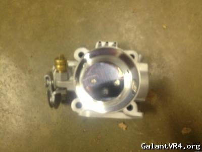

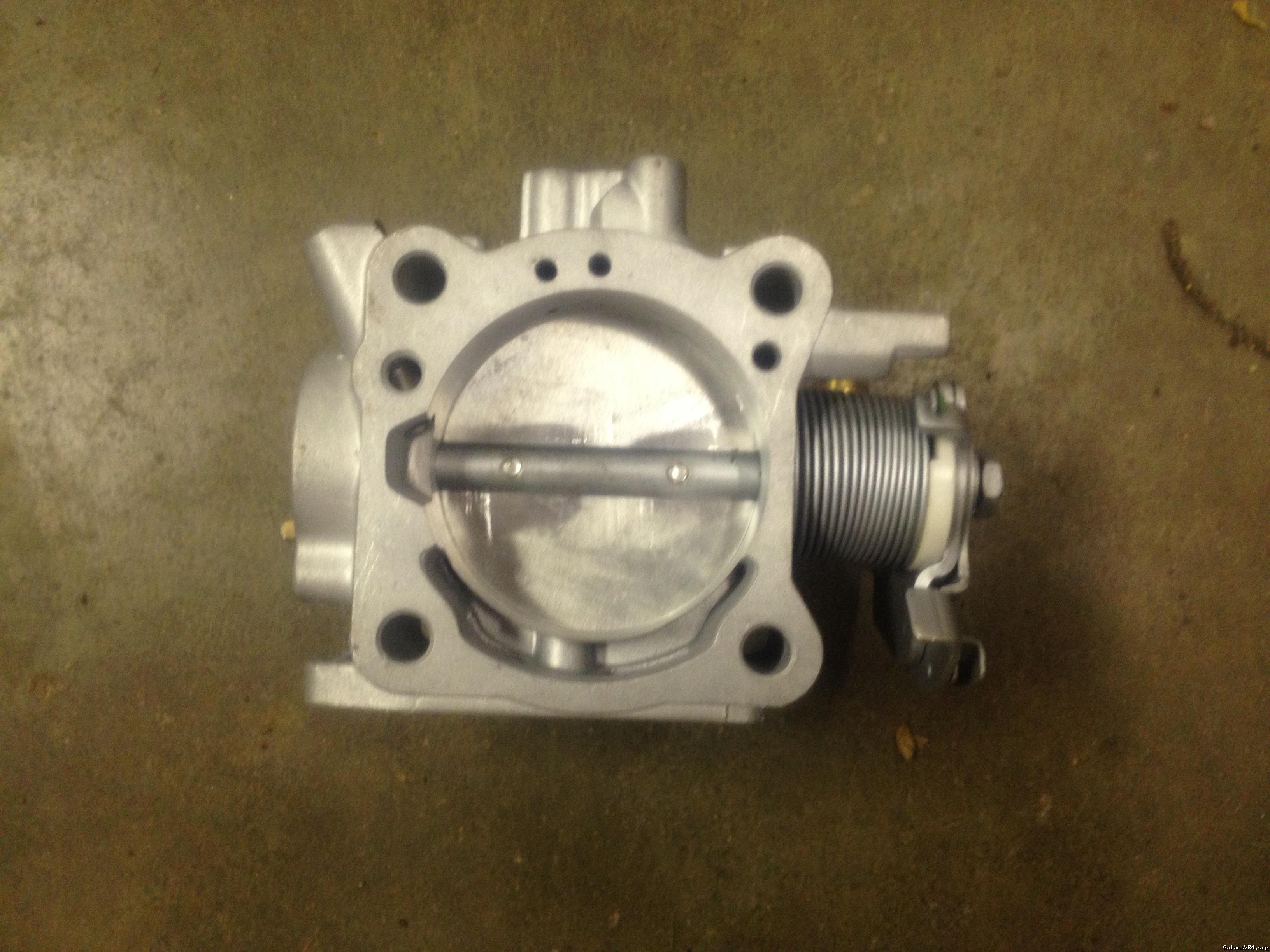

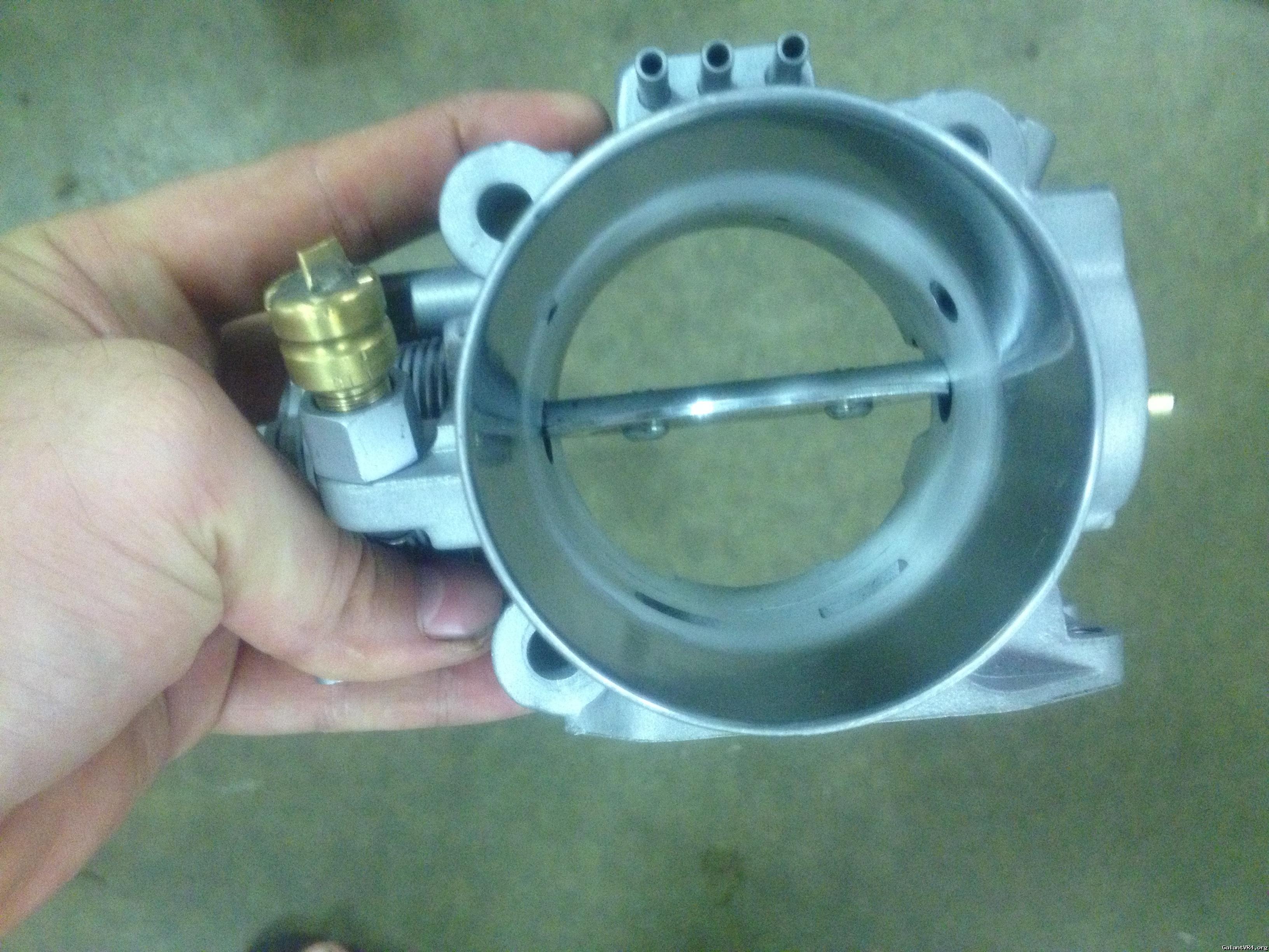

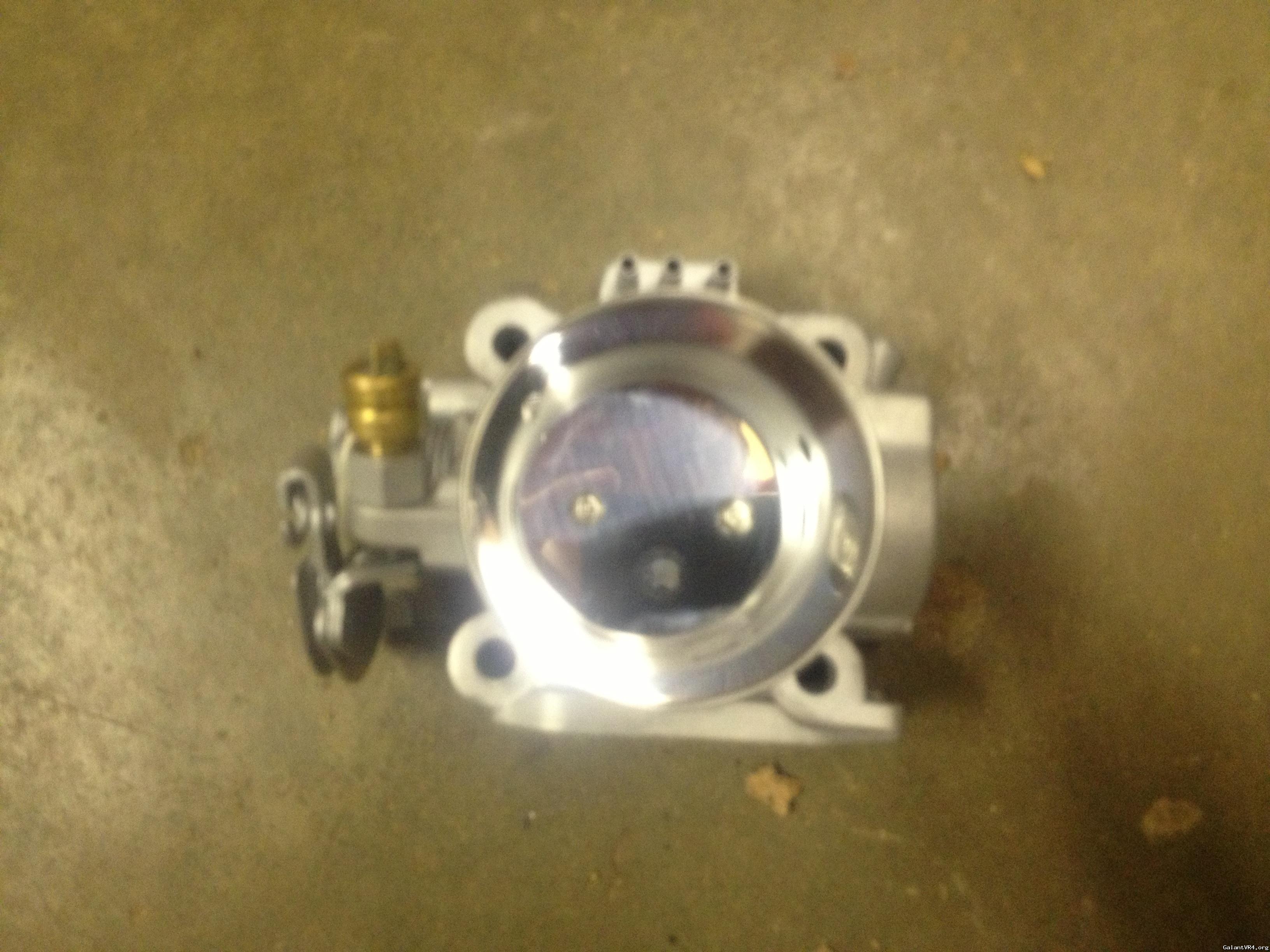

So here are some pics of the finished product. I am still confused about the whole Hyundai part. It looks like any 1g tb I have ever seen. He decided to tap the idle switch for free, and I guess he included one as well. Part of me feels like I was getting hustled, but who knows
I had a custom throttle plate made, and it was bored out
Here is a pic of the backside
Port and taper, along with a half shaft mod
Overall, I have mixed feelings about the transaction.
