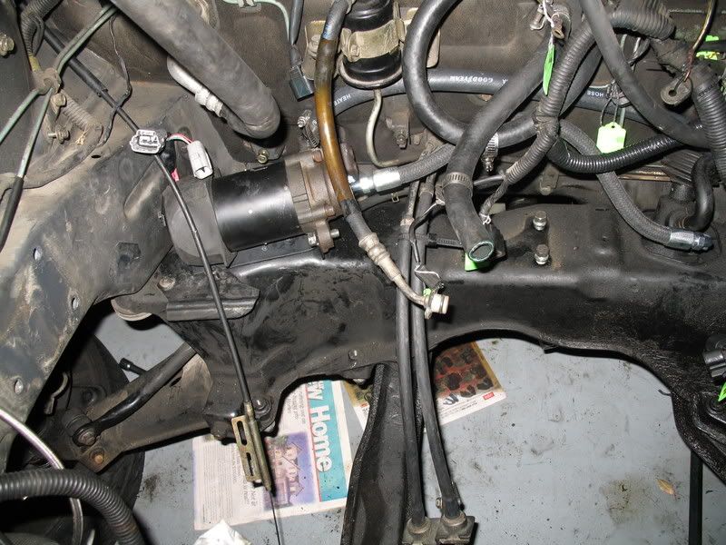

The electric PS pump in question was oem on the 2g mr2. A board member picked one up but I haven't heard if it's installed yet. IIRC the pump needs to be controlled via pulse width modulations, not voltage.
DailyDSM
Sep 6, 2005
433
Carlsbad, CA
The pump is installed. I posted this picture a few months ago before the engine was back in the car:
The car now runs but I haven't finished all the interior electrical so I haven't had a chance to drive it yet. The only difference from what is pictured is I ran a heavier duty feed hose from the stock reservior location.
