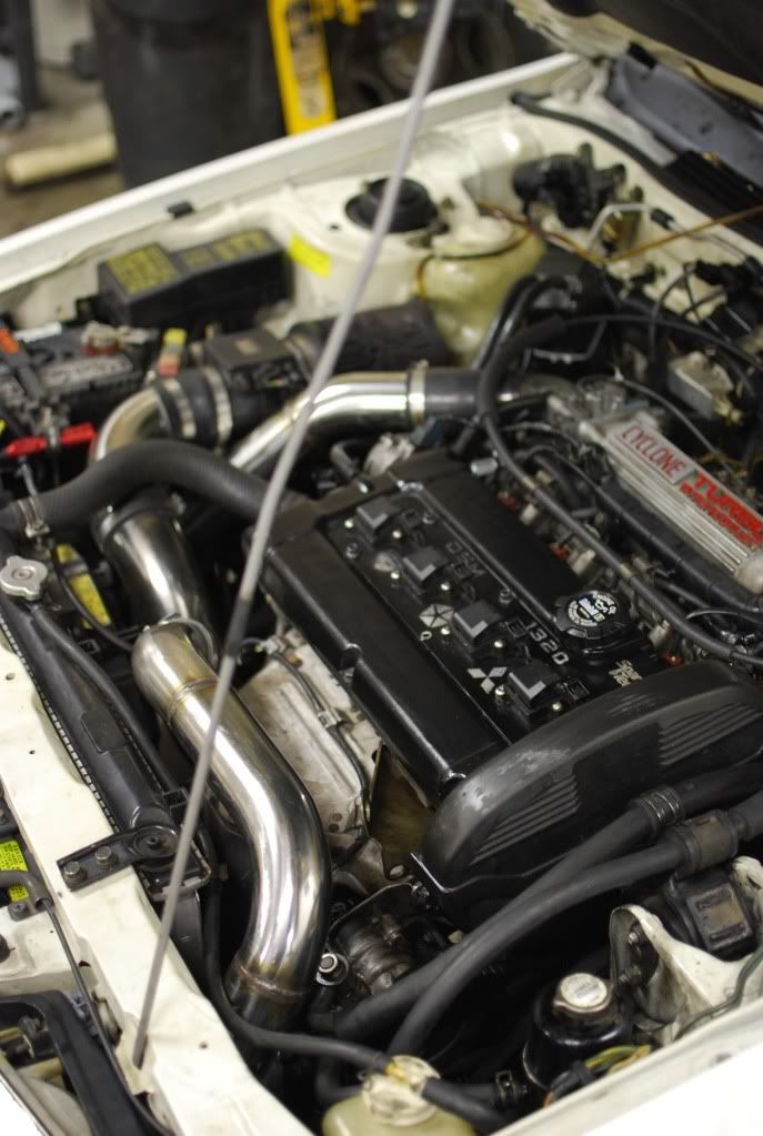

Quoting broxma:
Did you tilt shift that picture on purpose? /ubbthreads/images/graemlins/smile.gif
You'd be surprised what a quality ebay universal pipe kit and a friend with a TIG welder can do.
/brox
My buddy took the pic of the engine bay. Not sure what he was going after but I like the quality of SS piping since it is strong. I havnt had good luck with eBay piping as when people use t bolt clamps it ovals/ smashes the pipes causing boost leaks. That would be the only reason I would not recommend eBay but it seems like others have had good luck.

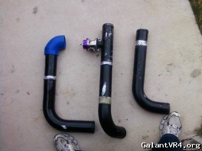

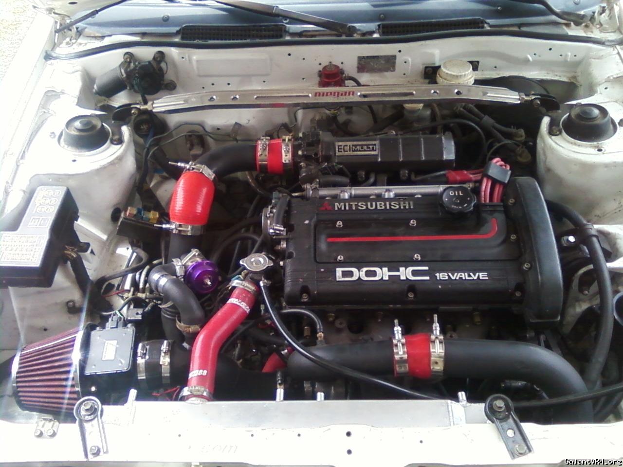

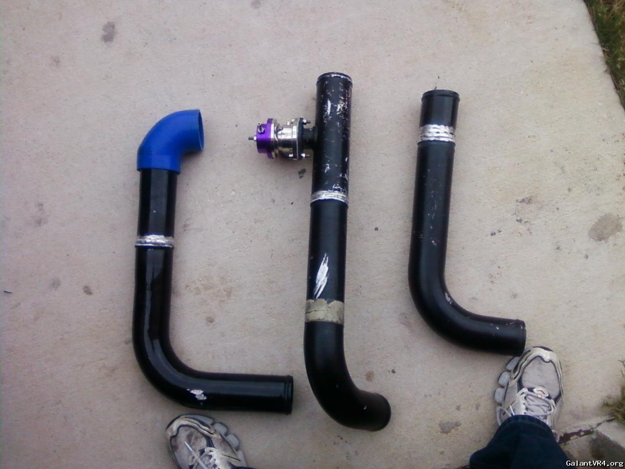

Like I said above, I bought the Ebay pipe kit. The thickness of the pipe was better than expected and they never crushed with t-bolt clamps. I pieced it together, trimmed where needed and held it together with the shitty couplers and t-bolt clamps. Once I was happy with the route, I took it to a friend who TIG welded it together and now I have these:
of course I re-painted them after. Even the welder commented on the general quality of the pipes. And this is how it looked with my 16g set up. It's a little different now that I'm running a big turbo...
