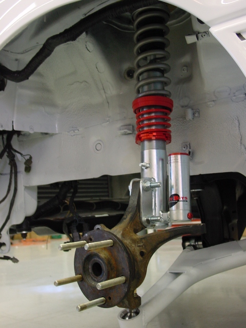

Anybody have pictures of these installed in the car without the wheel on? Installing a set right now and wondering about the front set. When you install the front ones with the external reservoir, do you put the reservoir toward the front of the car or the rear of the car?

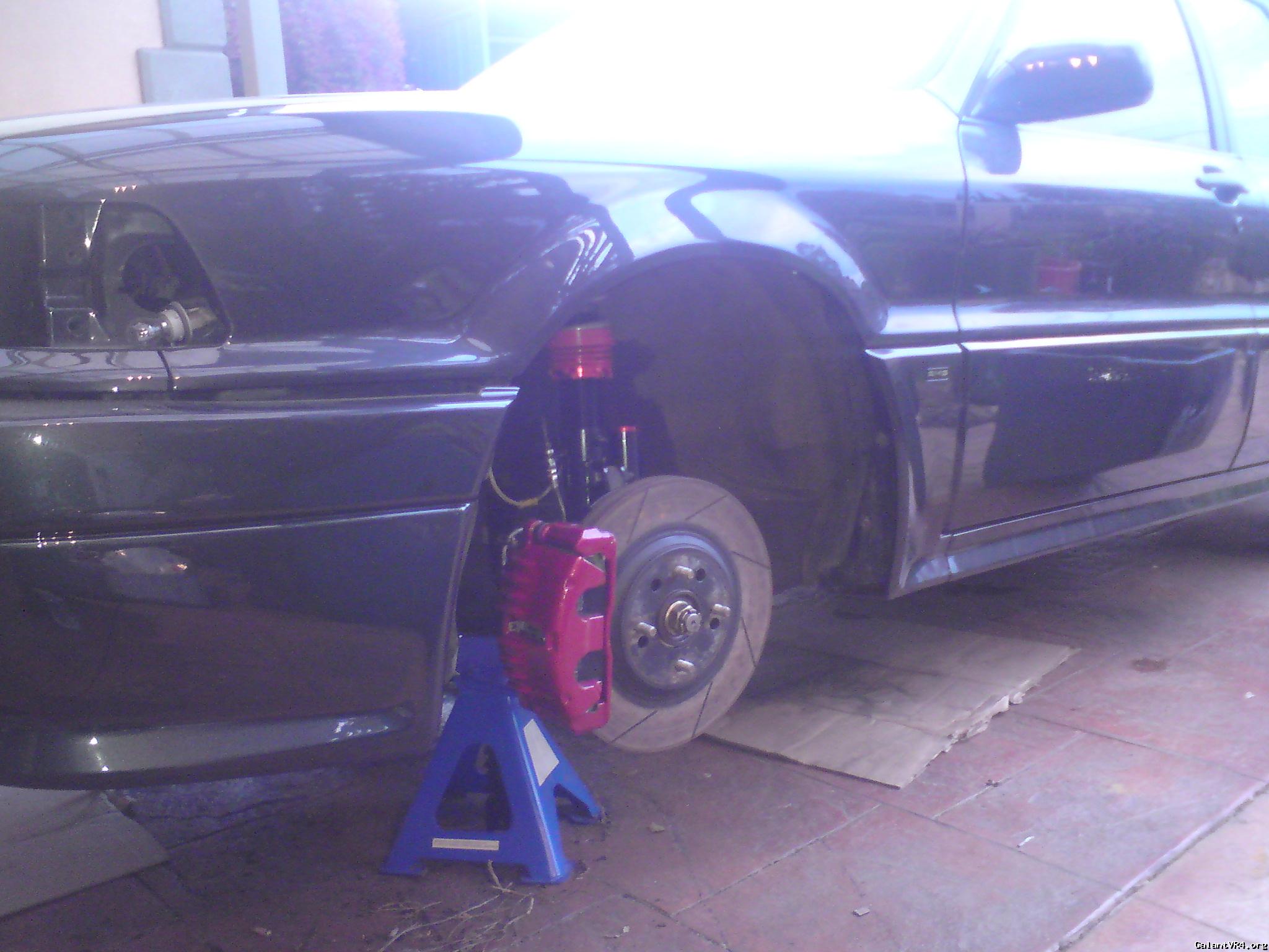

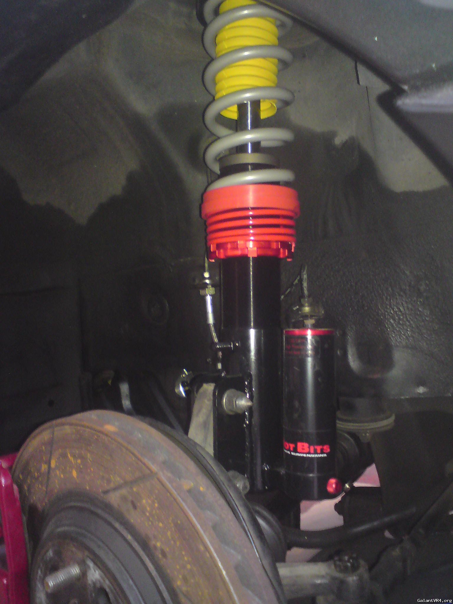

I have done mine to the rear.
Mine has the brake bracket on both sides of the strut (1 hole with thread and the other side has a stud).
I use the hole and thread to hold my brake lines up.
Clearance is ok this way also.
Never tried to mount them with the cans facing the front.

So I finally mount them with the external reservoir towards the rear of the car as well.
I was afraid that mounting it towards the rear would get the reservoir pinched when you are at full lock but verified last night that it is ok to mount it that way. The other thing is having to do as well with the camber plate attached on top. Mounting it on the wrong side would also limit the amount of negative camber that can be dialed in since the adjustable bottom plate of the camber plate assembly is actually cut flat on one side to allow for more travel before the edge of it hits the inner strut mounting bolt.
The hotbits assembly looks great and well build.
