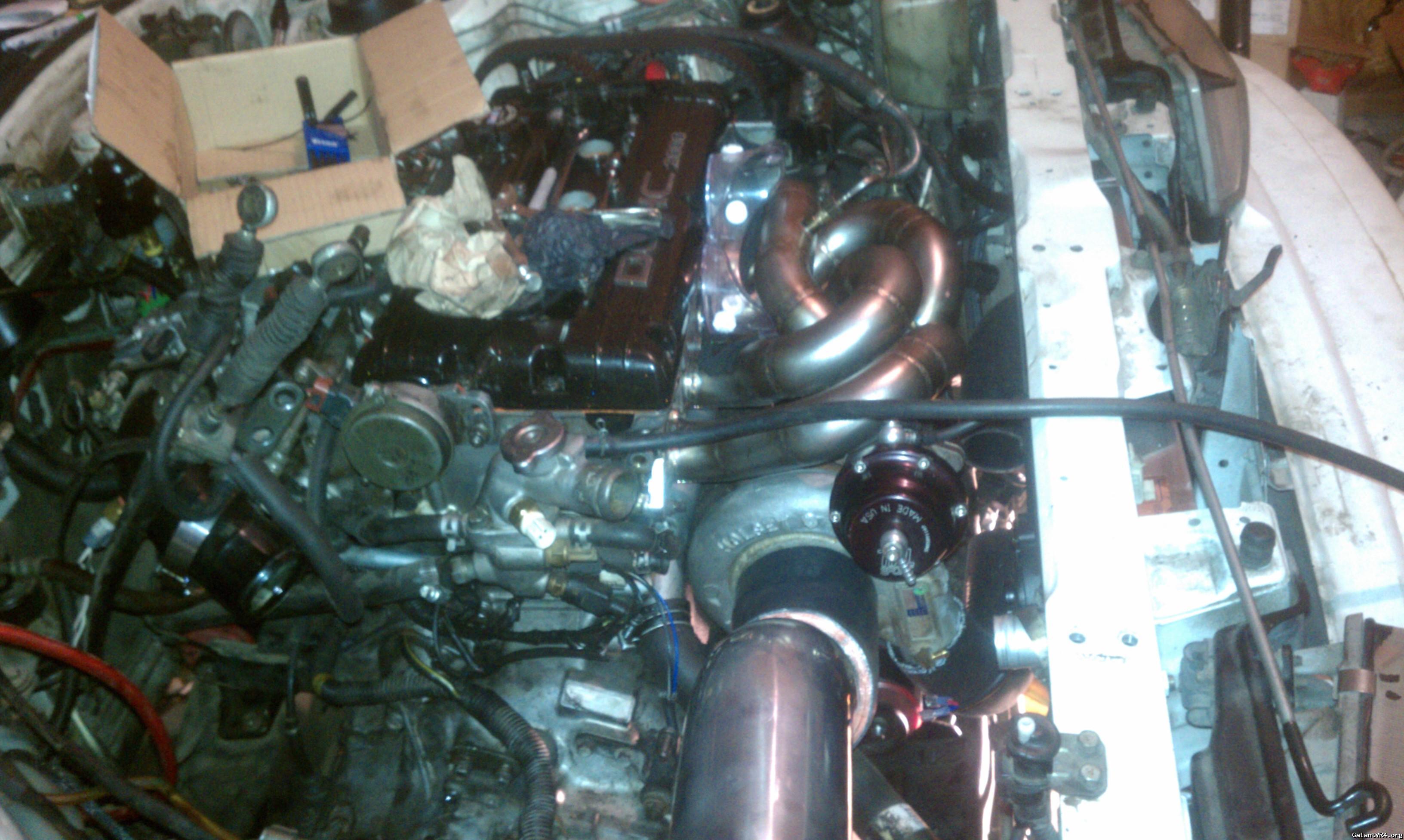

thats not bad. i think i might just stick with my hx though and switch to a twin scroll setup with an upgraded 9blade compressor wheel. i also found the exhaust housing that i wanted for it.. now its just time and money.

If you do go twin scroll post some pics up havent seen any Vr4s with a twin scroll HX35 yet I was planning on doing that but those mainfolds are expensive .

Quoting Vr4junkie:
You haven't searched very hard.

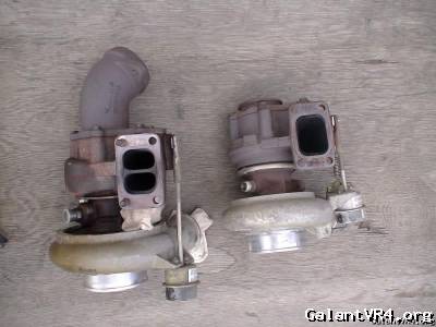

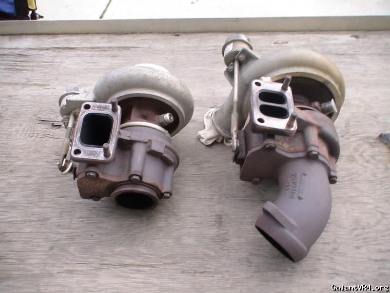

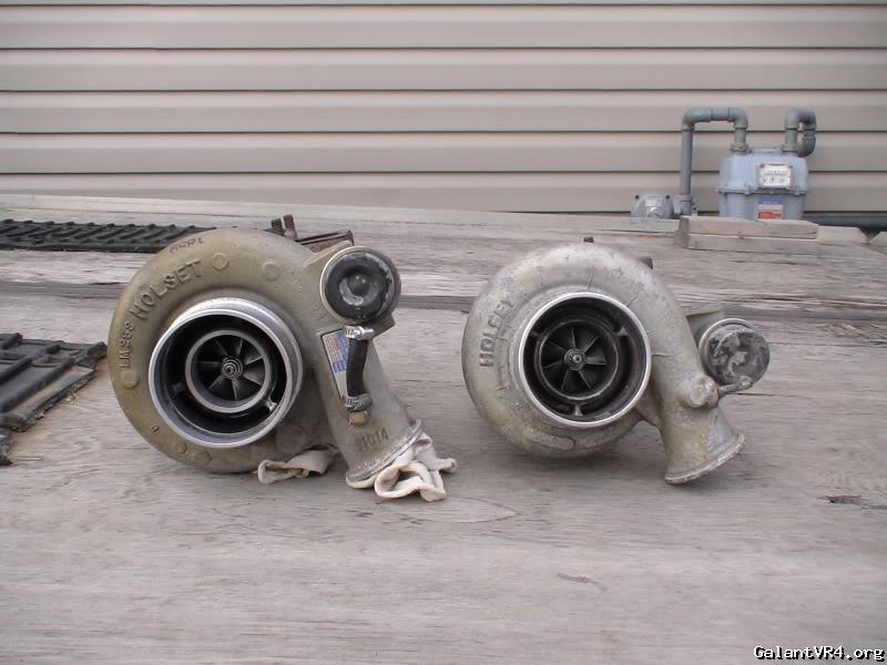

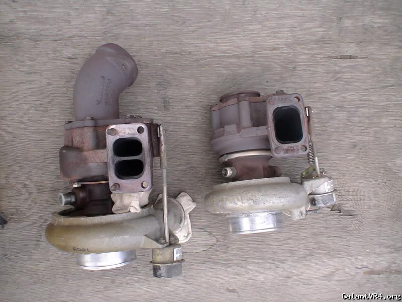

Lucaslutain I think the HY35 would spool a little faster than the HX35 in a T3 housing since it has a smaller housing .63 vs .70 Plus the HY35 could be had cheap I bought mine for 130 shipped a T3 BEP housing is 229 from Extremepsi if your not looking for crazy numbers I think the HY35 might be a good alternative.
HX HY
HY HX
