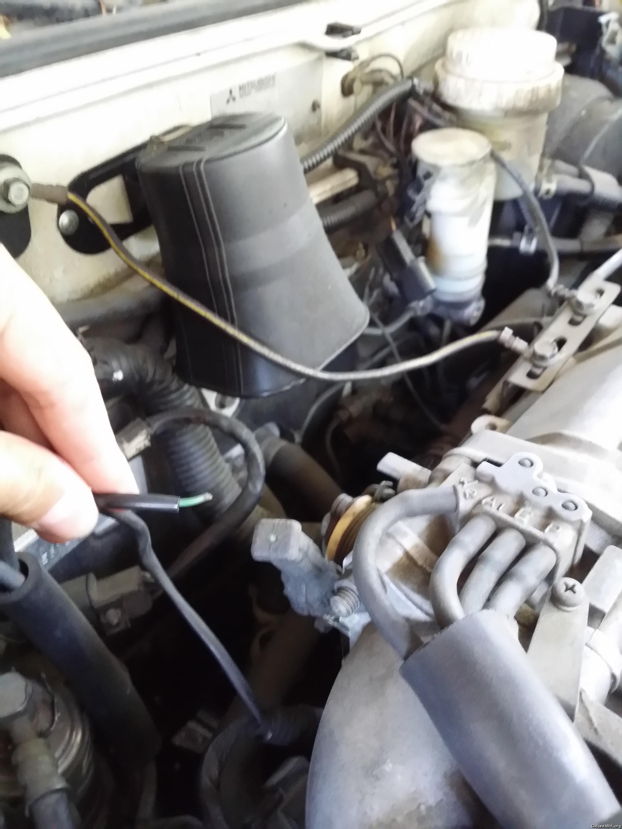

Mine will do that if I accidentally knock the idle stop switch wire off.

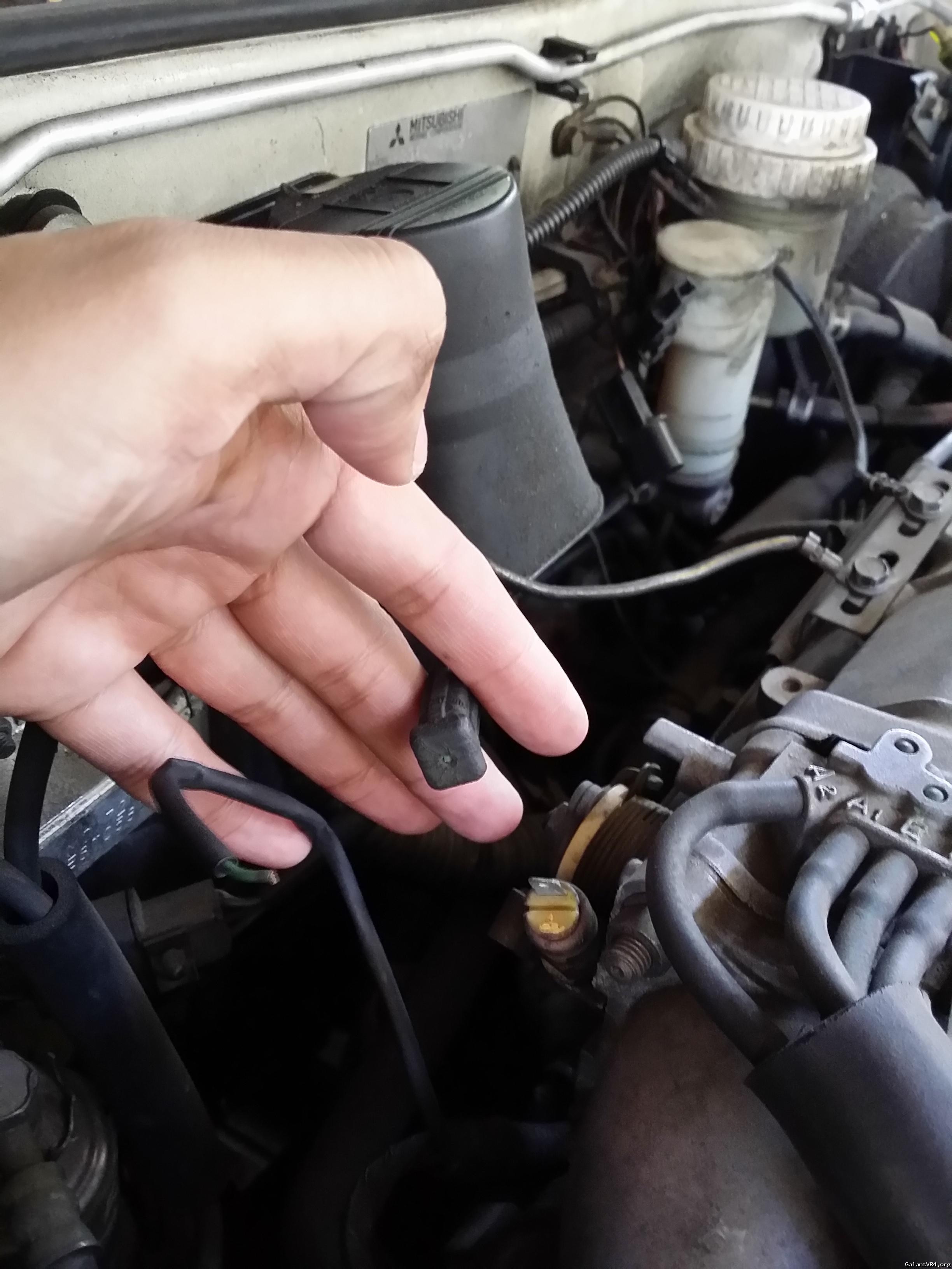

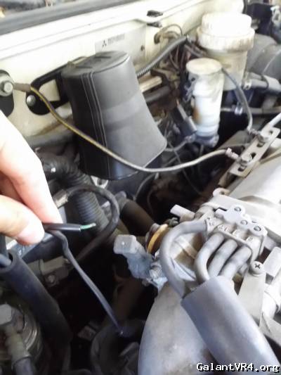

No vacuum hoses knocked up, but here is the idle stop switch (i assume this is it lol), but the wire had actually been knocked off for a while, here are a couple pics of it.

Check the throttle cable, make sure the throttle isn't getting stuck open, you might have moved the cable and got it stuck.
