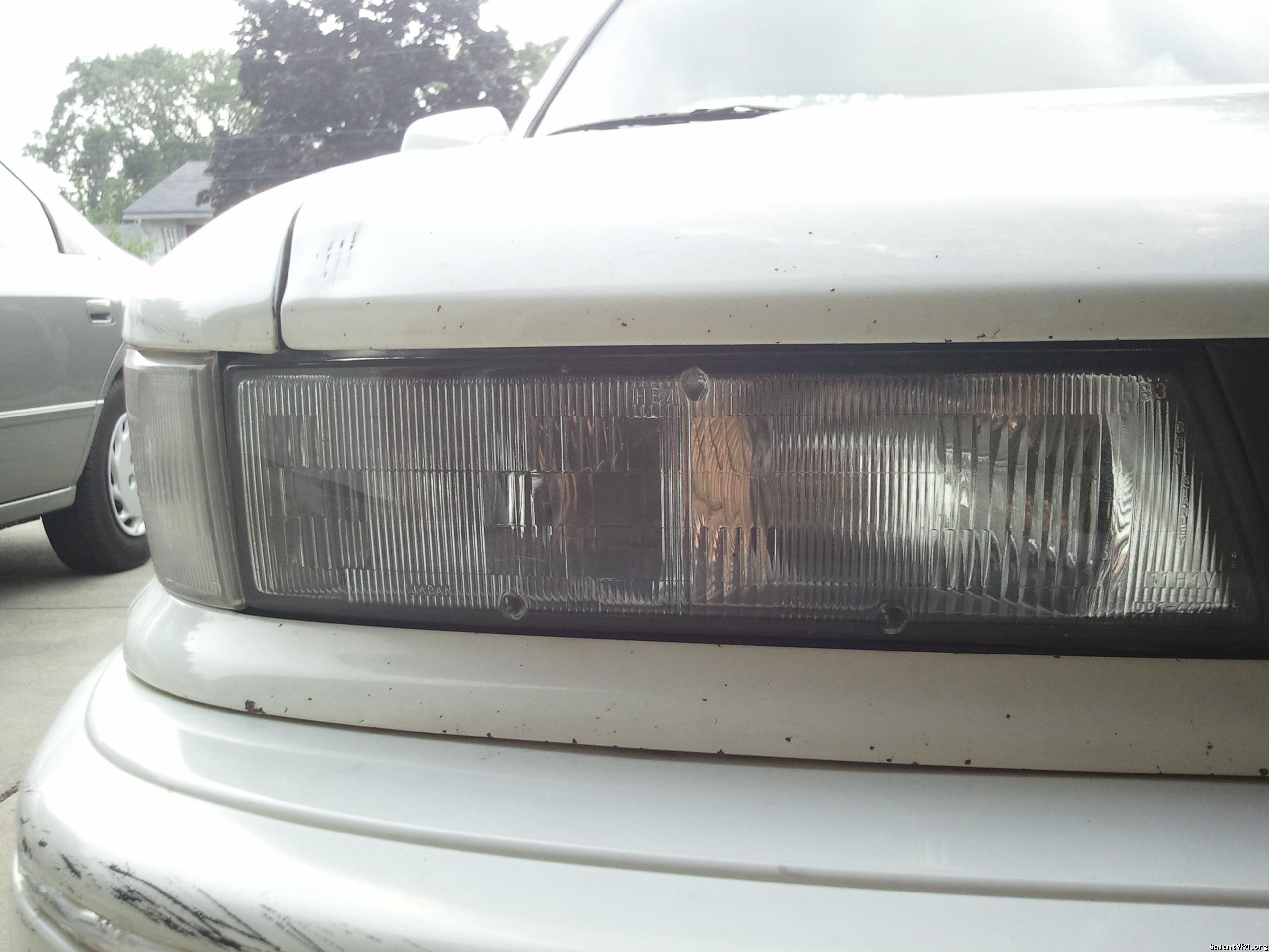

I looked up on autozone for new bulbs and it says I need 9006 type bulbs, but when I look on my headlight housing itself, the low-beams say H4 and highs say H3..??
Im confused, can anyone clear this up for me?

does it say H4 and H3, or HB4 and HB3? If its HB4/3 then thats 9006/9005 for Low/High beams

yeah those are regular USDM heads, 9006 (low), 9005 (high) are the bulbs, what u saw was HB4/HB3 which corresponds to 9006/9005
