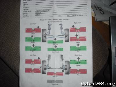

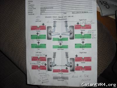

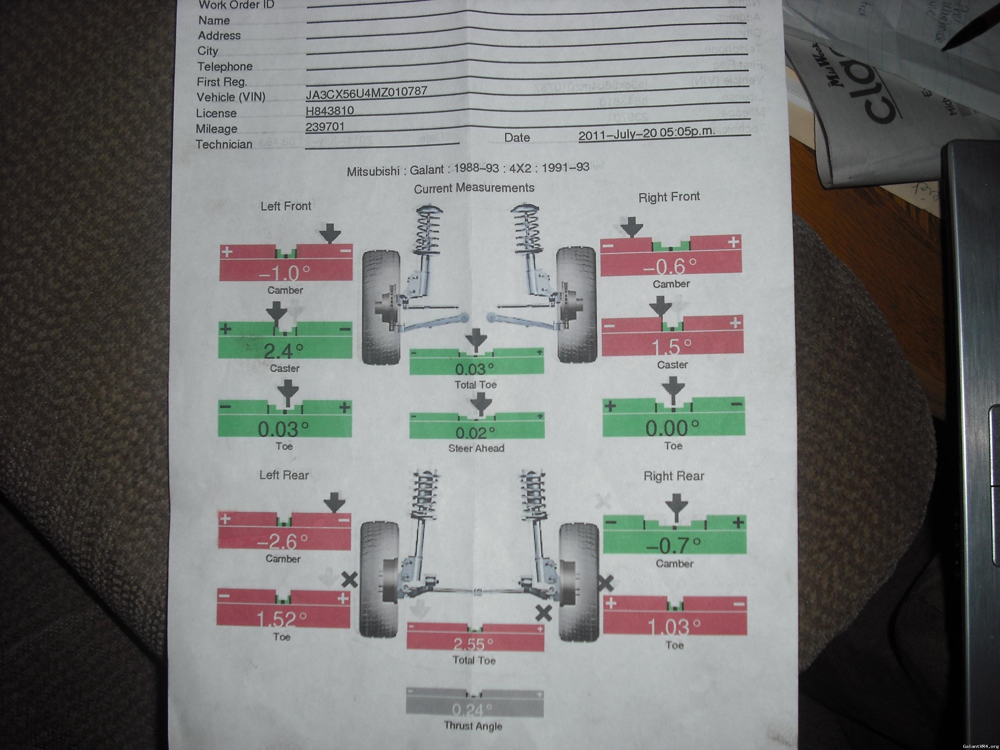

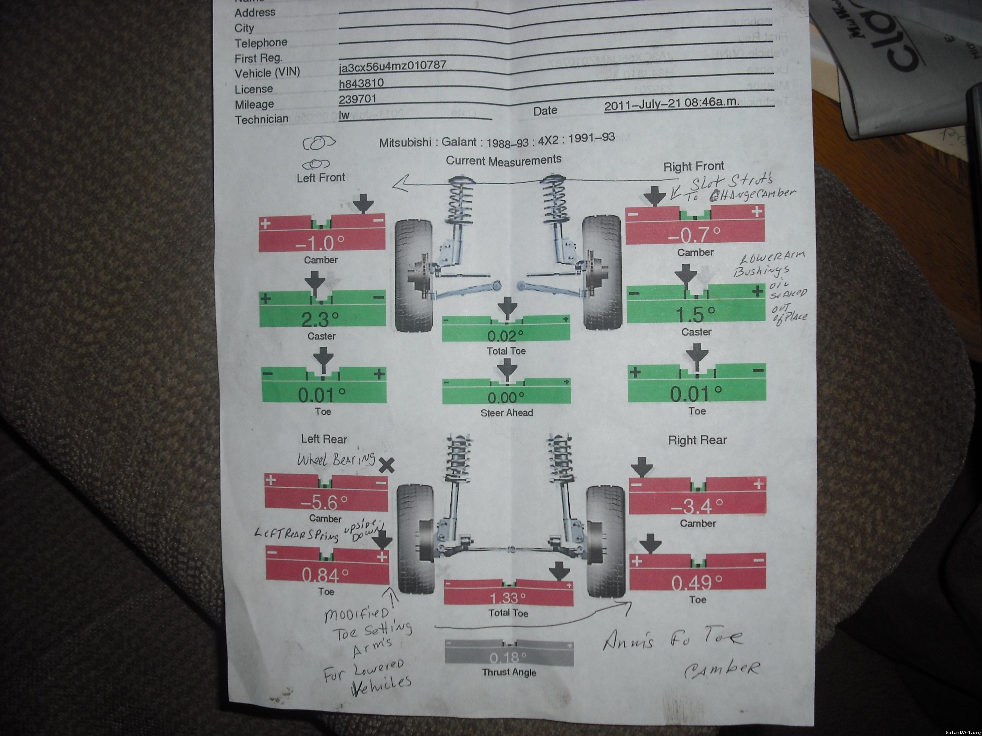

i tried doing an alighment today and this is the best i caould get it
before
after
when i got home i checked the rear camber and there both fucked up again and way off /ubbthreads/images/graemlins/banghead.gif /ubbthreads/images/graemlins/banghead.gif /ubbthreads/images/graemlins/banghead.gif /ubbthreads/images/graemlins/banghead.gif /ubbthreads/images/graemlins/banghead.gif

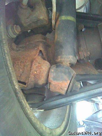

Also check your trailing arm shock mounts for anything like this...This is bad, very, very bad.

actually the upper arm is the camber adjustment & trailing arm adjusts for toe. Now if it's as messed up as the pic you posted the trailing arm could cause a camber issue.
