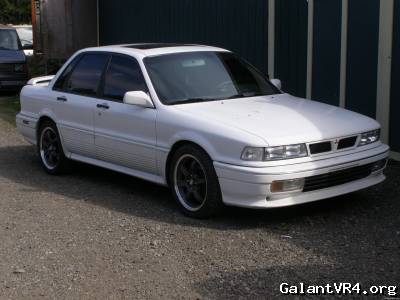

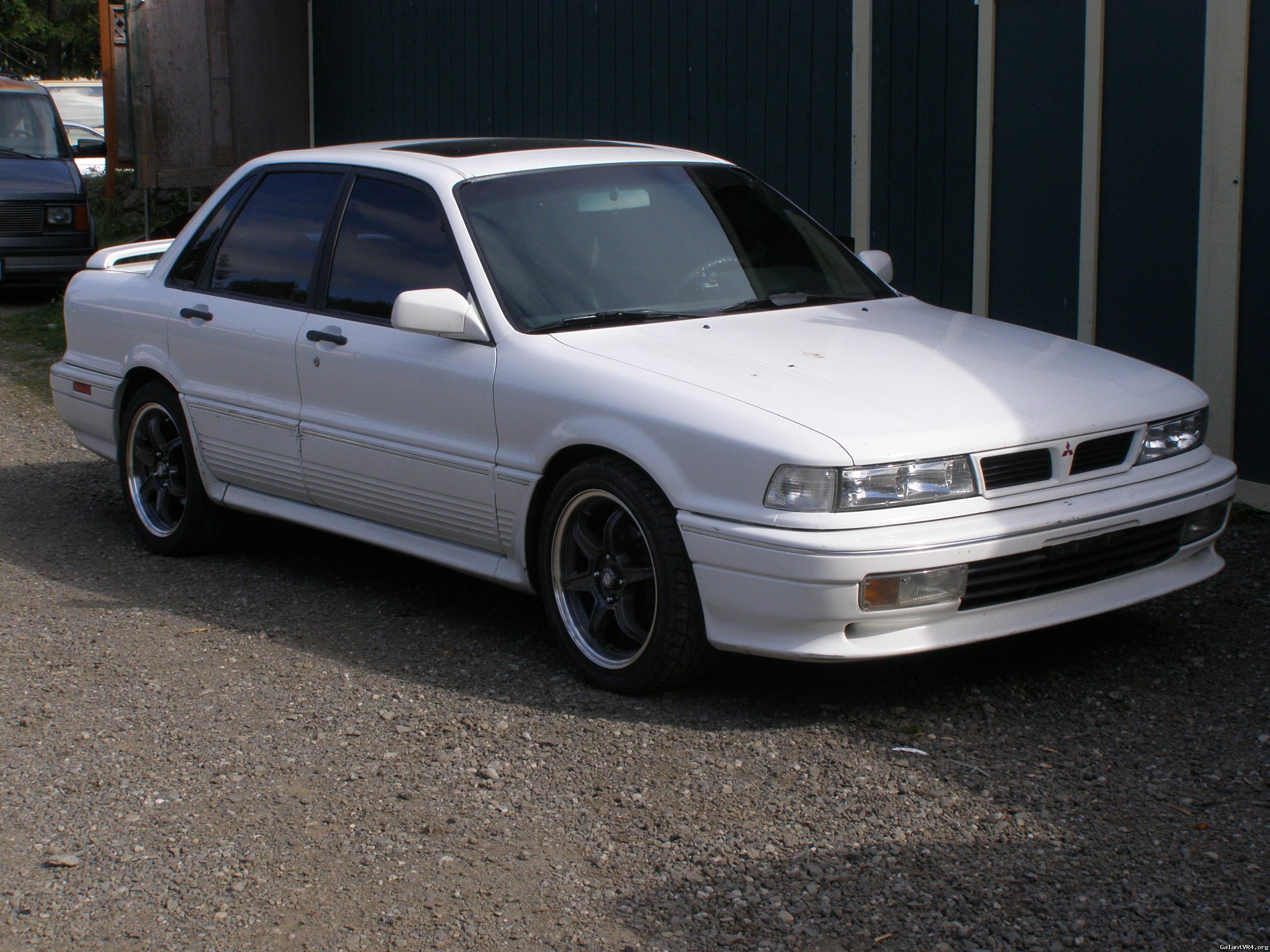

Unless H&R changed the rear springs? Can those of you with the uncut and cut springs post a part number if possible? I know the H&R's that are on 802 are cut per prev owner and the ones on 611 who knows but I remember there being a bit of difference in how many coils. I will have to check next time I work on my buddies now 611
thats what im running and the rear definitely sits higher then the front. as for ride. i like em.

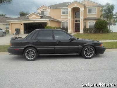

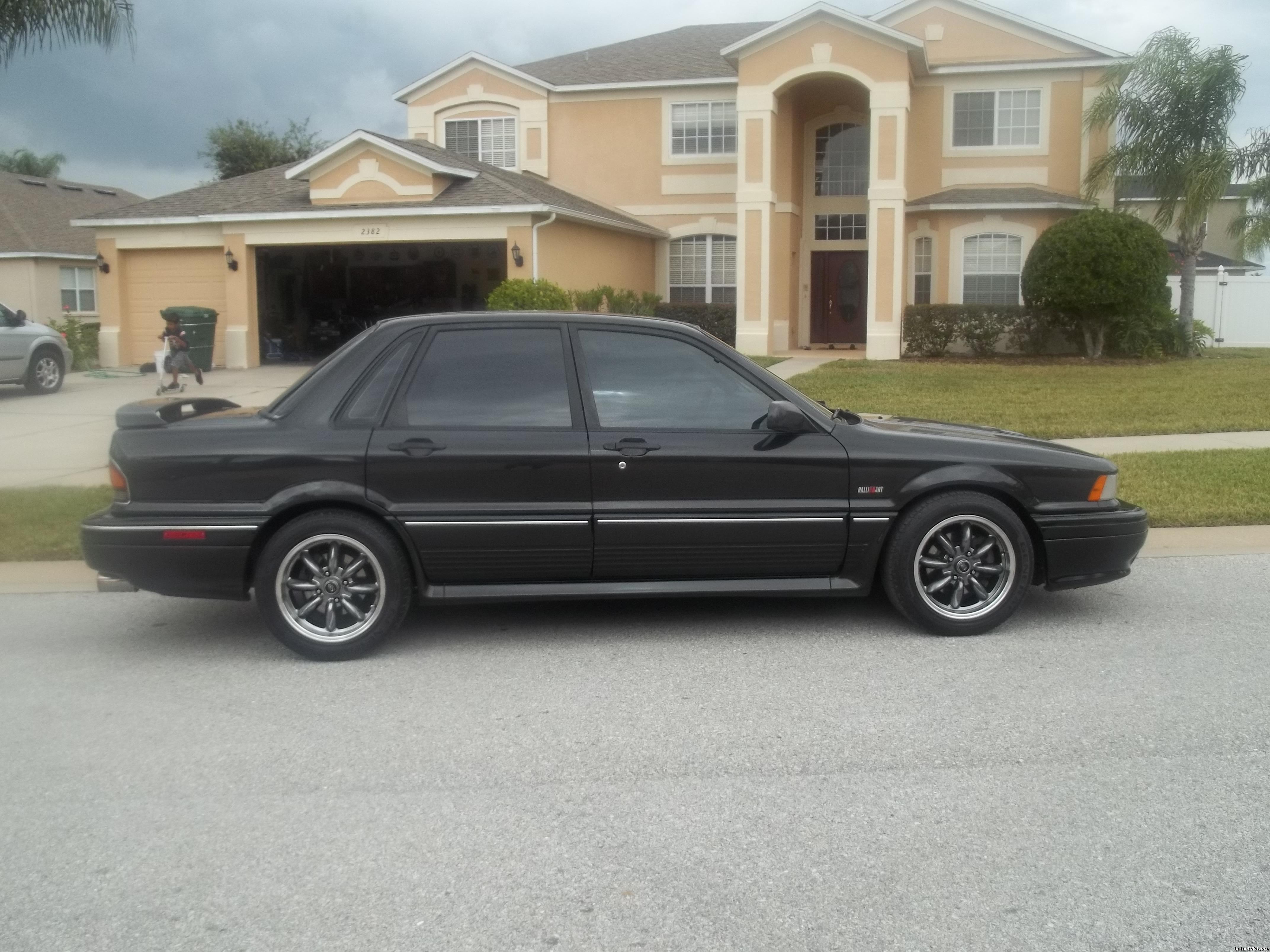

I had to cut one coil on my H&R's in the rear it was way to jacked up before . It sits like this now
dmj
Feb 2, 2008
673
orlando FL
I am running KYB GR2 struts front and rear. Ride is extremely smooth almost like a luxury car a little too soft for my taste though.
