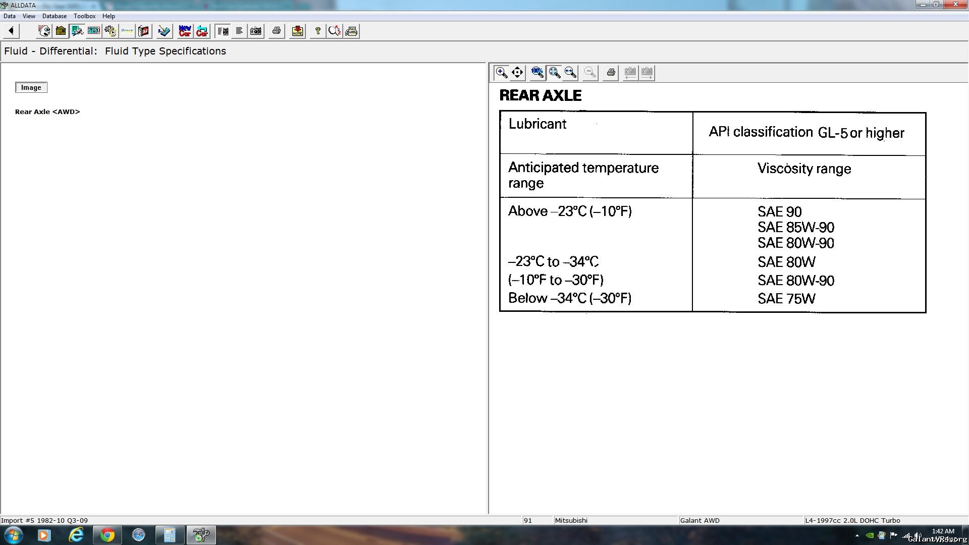

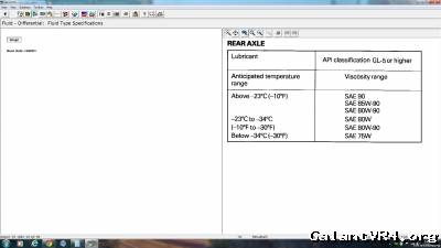

I'm on Summit now looking at RedLine I was going to put 75W90 in the T-Case and Trans GL-4 just because the manual and All-Data say so. I'm just confused on the rear end All-Data and the Manual say to use SAE 80W-90 to straight 90W for temps above -10 degrees RedLine only comes in 75-90 for ShockProof, another thing I'm a little confused on will I also need to buy the friction modifier for the rearend because I don't think it's premixed in.
