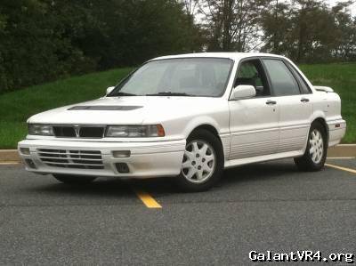

I was in a similar situation, and decided to try a set of B&G springs, and am glad I did. The ride wasn't great IMO, but for springs alone they performed as well as anything else I have had over the years. Although the ride was just OK, the stance looked great compared to other spring setups I've seen on VR4s. I was using the B&G springs with KYB AGX struts. The rear wheels are a bit tucked in the pics, but I had plans to install 5mm H&R spacers to bring all 4 corners flush. The car sat level, and handled pretty well.
