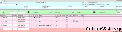

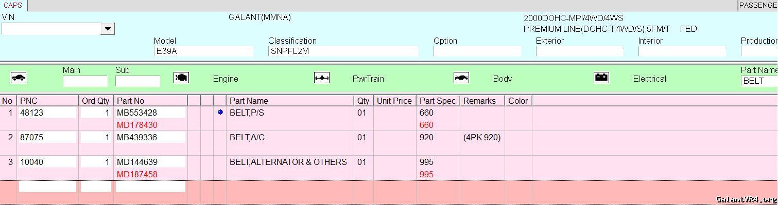

GVR4 specification for belts per ASA:
AC to CK = MB439336 = 920mm effective length 4PK920
ALT to WP to CK = MD187458 = 995mm effective length
PS to WP = MD178430 = 660mm effective length
