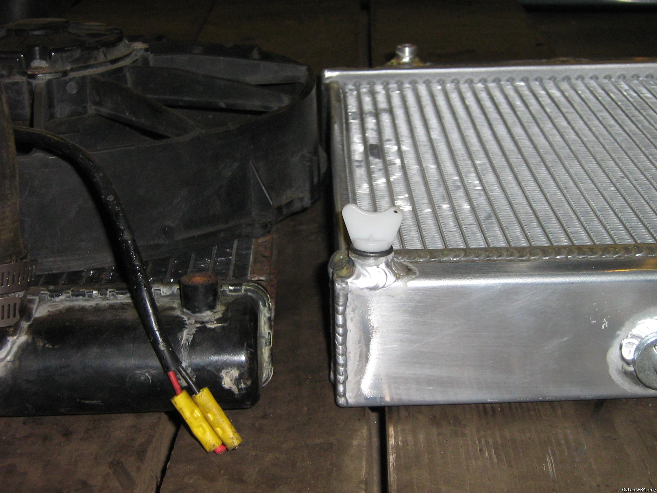

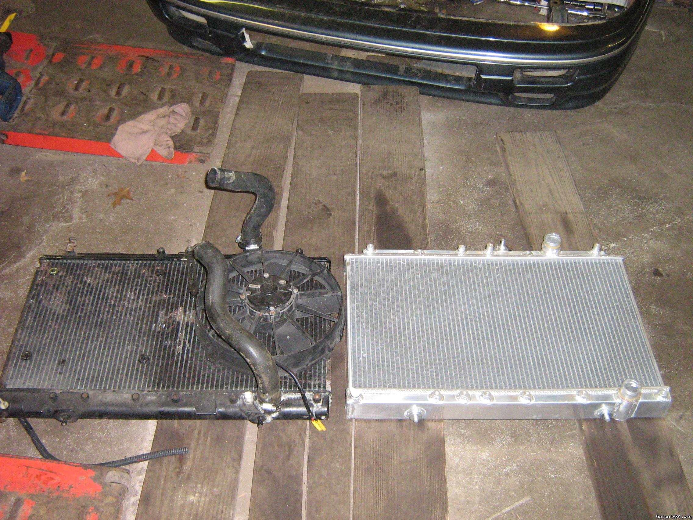

I have an evo III radiator in my GVR4. I made spacers to go at the bottom and welded in a bung for the temp sensor and that's all I had to do. Here are a couple pics of the Evo III next to a stock one.

+1, I did the same. I even have the odd sized tap I could look up for anyone that needs it. I just made spacers on the bottom by turning some delrin on the lathe.
